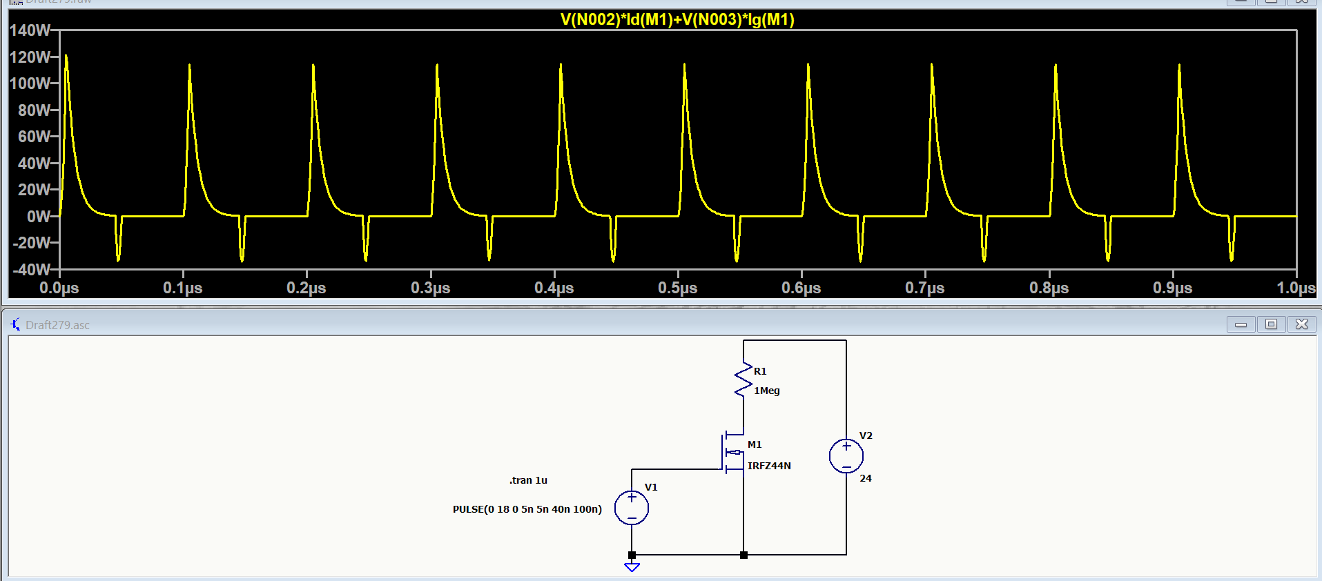

For the IRFZ44N at 10MHz, LTspice calculates the gate drive energy power as about 115W positive peak (turn on), -33W negative peak (turn off), 8.5W average, The values vary somewhat with duty cycle.
For the IRFZ44N at 10MHz, LTspice calculates the gate drive energy as about 115W positive peak (turn on), -33W negative peak (turn off), 8.5W average, The values vary somewhat with duty cycle.

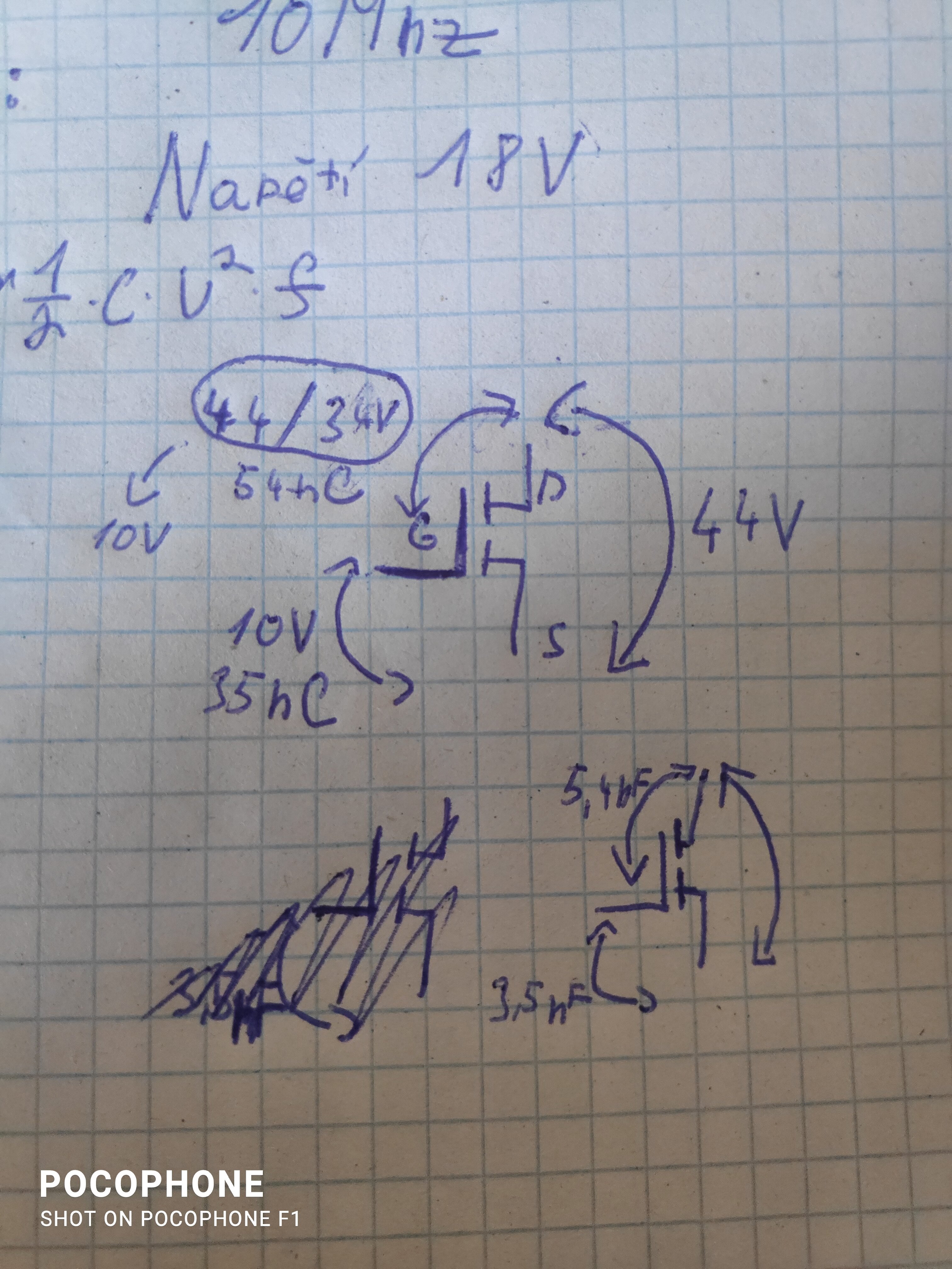

I tried to make model od mosfet .
Values Are from data sheet to irf3205.
Vgs 10v . Vds 44v . Qgs 35nC . Qgd 54nC
When Vgs Is 0V Cgd Is charged to 44v. When Vgs Is 10V Its discharged to 34V. So Cgd Is 5.4nF i Guess (energy Is supplied from Vds And discharged by gate driver)
Vgs 10V. Qgs 35nC.
So Cgs Is 3.5nF. Its charged by driver And discharged by driver.
I need to supply
10Mhz* 0.5 * 3.5*10n*18*18 = 5.67 J
Bingo
Can i ask how negative and average energy Is calculated?
I edited my previous post to replace 'energy' with 'power'. I don't know the details of LTspice's calculation methods. Here's the simulation showing how the FET power dissipation varies with time :-
