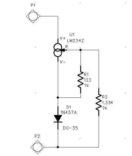

A third method would be to use the resistor under test *IN* the current source, sourcing this current across a highly precise known resistance and measuring the voltage drop across this resistor.

here is the schematic of a current source. make R1 the resistor under test. Supply a voltage to P1. Connect your precision resistor from P2 to ground. Measure voltage across precision resistor. See LM234 data sheet for setting up your current source for values of R1/R2.
