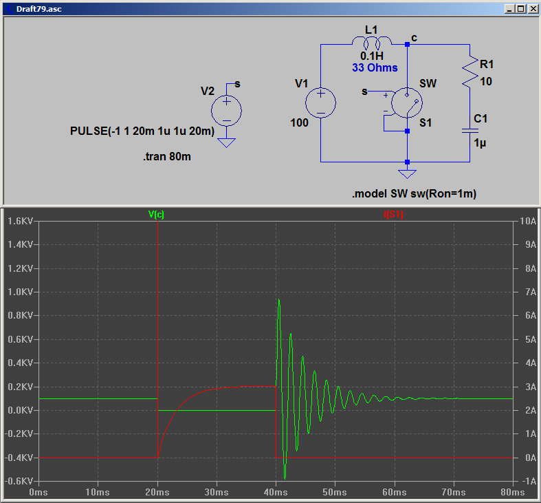

Look at this. Switch is open for 20ms, then it closes, and then opens again at 40ms.
The capacitor C1 charges to 100V, and it discharges through R1 (10A pulse) as the switch closes at 20ms. The resistor is chosen to keep that pulse within limits.
Just before 40ms, the inductor current is 3A. As the switch opens, the snubber limits the first voltage peak to about 900V. It would have spiked high enough to create an arc across the opening switch otherwise (>20kV). The duration of the ringing is determined by L1 R1 C1.
An RC snubber is ideally chosen so that it critically damps the parasitic inductances and capacitances in the circuit to minimize ringing and overshoot. That's how it's supposed to protect the circuit. In this way it reduces voltage spike to a limited degree but it's not in the same way that a diode just outright clamps the voltage to a fixed level.
