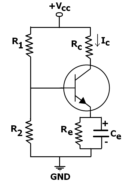

How does Emitter bypass capacitor not affect the amplifier's working?

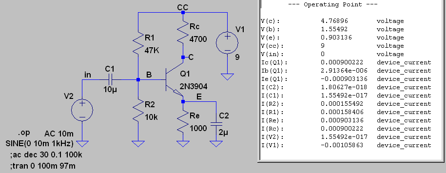

I took the liberty of coming up the following amplifier which uses stabilized bias, utilizing a 2n3904, a 4700Ω load resistor Rc, and a 9V supply. Note that the emitter resistor Re is 1000Ω, so you would expect the amplifier to have a gain of 4700/1000=4.7 if the emitter is not bypassed. I choose the bias network to set the collector voltage just slightly higher than 1/2Vcc, allowing for some DC drop across Re.
First, look at the schematic, and the LTSpice DC bias solution. Note that with the values I chose for the bias network, V(E) is ~1V and V(C) is ~5V, and Vbe = 0.652V.
To make the amplifier useful, the input signal needs to be AC-coupled to the base, which is why C1 is there. C2 is the emitter bypass. The reason the values where chosen as shown will be discussed later.

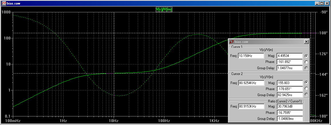

Next plot is a freq domain sweep of of the amplifier gain V(C)/V(in). Note that I'm plotting it on a logarithmic scale (similar to a Bode plot, except not in db). Note that I chose the input coupling cap C1 such that the frequency where the mid-band gain drops to ~2 is 1Hz.
I chose the emitter bypass capacitor C2 such that the frequency where the mid-band gain increases to ~1/2 of the ultimate bypassed gain to be ~1Khz, thereby exposing the mid-band region where the emitter bypass is not yet effective, i.e above the corner caused by C1 but below the corner caused by C2.
You would expect the mid-band gain to be Rc/Re= 4700/1000 = 4.7 [because I(Rc) ≈ I(Re)] and you see that at 10.158Hz (Cursor 1), the gain is ~4.5, just slightly lower than the expected 4.7. That is due to some intrinsic emitter resistance that is internal to the transistor.
Now look at cursor 2, which shows that the gain at ~81kHz (where the bypass cap is fully effective) is ~156, so the gain at any audio frequency would increase from 4.5 to 156 as you add an emitter bypass capacitor whose impedance at that frequency is small compared to Re.
Obviously, if you intended to make an audio amplifier which has reasonably flat response for voice or music frequencies, you would choose a much larger C2. Increasing C2 to 100uF moves the lower corner (where the gain drops -6db) to ~35Hz.
Finally, look at the last plot, which simulates the time-domain response of the amplifier with an input signal of 10mV at 100kHz. V(C) is > 100χ V(in), as expected. It is centered on a DC value of ~4.8V, as predicted by the DC bias solution. The (bypassed) emitter has only a small amount of ripple and is sitting at a DC level ~0.9V, also as predicted by the DC bias solution.
Hope this clears up the effect of bypassing the emitter resistor...
Using the transconductance g=Ic/Vt you are able now to calculate the gain for large frequencies (instead of stating simply "...whose impedance...is small compared to Re").
Gain=-g*Rc=-Rc*Ic/Vt=-4700*0.9*1E-3/26*1E-3=-162.
This result is in good agreement with the simulation (~156). I think, the main reason for the difference is the BJT internal output resistance that was not included in the calculation.

Although here is something else I'm not getting: How does having a high Collector resistor compared to emitter resistor give me better gain? I am measuring my output from what is left out of the drop across the collector resistor. So having a higher voltage drop at the collector resistor should only give lesser voltage at the output but it is not so according the ratio I take. I don't seem to get this?
Think of it this way. Applying a proper vb signal voltage across Re through the base terminal will cause a definite emitter current swing. The emitter and collector current of a BJT operating in the active region are almost identical. Therefore, if the Rc resistance is 10 times higher than Re, the voltage swing across Rc will be 10 times what it was across Re, due to the collector and emitter currents being almost equal. That is, a signal voltage gain of Rc/Re will equal 10. So by making Re as small as possible, either by bypassing it with a capacitor or using the method expounded by Winfield Hill in the link I posted, we get the highest gain. Ask if you have any question about this.
Ratch
Gauthamtechie, in addition to Ratchit`s explanation I like to remind you (see also post#17) that the BJT works as a voltage-controlled CURRENT source (therefore: Vout~Iout).
W.
Hi I think I finally get it!!!!:) It is about the swing!
What I mistook was that If a Large Voltage dropped at Rc, then only what is remaining of the Vcc will be available across the output. But now It seems clear, only If I create a Big Enough Swing with a large Rc, will I be able to use a Vcc and get a bigger difference voltage which is Vout. Isn't that right?
