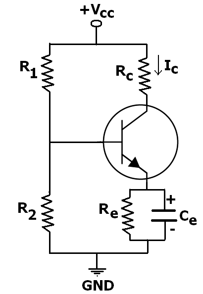

How does Emitter bypass capacitor not affect the amplifier's working?
I have spent weeks analyzing biasing of transistors and I just about understood them to a basic extent.
From my understanding, the Small signal AC is varying the value of Ib and consequently Ic in the load line. If that is the case, then If i provide a Capacitor to short out The emitter resistor, then the AC will not cause any drop across Emitter Resistor and consequently the Operating point just remains there. Then how will there be a Voltage swing at the output? I am definitely missing something
It simply means the AC and DC operating conditions are different - essentially the gain of the stage is set by the collector and emitter resistors (the emitter resistor causes negative feedback). Bypassing it increases the AC gain as you're removing most of the negative feedback (there's still some, due to the internal emitter resistance).
Re degenerates the current gain of the transistor. Thus the lower Re, the higher gain you get, up the point dictated by β and Rc.
Now take two situations, DC gain and AC gain. For DC, the gain is lowered by the Re, and thus lets you set the operating point without it being too much affected by variance in β.
For AC, the Re is effectively zero, so the amplifier has higher gain. Also see https://en.wikipedia.org/wiki/Common-emitter_amplifier
Both explanations above are, of course, correct.
Nevertheless, here comes another formulation of the mentioned effect:
An emitter resistor Re with a parallel capacitor Ce provides frequency dependent feedback.
That means: For very low frequencies (in particular for dc) you have sufficient feedback to stabilize the dc operating point and for frequencies far above the
corner frequency (set by Re||1/g and Ce) you have maximum gain without any feedback.

There is a rough approximation to the gain of the common emitter amplifier. If the collector resistor is Rc and the emitter resistor is Re, the voltage gain Av is very roughly equal to:
Av=Rc/Re
That assumes that the amplifier has been designed properly. With a capacitor across Re we end up with a reactance from the emitter to ground Xe. As we increase the capacitor value, we lower Xe. And now the AC gain is very roughtly:
Av(AC)=Rc/Xe
So we can start to see that when we increase C we lower Xe, and since Xe is in the denominator of the gain equation we see the gain go up.
The difference here is that the gain for DC is roughly Rc/Re, while for AC it is roughly Rc/Xe. So we can maintain the bias point with Rc/Re yet get higher AC gain because of Rc/Xe. Note that we want to keep the DC bias point as constant as possible but we still want high gain for AC. We could not get that with just a resistor from the emitter to ground.

Ohh - I think, this is an approximation that is "too rough" because with rising frequencies Xe is approaching zero and the gain goes to infinity.
Here comes the gain formula, which is to be used for varying Xe:
G=-Rc/(1/g + Xe)
Here you can see that the mentioned approximation is valid only as long as Xe>>1/g .
(Remember: the inverse of the transconductance g equals a resistor, which noemally is in the range 1/g=10...100 ohms, strictly depending on the selected bias point) .
Thus, for large frequencies we have
G=-g*Rc.
There is another resistance in a transistor that is not shorted by the capacitor Ce. See for example the 4th figure on this page:
There is a resistor labeled REE in the diagram; this is the internal emitter resistance.
Also, see figure 5-6b here:
https://www.electro-tech-online.com/custompdfs/2013/05/05.pdf
The resistance labeled r'e is the same internal emitter resistance.
At frequencies high enough that Ce shorts out Re, the internal emitter resistance is NOT shorted and the ratio Rc/REE (or Rc/r'e) gives a good approximation to the AC gain of your circuit.
Thanks I get this now! Although here is something else I'm not getting: How does having a high Collector resistor compared to emitter resistor give me better gain? I am measuring my output from what is left out of the drop across the collector resistor. So having a higher voltage drop at the collector resistor should only give lesser voltage at the output but it is not so according the ratio I take. I don't seem to get this?

in order to avoid confusion for beginners I like to point to the fact that the quantity you call "internal emitter resistance" is identical to the inverse of the transconductance g.
Thus
r´e=1/g..
Therefore, your approximation Rc/r´e is identical to the gain expression I have used g*Rc.
And - of course, this internal resistance is not bypassed by an external capacitor. Otherwise you would have shortened the controlling action of the base region.
W.
Gauthamtechie, you should consider the fact that the transistor acts as a voltage-controlled CURRENT source.
That means: The signal voltage drop across an external load resistor Rc is proportional to the value of this resistor.
Thus: Vout=-ic*Rc.
If you insert ic=g*Vin (eqation of the controlled source) you arrive at the given formula (without feedback).

Hello again Winterstone,
You're just getting absurd here. When the internal emitter resistance is small compared to the external reactance we still end up with the formula i gave. That's why i stated "very rough" and it certainly emphasizes the point that the decreasing reactance increases the gain. Certainly the more exact formula is:
Gac=Rc/(re+Xe)
http://hyperphysics.phy-astr.gsu.edu/hbase/electronic/npncegain.html
but when re is taken to be much smaller than Xe we still see:
Gac=Rc/(Xe)
and that's good enough for now.
You say that you expect a beginner to get "lost" because of that formula, but then you expect a beginner to know what h11, h21, and g are without question. Maybe you are the one that is "lost" here because you dont seem to understand how approximations work :)
So lets hope that the OP knows what h parameters are.

Point of technical fact: if we include the 10 ohm re value when we have already an external emitter resistor value of 1000 ohms, the re makes a small contribution to the total resistance from the 'real' emitter to ground. Either we have 1000 ohms or we have 1010 ohms with and without the re being included. So if the collector resistor is 10k, we see a gain of either:
1. 10000/5000 (my approximation)
2. 10000/5010 (your approximation)
So my gain is 2 and your gain is 1.996, but that's not the end of it. We want to look at the AC gain next.
When the cap comes into play, we might design this stage such that the cap reactance looks somewhat like a resistor at a particular max design target frequency. If we wanted a gain of 10 at the max frequency, then we would have made the cap value appropriate to make the total resistance look like 1000 ohms. So now we have two more gains to look at:
1. 10000/1000 (my approximation)
2. 10000/1010 (your approximation)
So my approximation yields a gain of 10 and yours a gain of 9.9, not a heck of a lot of difference there.
BTW, in a real amplifier an additional resistor is added in series with the resistor that is already in parallel with the cap. This limits the upper frequency gain without depending on the internal re value as much.
