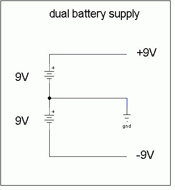

There is a difference between ground and the -9V supply in your schematic. The op-amp is running off a dual-supply, for ex. two 9V batteries connected in series with the centertap considered ground. Notice that the op-amp is capacitively-coupled to the timer IC, which only runs off the positive supply. Many op-amp circuits use a dual-supply because the outputs can't swing all the way to ground otherwise. Many of the newer op-amps have rail-to-rail output swings and can be run off a single supply.
So, ground is not the same thing as -9V, although the (-) terminal on your battery can be ground. In the diagram below, the (+) terminal on the lower battery is also at ground potential. - CAL

hmmm. Most of the circuits I have used have like +9 volts and the ground symbol. Like this one here.
So I always thought ground was the same thing as the negative side of your power source and (-v).
That Infrared schematic uses two 9 volt batteries? Really? And it doesn't use a timer ic. The way I have it connected now I have the op-amp connected to the negative side of my power(-9v) and all those pins connected to the ground symbol in the schematic I also connected to the negative side of my batts. I did a test and instead of connecting those pins to the negative side of the batteries I didn't connect them to anything at all and the circuit still worked. So it didn't seem to make a difference if I connected those pins to the negative side of my batts or didn't connect them to anything at all.

Cyclone, ground usually is the same as the negative side of your power source - when you have a single supply, as in most digital circuits*. Analog op-amp circuits often run off a dual-supply, where the negative supply is not the same thing as ground. Instead, there are (+) and (-) supply potentials relative to ground, as my previous post illustrates.
In the IR circuit,
https://www.aaroncake.net/circuits/irrec.gif
the schematic is drawn showing a dual-supply arrangement, otherwise IC1 pin 4 would be shown connected to ground, not -9V. It's the use of the two different symbols, -9V and GND, that indicate a dual-supply. This circuit probably works fine with a single-supply, since the output from the op-amp doesn't need to swing all the way to ground. What op-amp are you using by the way? Older ones like the 741 don't have rail-to-rail output swings, many newer op-amps do.
(If the circuit doesn't use a timer or one-shot, what is IC2? I assumed it was a timer chip, used as a one-shot)
Like I said in the earlier post, -9V isn't necessarily ground (for example, in a dual-supply), but the (-) terminal on your battery can be ground (the case when you have a single supply). Is that confusing enough?

Thanks laroche I understood that much better. So whenever I see -v and ground in the same schematic its I dual supply. Ok i understand that now. :)
Do you think if i use a dual supply for that circuit that I would get better results?
To answer your questions I am using a LM308 Op Amp IC and a LM567 Tone Decoder. I have some 741 op-amps but I haven't found any usefull circuits for them yet.
