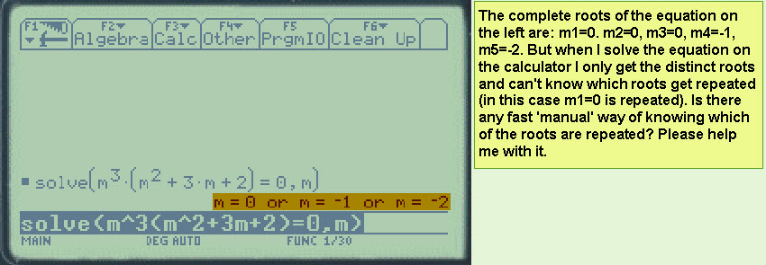

Hi
I was trying to find roots of some equations using the calculator TI-92 Plus (Voyage 200 and TI-89 are similar in functionality to 92 Plus). The calculator only gives me distinct roots and I can't know which roots are repeated. For an example, please have a look on the attachment. Thanks for the help.
Regards
PG

If it is already factored like that you can see that the m^3 term causes three zero solutions.
If not, you can divide by the known roots and reduce the equation to a lower order equation and go from there.
For example, since a root is -1 divide by (m+1) first, then for -2 divide by (m+2), etc.
There might be another trick out there too.

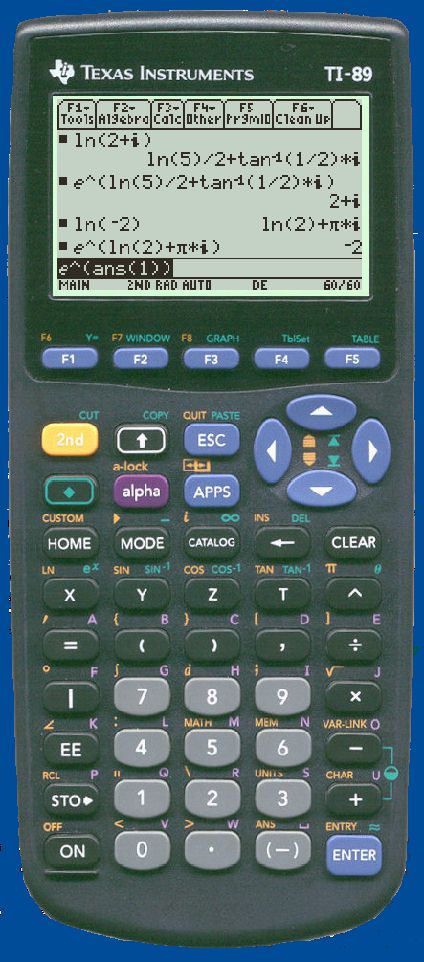

Actually there is a virtual TI that does what the TI can do that is available for download, but it requires a ROM file that can only be downloaded if you own the real life calculator already. You could check though just in case they released some version for people who dont have the calculator. All the stuff can be found on the TI site, or at least it used to be there several years ago.
Here's a screen shot:

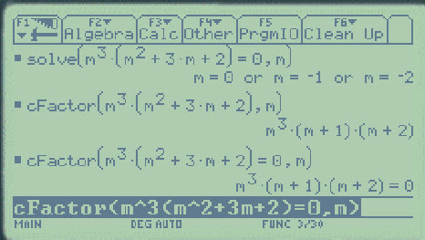

I have found a solution. I was asking a general question to solve any equation. But I see I chose somewhat bad example equation.

Hi MrAl
You need to use cFactor() function of the calculator (Factor() command also works but it won't help you with complex roots). cFactor() will easily let you see which roots are repeated. To me, it looks simple.
Best wishes
PG
