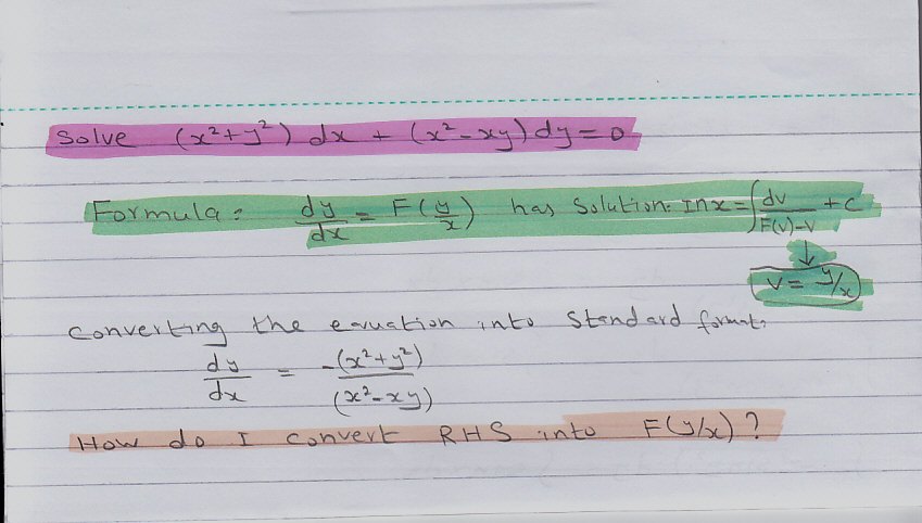

Hi
Please have a look on the attachment. It has my question there. Please help me with it. Thank you.
As you can see, the book gives two formulas to solve homogeneous equation: Formulas.
Regards
PG

One way you could do this is as follows.
Starting with the original equation:
dy/dx=-(x^2+y^2)/(x^2-x*y)
Expand the right side using partial fractions in x:
dy/dx=-2*y/(x-y)+y/x-1
Divide both the top and bottom of the first term on the right by x:
dy/dx=-2*(y/x)/((x/x)-(y/x))+y/x-1
Simplify and group occurrences of y/x:
dy/dx=-2*(y/x)/(1-(y/x))+(y/x)-1
If desired, change into this form:
dy/dx=((y/x)^2+1)/((y/x)-1)
This is now in the form:
dy/dx=F(y/x)
You could also start with the original and divide top and bottom of right hand side by x^2.
Either way once you subtract y/x you end up with:
(y/x+1)/(y/x-1)

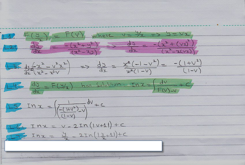

MrAl: Many, many thanks. It was very kind of you.
Actually I have also solved it myself. You can have a look on the attachment.
L8: [latex]\ln x-2\ln \left\vert x\right\vert +2\ln \left\vert x+y\right\vert -\frac{1}{x}y+c=0[/latex]
Best wishes
PG
Hi again,
Oh yes, very good PG. You used the identity v=y/x more directly for a substitution. Good idea.
Thank you, MrAl.
