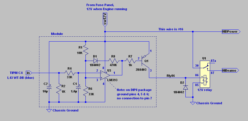

So, basically the board is turning PWM into 12 volts, which activates a 12v relay to bring on the high beam? Paul
Yes, the circuit I posted in #19, above, operates the relay when the PWM percentage is more than 85%. Let's see if we can agree how to wire the relay's contacts.
You mention Rly85, is that shown as Rly86 in the diagram, or is that something else?
As I said: "Rly86 is an output (from the module) that goes to pin 86 of a standard 12V automotive relay". The pointed box symbol with the Rly86 is just a way of showing it as a pin on the module.
You already have a pin D4 in the TIPM C4 connector (blue wire on your original schematic) which powers the Low Beams in the OEM wiring. Can you use this to power the low beams at night? Does this go off automatically when you select high beams? Is this on or off during daytime running?

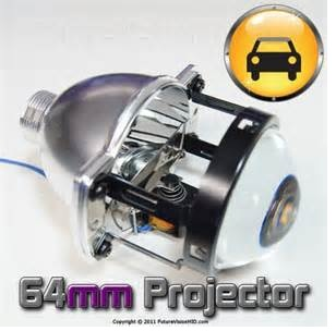

The High beam is solenoid activated on the HID projector, so a single HID bulb is lit on low beam and then when a voltage is applied to the high beam wire the solenoid pulls down a metal piece, which exposes more of the projector light (high beam). Not sure if the old bulbs were double filaments?

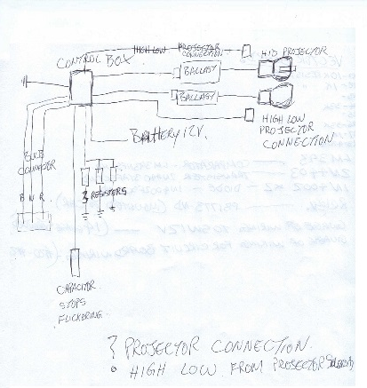

I will be buying the parts this weekend, if our local electronic stores have them? I will check the harness and see if I can trace the wiring that is in the video. The installer did say he had to change the pin orientation to make the system work; so, either that is the problem, or the harness is for non DRL cars?
Schematic from video (from what I can see). Not sure what is going on inside the Controller box? Also not sure what the pin orientation from the bulb connector high low beam projector connector is too the projector solenoid.
Will look at this harness wiring on saturday; as the parts supplier says it should work?

It looks like the original bulbs have two filaments a high and low beam.
So, originally the high and low beams were separate circuits; with HIDs the high beam is the HID projector solenoid and the low beam headlight is the HID bulb.

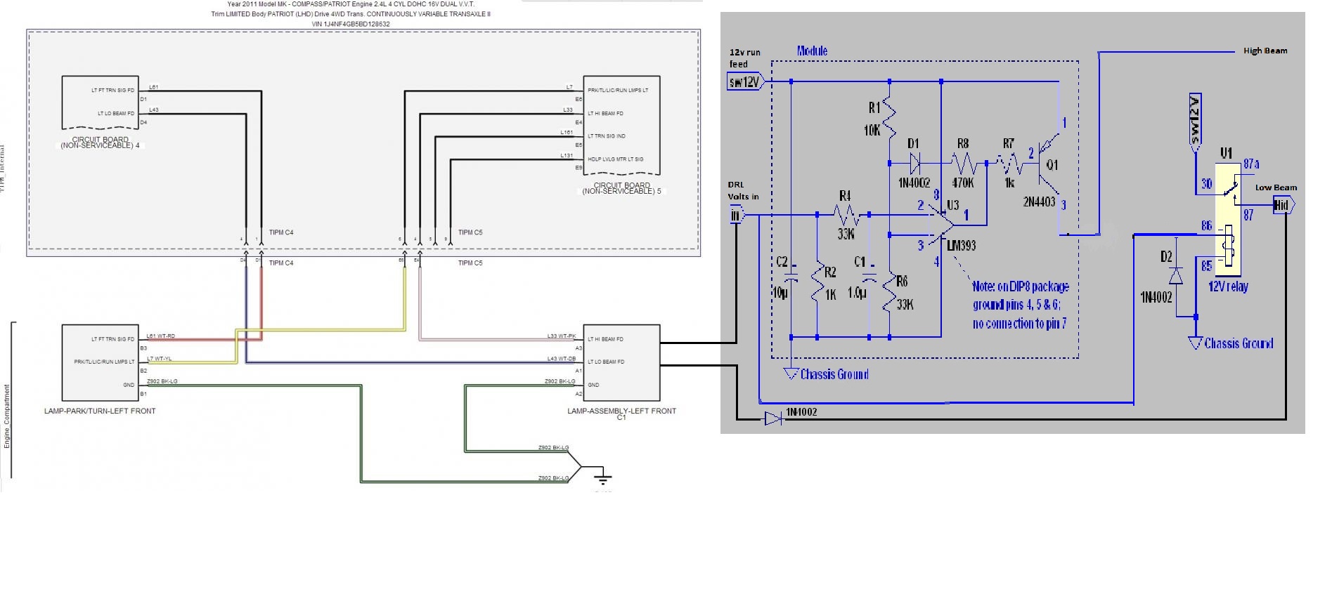

I modified the earlier schematic. Nothing inside the "module" has changed; only the relay wiring and I added some annotations.
Poke around the fuse panel with a voltmeter, and you will likely find an unused circuit/fuse. The fuse might not be installed, so install a fuse big enough to carry the two HID projectors plus about 50%. Try to find one that is live with the key in the "run" position; it will likely not be live while the key is turned to the "start" position.
If you bought the relay I linked to, the snubber diode is built-in, so don't add an external one. No other diodes are needed in the HID wiring.
While re-reading this thread, I noticed something on the partial vehicle schematic you posted way back in post #1. Notice the internal wire in the right hand part of the diagram that is labelled E4, L33, LT Hi BEAM FD. It comes out of the controller as pin 5(? fuzzy) on TIPM C5. It was not connected to anything in your vehicle, but it might be a signal line that has 12V on it when you switch on the HiBeams. If that is the case, you could dispense with all of the external stuff (Module and Relay), and wire this signal directly to the HiBeam input to your HID projectors. The power for the HID power supply would still need to come from the fuse panel from a circuit that is live only with the key in the run position as before.
