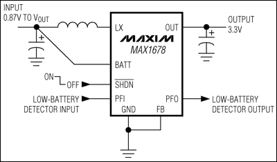

crazyGSM New Member Aug 15, 2007 #10 after lose some time searching and study some solutions i will use this one based on a MAX1678 from MAXIM-IC. Schematic attached 1 Indutor 10uH and 2 capacitors(ceramic and tantalo) Attachments MAX1678-ESTA.gif 9 KB · Views: 179
