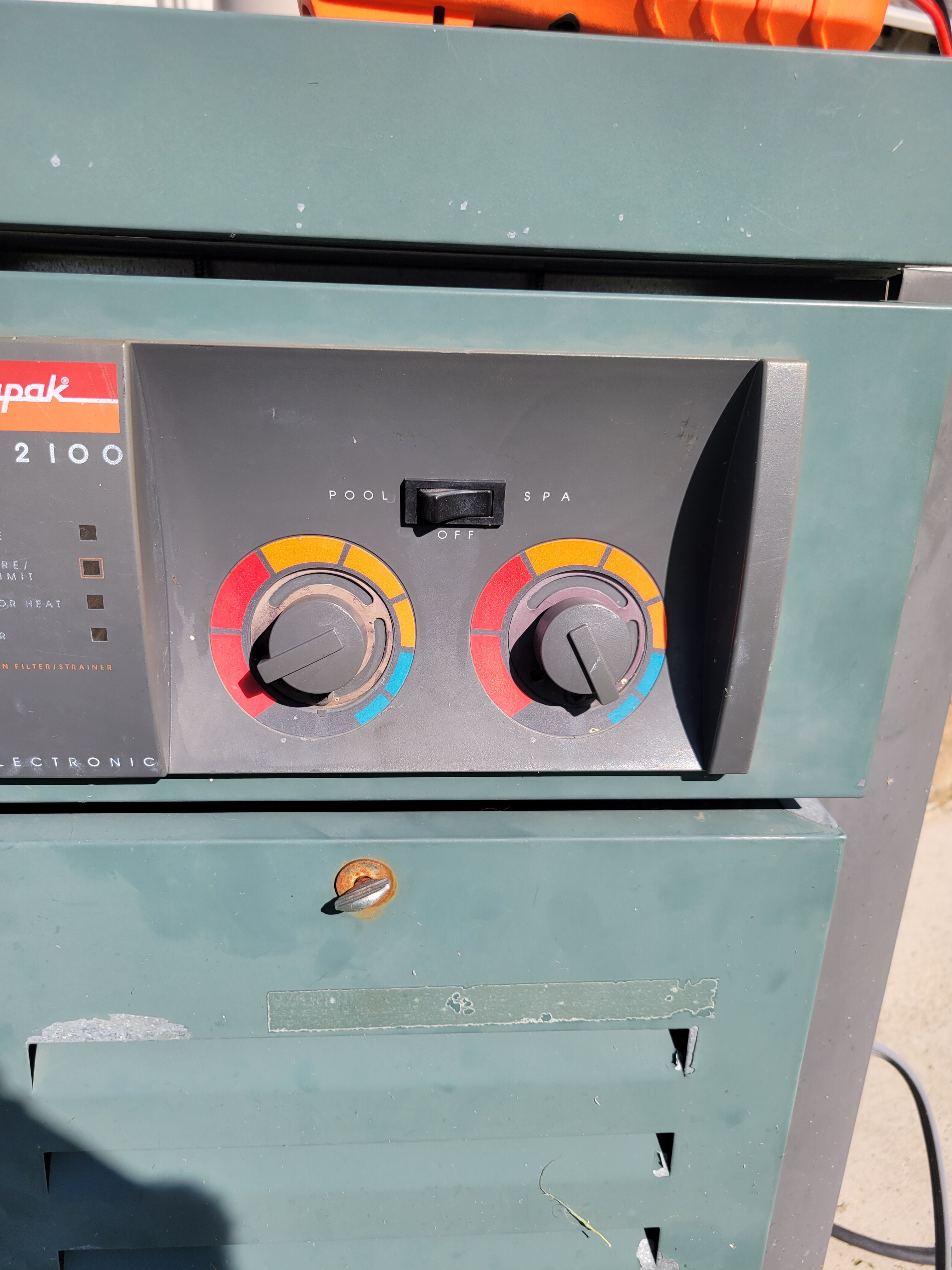

I have a pool heater that I have to replace the electronic control board often. I have now replaced the board 5 times. Each board shows the same issue when it needs replaced. I have tested all of the control switches all test good. The thermister is one item that is not basically an open or closed switch. As I'm sure everyone here knows the resistance value of the thermister changes with temperature change.

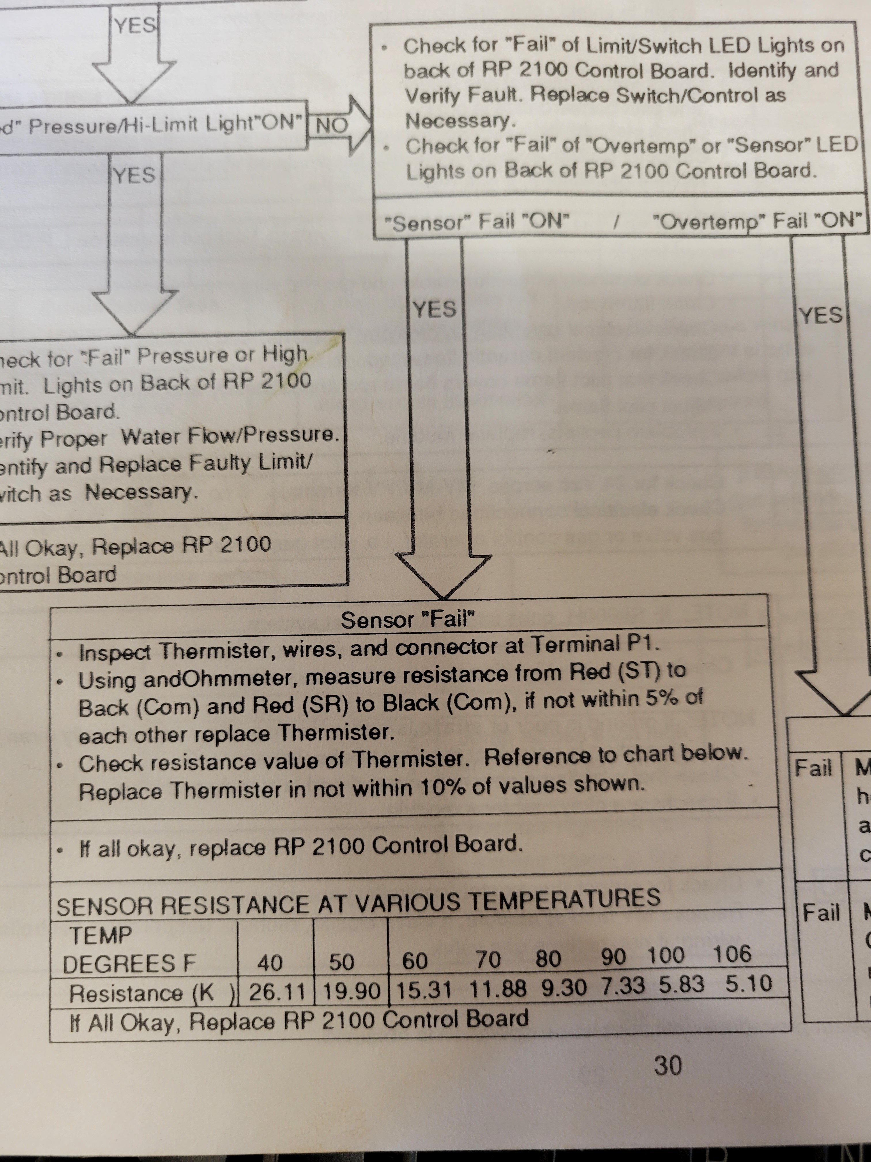

The one I need help with has three wires, ST-COM-SR. The manual shows to test Resistance based on the water temp. So Lets say that the water is at 60*F. The resistance between ST -COM is 15.31(K), resistance between SR-COM is also 15.31(K) within 10% of each other is good.
My thermister tests good with my VOM. But I still think that it may be bad. It is a fairly expensive part to just guess needs replacement. So I would like to make a "test" tool with two resisters. Seems simple enough to do use one side of the resisters together for COM then the other side for ST and SR.
But I am not savey enough with electronics to know if this will work or not to"trick the board into "thinking" that it is a working thermister. I also don't know how to choose a resister to give me the correct value of 15.31.
I will replace either the board or thermister after my test. But at this point it is hard to belive that the boards keep going bad with the same symptoms.
Any advice? TIA
Ron

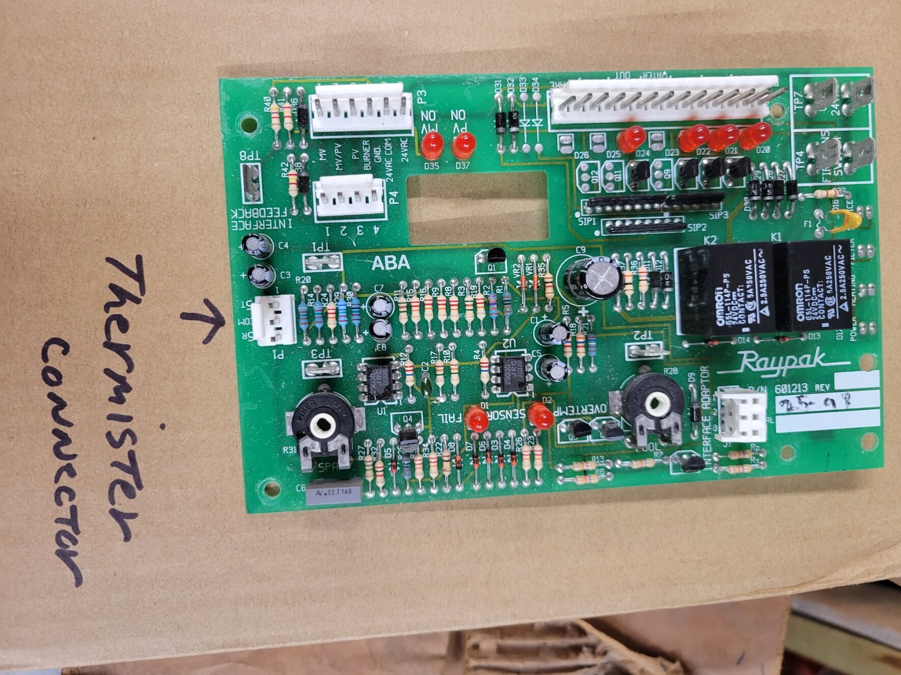

How long do the boards last?, and can you post a picture of one (both sides, top and bottom of the PCB.

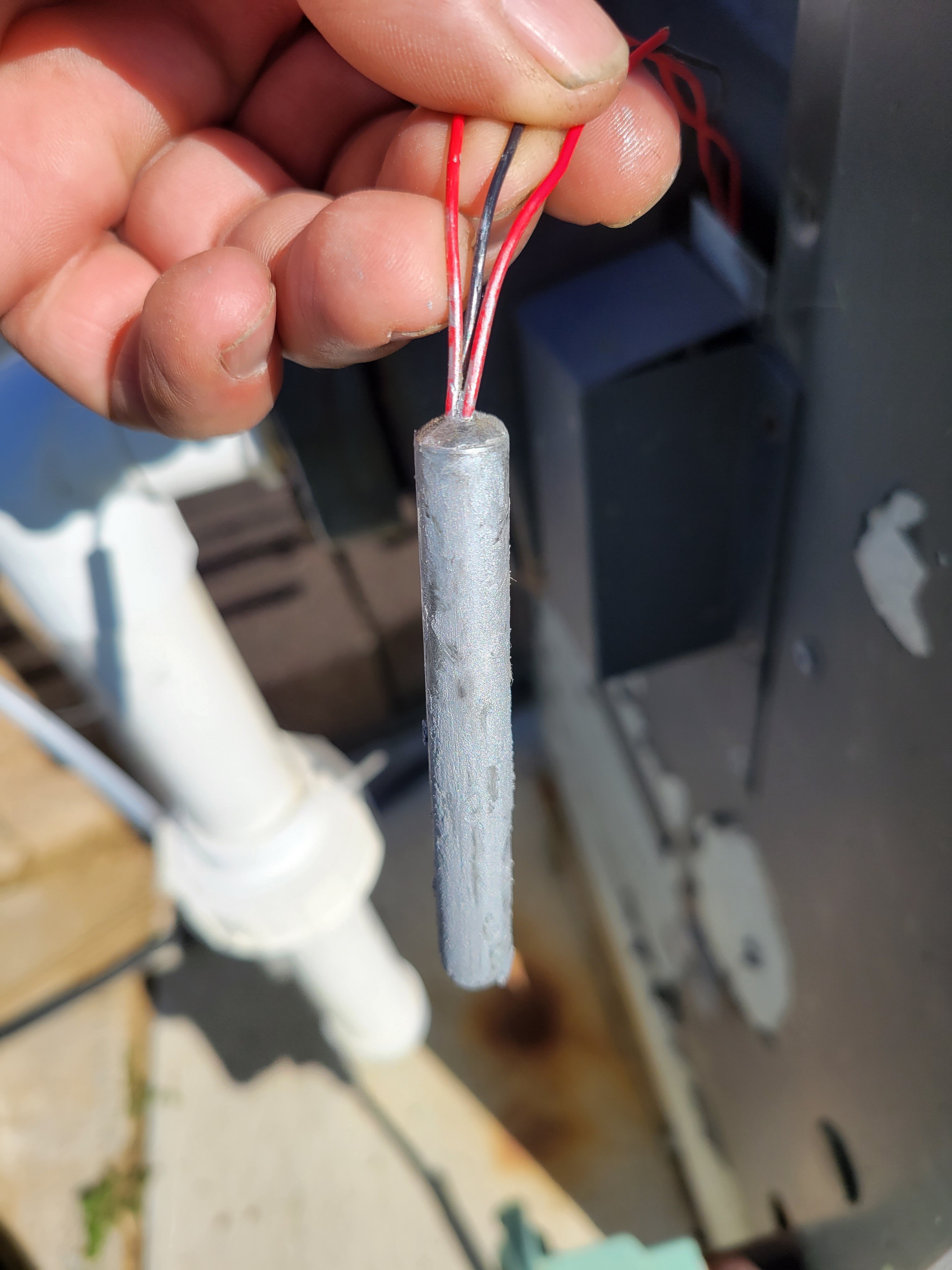

Looking at your numbers a 10K standard thermistor will have a resistance of 15.310 K Ohms at 60 F. Leads me to believe you have a dual 10K thermistor which is doing just fine. I would try as Alec suggested in post #4.

This is one of the boards that I have replaced. Part of what makes me question the thermister is that, if I unplug the connector while the unit is powered on I can hear the relay click and the gas valve click open and close quickly. In the past I have been able to get the unit working if I tried this eventually it would work and the heater would work as normal. Now I am unable to get that "trick" to work. It still acts the same, but will not make the system work. Almost seems as a bad connection at the thermister plug. But that is where I have taken my readings and they are always within spec. I can provide any info needed on the board. There are some numbers that I assume are part numbers, but don't help me.

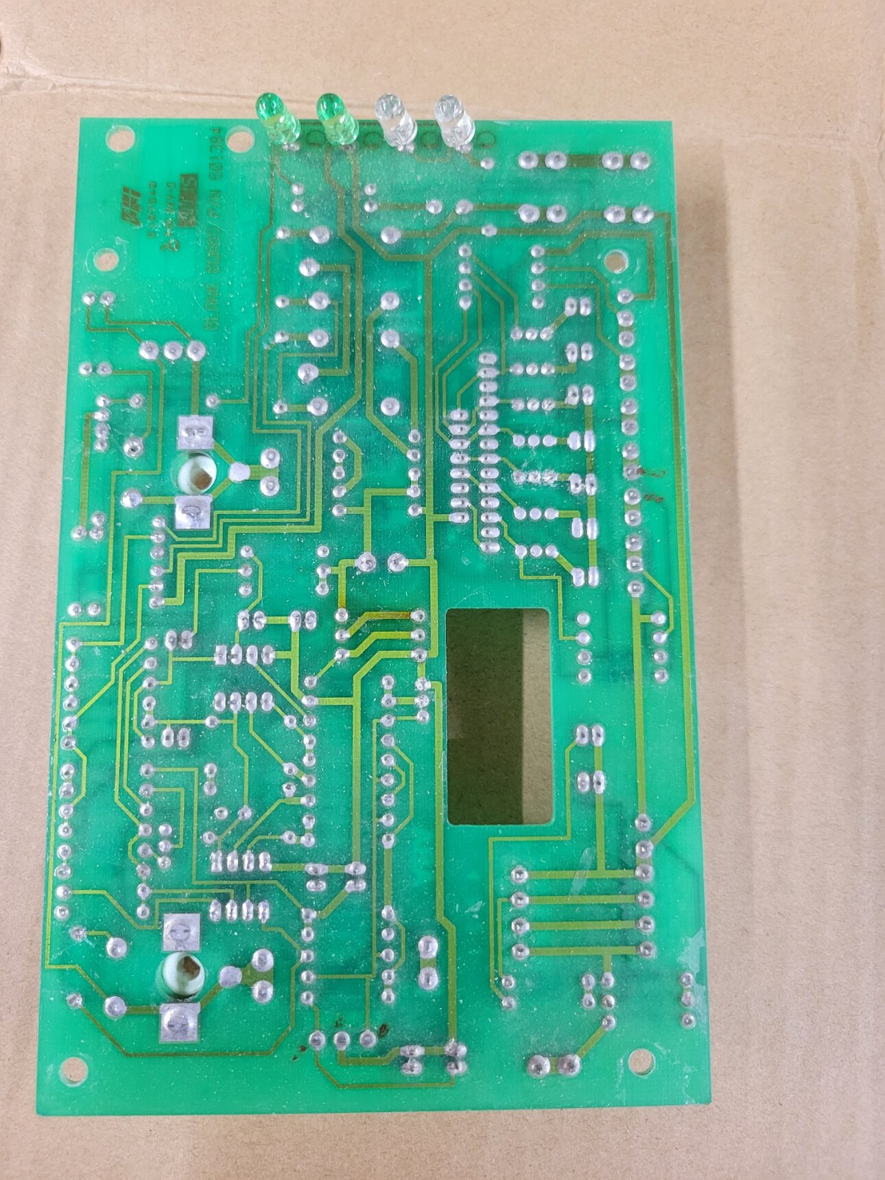

Sorry about the backside photo. I should have orented it as the frontside is. The thermister connection in the second photo is the three solder joints at the bottom of the photo.
Is this correct thermister as suggested in post 4?

I may not have explained what I am trying to accomplish with the test thermister idea. The board has a potentiameter that adjusts the temp setpoint. I have checked and the resistance does vary with the turning of the knob on the pot. I am pretty sure that the thermister is simply what measures the water temp and when the board sees the resistance from the thermister it determins if the temp is at setpoint of the pot. What I want to accomplish is to have the board "think" that the temp is below setpoint and turn on the heater. And since the resistance won't change the heater will stay on.
The board actually has two control sides. One Pot is Pool, the second is Spa. I get the same responce out of the board on either side Pool or Spa. When working properly it works on either side.
I have never seen a three wire configured thermistor. Not to say such a design is not out there. Three wire RTD configuration yes. The example you mention above the numbers would match up with a 10K thermistor. I am not sure what the designations ST and SR are about?

The pool temp is 68*F as measured by the pool thermometer.
My readings are SR-COM=12.73K ohms
ST-COM= 11.87K ohms
Seems within the 10% differential. But I am not sure how to test the rest of the board. Still seems odd that I have had several boards go bad in the same way.

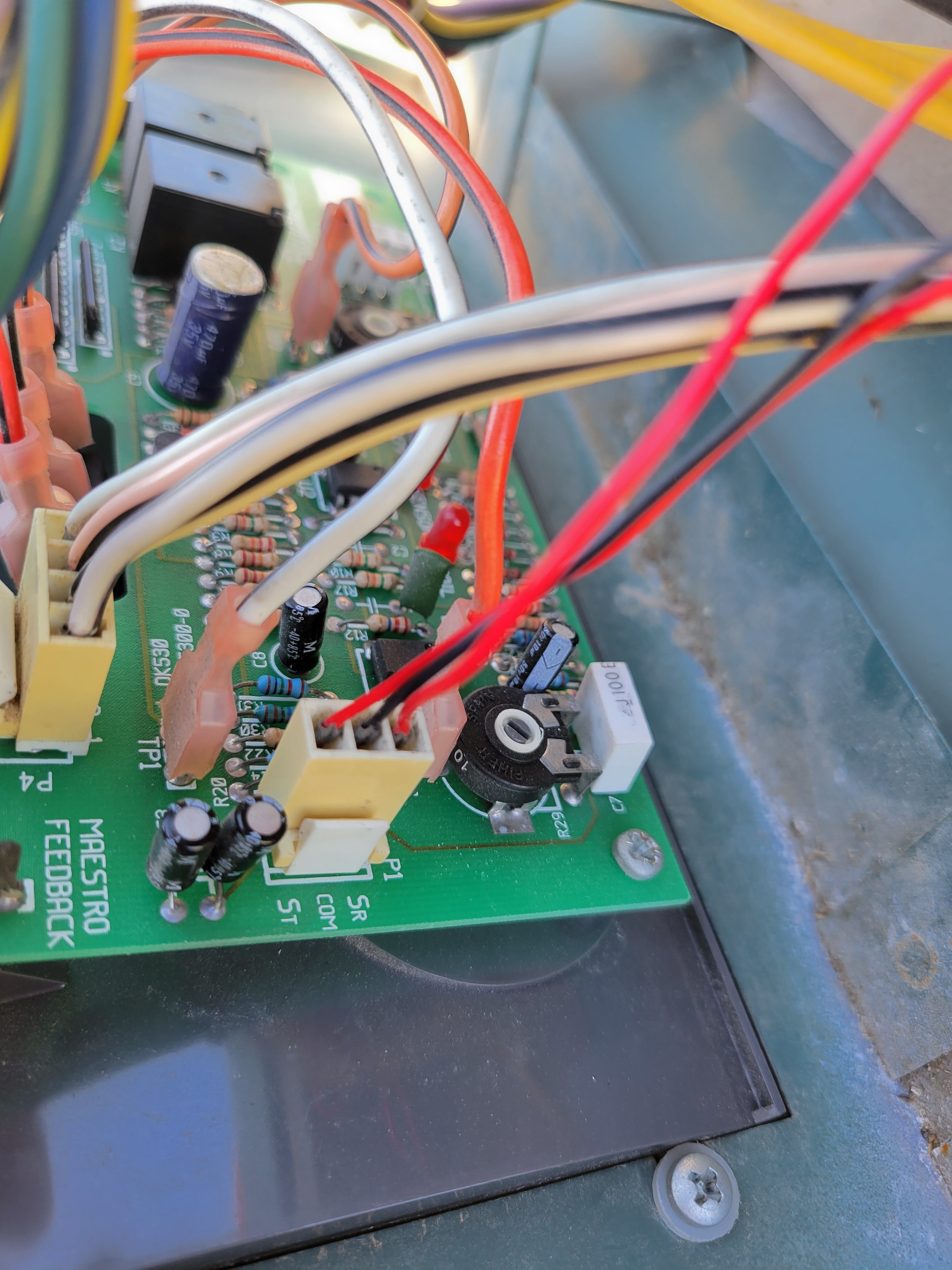

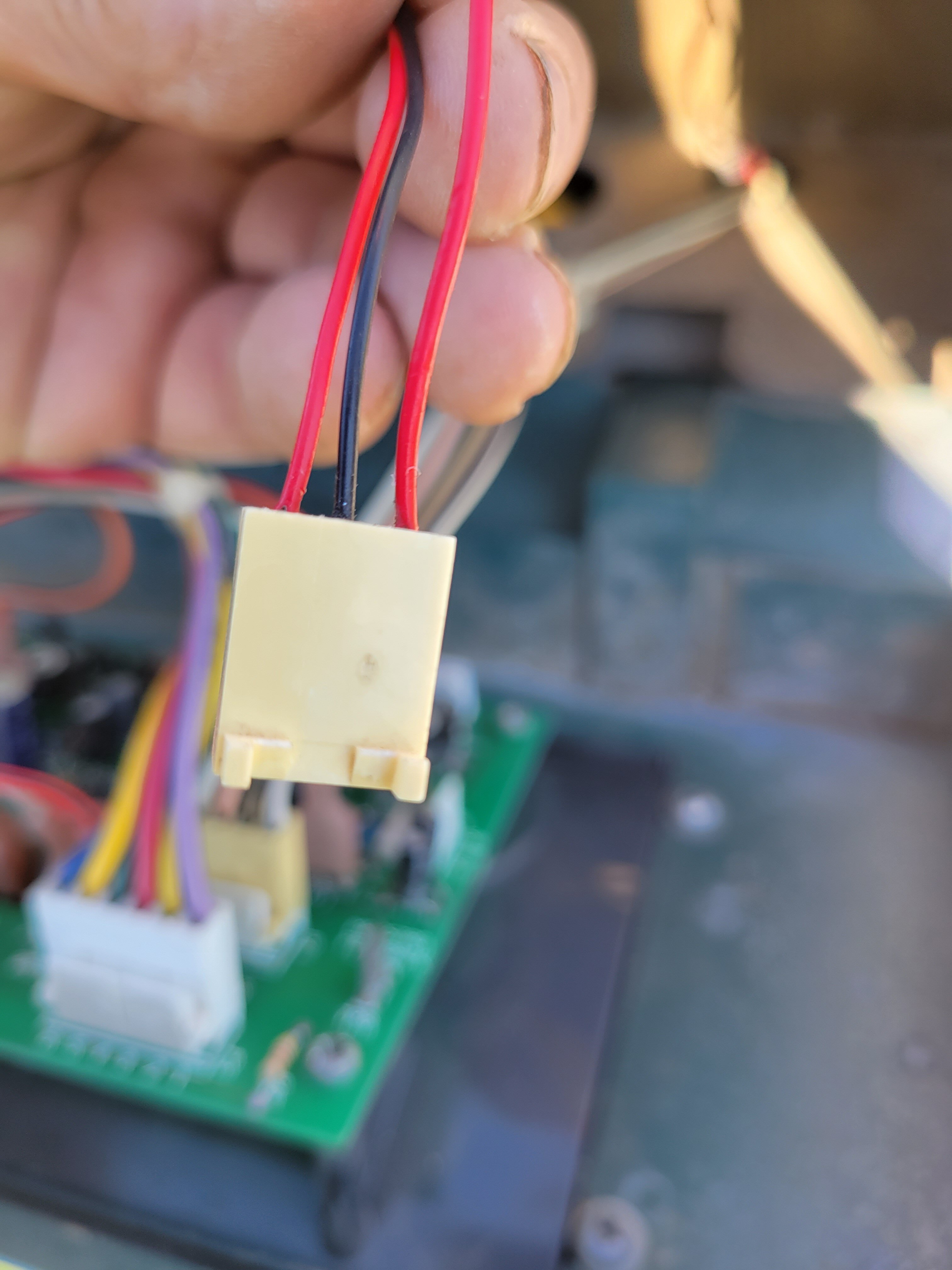

The unit was unpowered for these photos. The Pool-Spa switch is normally left in "Pool" mode. But as previously mentioned don't matter to the working of the heater.

Well for 68 F, a 10K thermistor should have a resistance of 12,491 ohms or 12.491 K ohms. Your numbers are pretty much inline with what I would expect. Keep in mind thermistors are not quite linear animals. Figure 67 F would be 12,809 ohms and 69 F would be 12,182 ohms. For applications like you have thermistors offer an inexpensive sensor solution for process control.
When several boards all fail in the same manner it sort of points to a design flaw. They do mention a 5% differential maximum. Very important is make sure the thermistor connections to the board are clean and secure. There is no reason to have to replace control boards over and over again.
That probably explains the 2-thermistor package. But if one is for Pool and the other for Spa, how can they be in the same physical location?
I note the package has two red wires. That suggests the two thermistors are matched and interchangeable in theory.
I wondered if the designations 'ST' and 'SR' had any significance in some foreign language, but Google Translate doesn't throw up anything obvious.
I'd guess it is a dual sensor system for safety, to prevent the heating running away as it could if a single sensor failed.
If the two sensor readings do not match pretty closely, it will shut down rather than heat to an unpredictable level.
Does it display an error message pointing to the sensor as the culprit?
Yes the Sensor Fail Led that can be seen in the photo. It is mentioned in the diagnostic flow chart. That can also be seen in the photo. Of course the suggested "fix" is replace the board.
I have 5 of them. I'm tempted to start removing parts and testing them. Sadly I don't know how to test several of the parts. Most seem pretty straight forward to test with a little Google help. But I don't know about the SIP's. No idea what they are.
Any suggestions how I would do that in a logical manner?
