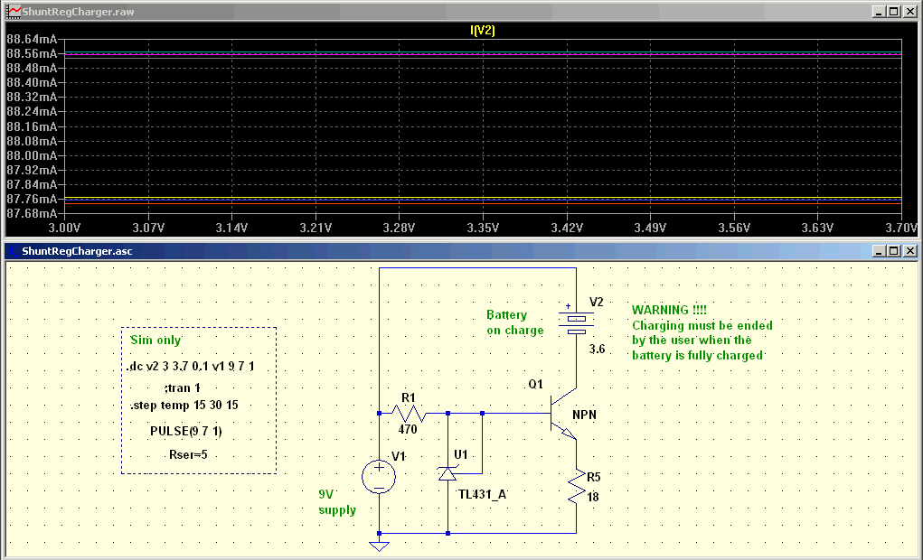

Here's how a TL431 could be used as a voltage reference for a simple constant-current charger for a NiCd battery. There is very little power wastage in the '431; most wastage is in Q1. The values shown would give a charge current ~ 88mA, for supply voltages varying from 9V to 7V over a 15°C to 30°C temperature range. Note the WARNING! The circuit has no way of terminating the charge automatically so would be unsafe left unattended. I don't recommend building it: it's just for educational purposes to show the principle of operation.

Here's how a TL431 could be used as a voltage reference for a simple constant-current charger for a NiCd battery....
Oh yes! Another problem has been solved! But what is the charging voltage (Vout) here? Is it just a current limiter (instead of voltage reg.)?
Which simulation programme you used? I using LT spice but it has no TL431. (no good internet to update LTspice)
It's whatever the battery needs across its terminals to maintain the constant current, so Vout is variable. The circuit tries to hold the current constant; it doesn't just limit it to a maximum value.

5V won't be enough for that charger circuit to charge a 3.6V battery.

Not in my circuit. The emitter resistor is what sets the current. The 431 is configured as a 2.5V reference, so the emitter voltage is 2.5 - 0.7 = 1.8V. The collector voltage must be >1.8V, so the battery on charge would have to have a voltage < (5 - 1.8), i.e. < 3.2V.
I think Max.Power dissipation from 18 ohms resistor is (approx) 800mW. Then I have to use 1W (or 2W) resistor. Am I right?
