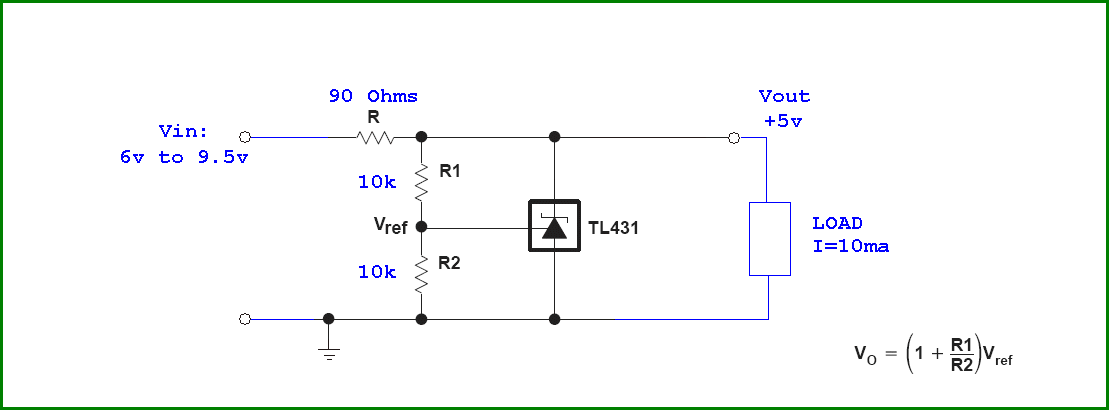

Wow! I want to use regulated supply for oscillator of tiny FM Transmitter for stability. So here is parameter as you asked:
1) Input ca be 6V to 9V. (ideal is 9V because will use 9V battery and it goes down after few hours of using to 6V and lower)
2) Output voltage needed 5V.
3) Current needed for oscillator is around 10mA.
4) My room temperature is normally....lets say 30 oC.
OK than can you show LDO schematics now using TL431?
Hello again,
Here is a schematic for your purpose.

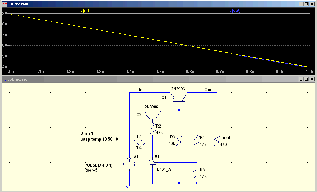

Here's one possibility, with a ~0.1V dropout. But wouldn't it be easier just to buy a 5V LDO reg?

The shunt reg you posted is certainly simpler, albeit at the expense of higher current wastage (~34mA as opposed to ~2mA for the series reg) and a greater dropout voltage (~1V).

Wow! Droupout is ~0.1V? Better than real LDO regulator wich has LDO ~0.3V! Let me guide something-
1) What might be the max-min input voltage for this circuit?
2) I think I can use any general purpose PNP transistor like BC557 (?)
3) there is 470R as a "Load", should I have to remove it if I connected the circuit to a real load? (to oscillator)
4) what is the load output current
5) To get desired voltage output with LDO, should I have to use variable resistor as a R5?
Thank you.

Hello Willen and Alex,
I designed that simple circuit based on your specifications, therefore it works the way you said it should work. It works from at least 9.5v down to 6.0v and always provides an output of 5.0 volts.
Your stated specs do not require a 0.1v drop out voltage max, it requires a 1.0v drop out voltage max.
You stated:
1. 9v down to 6v
2. 5v output
3. 10ma output
The circuit i provided does that. If you have other specs to add then you'll have to consider what might change.
I might add that Alex's circuit is not a bad circuit so if you wish to provide two transistors you can get longer battery life.
So the choice is yours, to go with a very simple circuit which would draw more current from the battery, or go with a more complex circuit that will allow a 9v battery to run the transmitter for a longer time period. If it was mine, i would add the two transistors, or else use a switching regulator. I hate wasting battery energy :)

Oh yeah, one small problem with your circuit Alex. The resistor R1 is not of sufficient size to allow the TL431 to work with it's specified minimum cathode current of 1ma. Decreasing this to around 700 ohms should solve this problem without upsetting anything else.
Good point, MrAL. I tried various R1 values in the sim and found values above ~2k didn't do the job. I forgot about the 1mA minimum current.
To answer your questions in post #14, Willen :-
1) If you want 5V out the minimum Vin is ~5.1V. The max Vin is limited by the voltage and power ratings of Q1.
2) Yes, but one with a low saturation voltage is best.
3) Yes, remove it (it just simulates your load). Replace it with the actual load, plus decoupling capacitors (say 10uF electrolytic and 0.1uF ceramic).
4) Regulation is maintained for load currents up to ~60mA. For higher currents you would need to (at least) reduce the value of R3. Higher currents raise the dropout voltage slightly.
5) R4 and/or R5 could be adjustable to change the output voltage; e.g. a 100k pot could replace both.
