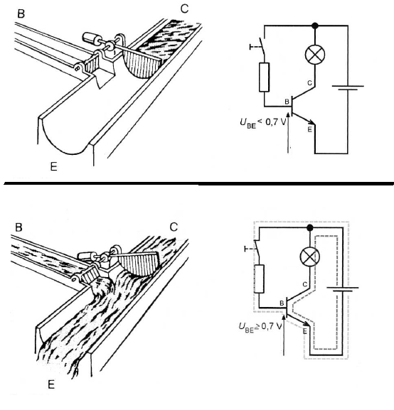

This image show how BJT "amplifier the current".
67-png.75793
Also don't forget that amplifier is a device that allow as control the flow of "high power" by helps of a low power. To the Amplifier effect occurred, two things are necessary: source of energy (power supply) and a device for controlling the flow of this energy - > the amplifier.

Jony, I love the pictures. and you explained with out using 'water pipe' theory. 'water trought' theory.

Great, that was also my confusion for a long time.
