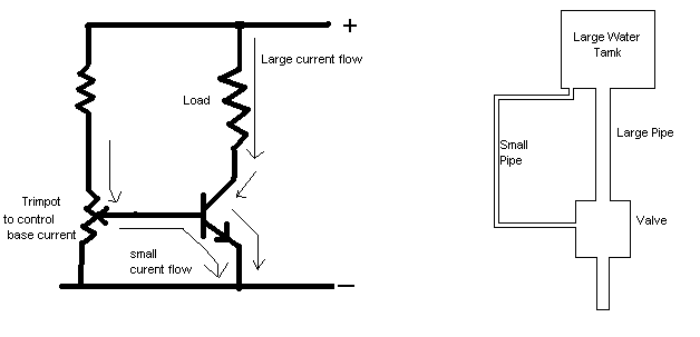

So what cause this high ratio ??:(
there's no changing happening
you have a small current supply on the base and a large current supply on the collector
the small current supply on the base is controlling how much of the large current supply is allowed to flow through the collector to emitter
untitled-gif.75785
As much as I hate using water analogies for current flow
EDIT .... Imagine that the + supply is capable of a max of 10 Amps and the design of the transistor is such
that by varying the current flowing through base to emitter can vary the collector - emitter current from 0 to 10 Amps
now we cannot get 10 Amps flowing through the base because the value of the trimpot we chose and the other resistor above it limits the current
does that help ?
