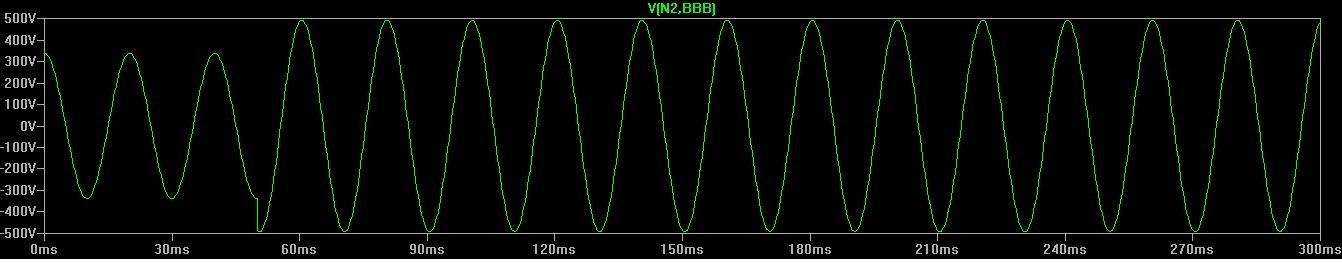

loss of neutral at 50ms..note sudden jump in ph-Neut voltage.
This is from sim of #19 above

It doesn't really show anything, as there's no context - if you remove the neutral at the sub-station, then it depends entirely on the respective loads on each phase - if the phases are well balanced (as it's designed to try and be) then the voltage should remain the same.
By adding you own 3 phase transformer, all you're doing is moving the issue - if you lose the neutral on the output of the transformer you've got exactly the same situation.

For a 10kW installation, supplied with three phase, how can we ensure that the Line-Neutral voltage does not rise up to the line-line voltage if there is a loss of neutral connection?
Is'nt this the question?
