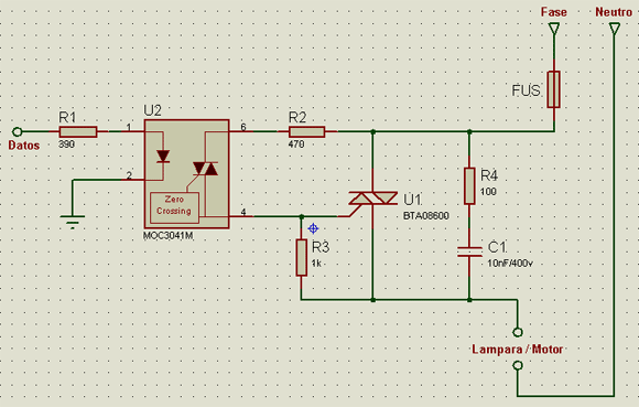

3) Several people have mentioned that I should use opto-isolation in the event that the relay should fail. How do I implement opto-isolation in the circuit I described? Would it go in a driver circuit for the relay?

3)
Opto-isolator - Wikipedia, the free encyclopedia
And check the attached schematic. Istead of relay it uses a TRIAC
The relay provides isolation without the need for additional opto components.

3) Opto isolation is a little more troublesome because relays require a modest amount of current to turn on so you'll need an addtional power supply at the site of the relay unit to provide the power needed by the opto isolator, it can't be derived from the driven signal because it needs to be turned into light and then back, which is horribly ineffcient.. If you're doing that might as well put one on both ends and use a fiber optic cable instead.
