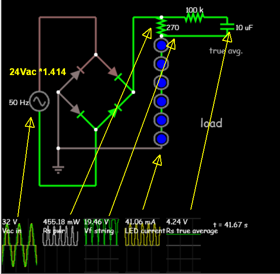

I have built the circuit below, all works fine but I'm a bit alarmed at the resisters as they get very hot,
(you wouldn't want to put your finger on them for too many seconds)
Is this O/K or have I got summat wrong.

Do you have a capacitor after the rectifier? If you have, then the DC voltage is about 33V and the power consumed in the resistor is about 0.66W and that will make a 0.25W resistor hot.
The ideal solution for driving LEDs from a voltage source is when the voltage drop on the Rs current limiting resistor is less than the LED drop.
Your results indicate 5.4V thus add one Blue and two Red LED to each string and recompute the R value.
e.g. you had 20mA * 270 Ω= 5.4V and 20mA * 5.4V = 108 mW which is too much for a 1/8W Resistor but should not be for a 1/4W.
Instead 5.4-3.2V = 2.2V becomes 110 Ω @ 20mA and 44 mW which will be much cooler.

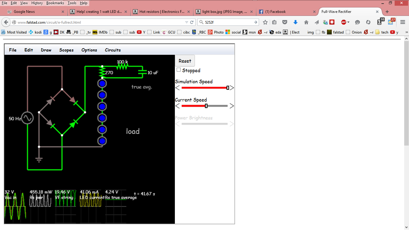

I suspect the resistor value was chosen to match the measured average current is correct and my assumptions of average power dissipation for a 1/8W resistor would give his observed temperature rise. 24Vac secondary depends exactly on the primary rating and actual values. My calculations for 24Vac rms and ~30Vpeak yield approximately 20 mA with <50%% duty cycle meaning 40mA peak. The Red Vf of 2.1V is accurate for 630nmD LEDs but 660nmD Red will be 1.6. using GaAs which are older technology less efficient types.
THe Vf string of BLue is 3.2V*6 = 19.2V while if the secondary AC is 24V, then the peak voltage out of the rectifier will be 32V and thus the peak voltage drop will be 32V-19.2= 12.8V
The ESR of Blue will be around 15Ω *6= 90Ω,
The ESR of the diode bridge and transformer will be around 2Ω with 1.3V drop on the bridge approximately.
Thus with 270 Rs and the above, the peak current will be 12.8V/(90+2+270) = 35.5mA
With a narrow rectified sine pulse peak of 12.8V above the BLue LED string with a source voltage of 32V or 40% duty cycle, I expect the average BLUE LED current is near 40% of 35.5 mA or 14mA.
With secondary voltage based on full load, I expect the the secondary no load voltage to be 10% higher , and using 160mA peak out of 240mA rating , perhaps < 5% higher than 24Vac * √2
I assume his average current measurements ere done simply with a DMM which will be accurate enough for this.
\Line voltage variation of 10% is provided in NOrth America, while other countries may be worse.
THe temperature of LED junction can be estimated by feeling the Cathode lead and expecting some heat as the reflector of transparent substrate is also the heat conductor to the negative side.
For a more conservative approach 15 mA could be the target, but since LEDs are cheap, you can drive them with 20mA in room temp and derate above 40'C.
I certify my assumptions are reasonable and his results are to be expected with noted tolerances on assumptions.
Adding a large CAP is not recommended
as this will only make it more sensitive to AC input variations with loading affecting the Avg DC out with load variations. i.e. wide span of Vdc from no load to full load of 40%
Consider a 270~ 300Ω 1/2W solution and report on measurement details.
If the 270Ω Rs is indeed 1/4W then consider 330Ω 1/2W and maybe 4 or more strings can be added before the transfomer gets hot.
The AC voltage from the transformer should be measured but the non-linear load from the LEDs will distort its sinewave into an oddwave.
4.24V true Avg ( for test only) /270R =16 mA assuming 19.46Vf for string of 6 BLue LEDs
Above shows peak values only.
Simulation
