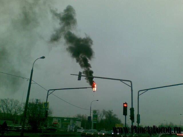

Well what-ever you do, dont do this :)
Thanks for the reply. The stoplight is actually the real thing. it has ac bulbs and is wired to ac right now but I intend to remove the bulbs and make LED lights to put in place of the old style bulbs as this is an old light. I intend to convert it to a dc system with a "radio shack" ac/dc converter that plugs in to the wall. I wouldn't think that I would need relays but nothing is out of the question at this point...definitely dont want to recreate the picture. thanks
