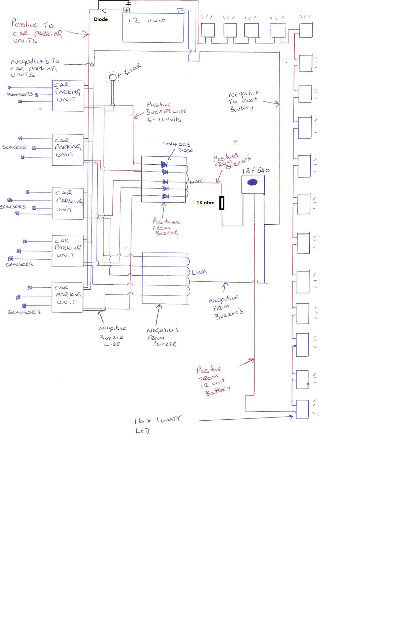

I have manage to build a motorhome alarm using car parking sensors
I have link 5 car parking sensor together giving me a total of 16 sensor place around the motorhome
Each sensor has a buzzer wire positive and negative going to a piezo buzzer the voltage at the piezo is betweeen 6volts and 11.78volts at different stages of detection
I have removed the buzzers to all of them by one {this is to warn me inside the motorhome }and have used all the wires as triggers
I have wired all 5 postives together after putting blocking doides on each line this then goes to the gate on a mosfet irf540
the neutrals go to the source
I then have 16 x 1 watt leds in a ring going to the drain via the postive of a 12 volt battery {this battery is not linked to the alternator }
The neutral going to the source
I have had it up and working fine then i ask a elecronic guy to put a mosfet into a box to make the design look better and different one irf640 and when i fitted it all the parking sensor blow up ie there is now a constant bleep from all of the sensor units when you are not in detection range of the sensor dam
So my question
1 if the mosfet was at fault how can i protect this circuit ie the positive and negative coming from the a reverse polarity or breakdown of the mosfet?
2 I belive I have protected the postive side of the buzzer wire from reverse polarity with the use of the diodes ?
3 how can I or do I need to protect the neutal side of the buzzer wire from reverse polarity?
Thankyou for any help what so ever !

Drawing
Hi Tony,
I'll post your drawing here for you so we can get everyones input.
Yes, just add the resistor from gate to source (pin 1 to pin 3). This may not fix it because we don't know exactly how the alarm works. The resistor will just try to make the gate go to ground which turns the FET off. With 6 volts on the gate it is on.
The other problem is that you have 16 leds all in series across 12 volts. Depending on what kind of leds they are they will drop about 2 to 3.6 volts or so for each one. So for them to work you might need as much as 57 volts to light them. The other problem with how you have them shown is that if the voltage were high enough there is nothing to limit the current through the leds so they would burn out. To fix this we can put a few (depending on what kind you have) in series with a resistor to limit the current. Then put several like that in parallel with the first so they all work. Post a link to your leds if you can or at least tell us the color and we can guess.

My mistake for not explaining the LEDs are one watt each and have resistors
Built in the design of the glass they are produce for a 12 volt system
I have had them all working together nice and bright off the one 12 volt battery
My main concern was if the MOSFET failed would the voltage from the 12 volt battery
go through the buzzer wires?
Im still trying to work out how the damage MOSFET could of fried them in the first place
To prevent this happening again
So I suppose I'm asking if you could tell me is there enough protection on the two buzzer wires to
Prevent any possible current / voltage going through them to the parking sensor
Thank you again for your kind help Tony

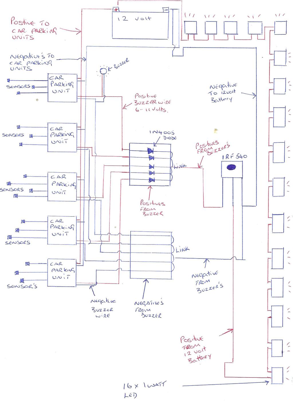

As said there are 5 main parking units each can give out between 6-11volts to the buzzer wire whilst under detection
I have wired all 5 up to one gate of a mosfet irf540 which i believe had a vgs of + _ 20v
It is possible for all of this units to trigger at once if someone was to walk around all the sensors
So should i wire a mosfet for each parking unit i will atached a picture
Thanks Tony
Hello Ronv here is a picture of my paln can you let me know if im thinking correctly and that i do need to do this .As im not sure ,after reading the data sheet for the irf540 n channel mosfet im still not realyy sure what im reading thanks again
Tony
That shouldn't be necessay as the voltages don't add.

Thankyou I was not sure if they added at the gate {lack of knowledge }so as they dont add the reason for them blowing up I assume is that there must of been a short to ground somehow which travelled back through the neutral wires of the buzzer into the unit as I had no diodes on that neutral side of the buzzer wire circuit but had blocking diodes on the positive side
So now I can now assume with blocking diodes on both positive and negatives no voltage can travel back to the parking unit via the buzzer wire which is now my only concern
With regards to the parking unit i belive just after the socket for the buzzer wire connection there is a small controller which i have been told before dosent like any reverse current /voltage i havent investigated that any futher as it is beyond me and easier to buy new units as they are very cheap in the uk about £5
So my main aim now is to try and simply prevent any voltage going back through these wires

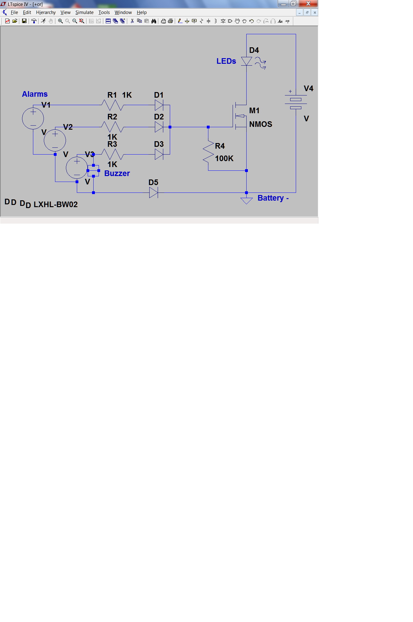

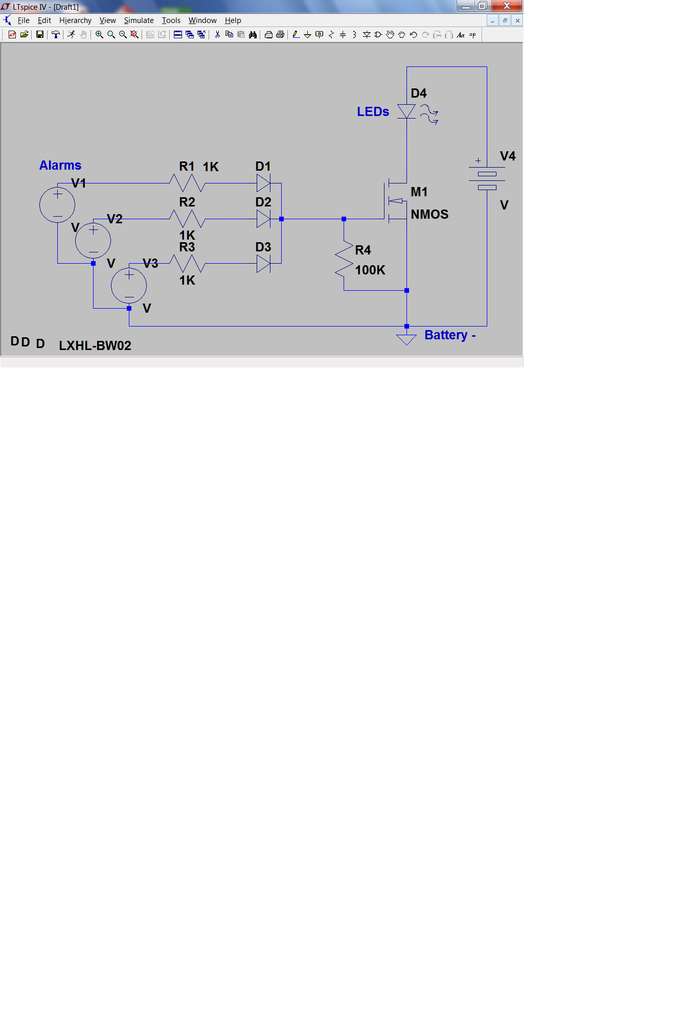

The way they were wired originally should have worked ok.
Try it like this. The resistors should protect the alarms even if there is a short. The 100K is to make sure the FET turns off.
If you can, post a link to your alarm board.

Thanks Again Ronv that diagram is excellent thankyou
I will post a picture as soon as i tidy it all up if i can i will try and post a video
I have followed what you have said and rewired it up at home and it works
Just to check as im learning which is hard going .But its fun at times
What is the reason for the resistors before the diodes
Can you explain
