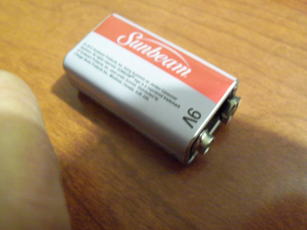

We woke up this morning all 5 smokers detectors appear to be beeping. Its not a continuous warning beep. Beeps are 1 single beep about 1 per minutes. Smoke detectors are wired to 120 vac with a 9v mercury battery inside. Volt meter shows all the mercury batteries are 9.3v and batteries are not rechargeable. In the past we have heard beeps like 1 beep per month or 1 beep per week or 1 beep per day. Name on the front of the smoke detector says, US ELECTRIC. After removing all the batteries, testing batteries and putting batteries back into the smoke detectors all beeping has stopped. ???
TV weather says, humidity is low, pollen is very high 100%. We have been having 25 mph gusty wind for 3 days. New house air filter in the AC unit. We have a swamp cooler on wheels that recycles house air to remove pollen that was running 2 days ago but not today.
All the beeping worries wife. House is not on fire, I wonder about all the beeping.???

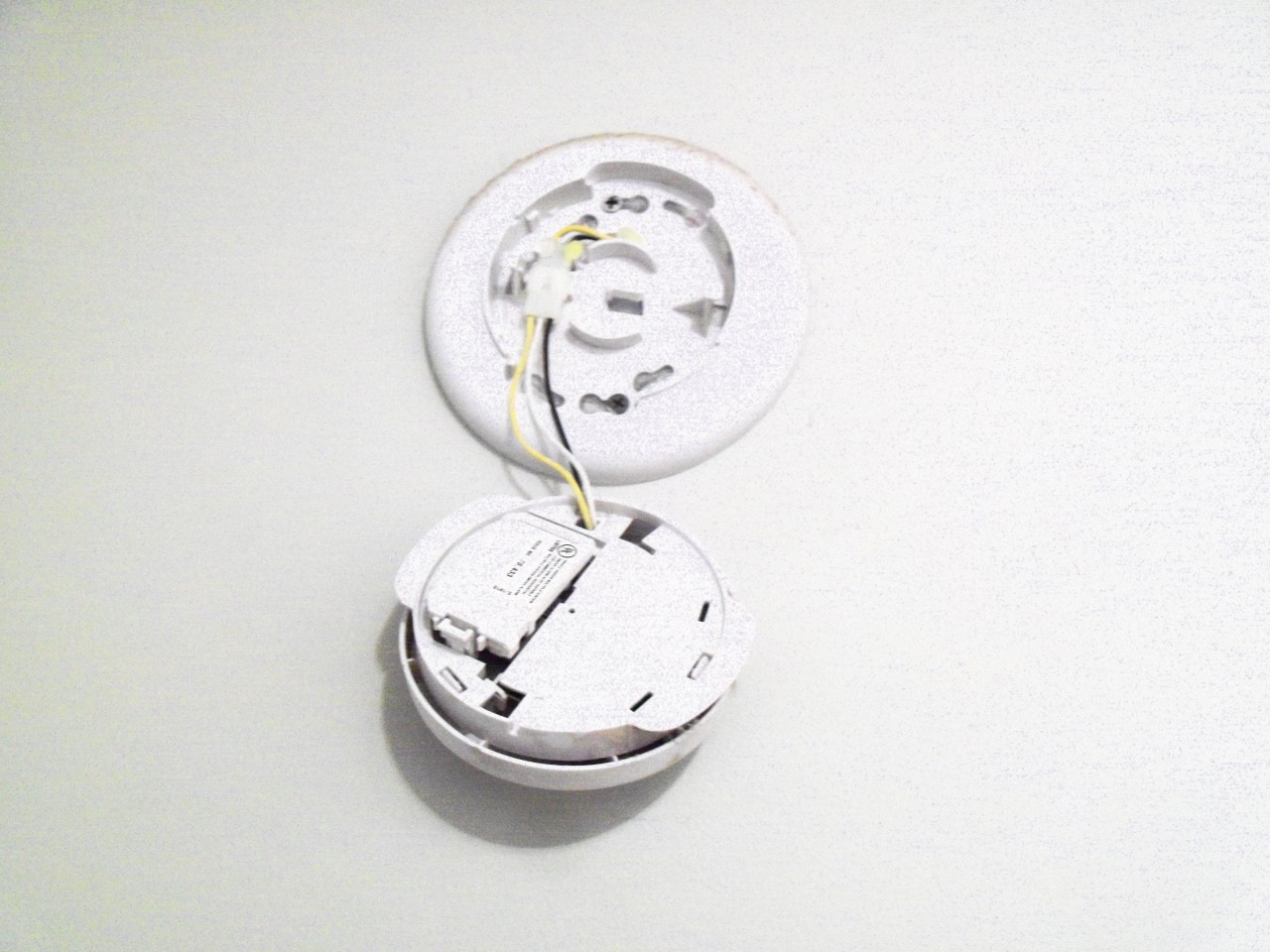

View attachment 149584View attachment 149585

There is smoke detectors with a battery as backup if the mains fail, as they are primarily powered by mains as the one in the first image appears to be (yellow, white, black wires from mains or link). Check a circuit breaker that supplies then or the chain wiring.
If one of the detectors triggers by any reason of failure, loose conection/splice, power loss, valid detection or unlinked, all 'daisy chained' will beep.
----> https://www.firstalertstore.com/sto...terconnect-hardwire-smoke-alarm-smi100-ac.htm

Hi G,
One beep may be a recognised error code, so as they are all joined, they will all do the same thing.
Can you check the mains power is getting to them?
