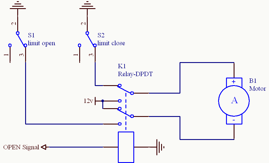

I envision a small hobby motor with perhaps a simple limit switch/polarity reverse, or perhaps a simple electronic control circuit.
Sounds good to me. Perhaps a relay to control the direction of the motor. See attached.

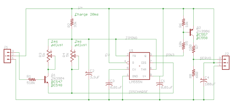

OK, I needed a servo tester and figured this would be a good project. Attached are .png schematic and Eagle files to make one. It assumes you have a robust 4.5-5.5VDC. J1 is the input, if you leave pin 3 open or low then R4 determines the initial servo position. Pull R1 up and the servo is set by R3 and R4 in parallel.
You can scale C2, R2, R3, R4 to convenient values: R2*C2 should be somewhere around 50ms. R3 and R4 (max value) around 5-10ms. R1 needs be pretty high; if too low it changes the period along with the pulse width. These aren't real critical, you can see I took a lot of latitude. The photo is of my working unit.
If your logic voltage is higher than 6V, change R7 so the output pulses aren't over 5V (some servos don't like that).
If using BC5x transistors, watch the pin out. It's opposite the 2N390x. (CBE vs. EBC)

Hi mneary,
here is a hint how to make the transistor and R7 value easily readable. Supposedly it's a 2N3906 and R7 is 10K?
Smash the part and move name and value to a vacant space. :D
Boncuk

Thanks for the reminder. I was so happy to finally get it working that I forgot to touch up the schematic. I'll correct and replace the files. You'll probably noticed that I moved some things on the layout after taking the photo. ;) Since I never do silkscreen the .brd was also full of labels on top of one another.
