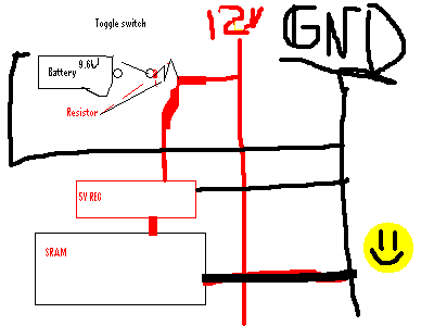

I have the datasheets for 8255 and the 6116, so it is easier to understand what you are talking about (eric). I am wondering though how I would put the SRAM in standby mode, aka hold the data (since it's static ram). What's the minimal amout of power can I feed it just so it hold's its data? The power to everything else will be off. I still want to feed it the 5V line when the entire computer turns on.
So I was thinking cannabalizing some of my 4.8V batteries (taking the plastic thing off) and making a 9.6V battery pack, that way I can put it parallel to the 12V line, so it charges the battery through a current limiting resistor, then the battery goes through a 5V regulator that will only be switched on when I am about to turn off the computer. Here's what Im thinking of in a paint schematic pain stakingly drawn :)

Can you get the LA version of the 6116. It is designed for data retention down to 2V with standby currents of less than 10mA.???
There are also non volatile Rams, with inbuilt battery and auto switchover at power down/up. Ref the Dallas range of ic's.

I will see if aussie has the LA series, but I want to stick to the 6116 :)
You should be able to back the data up in a 6116LA for several years with a pair of AAA batteries because the chip typically draws VERY little current (typ 2uA) in standby mode.

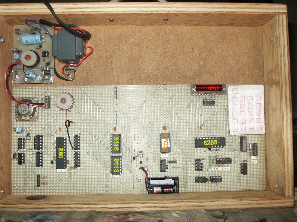

Nigel,
I checked my old Z80 project which I built in 1989. I think I have changed the batteries once or twice and the RAM data is still valid today! I'm powering two 6116's with a pair of AAA batteries:
