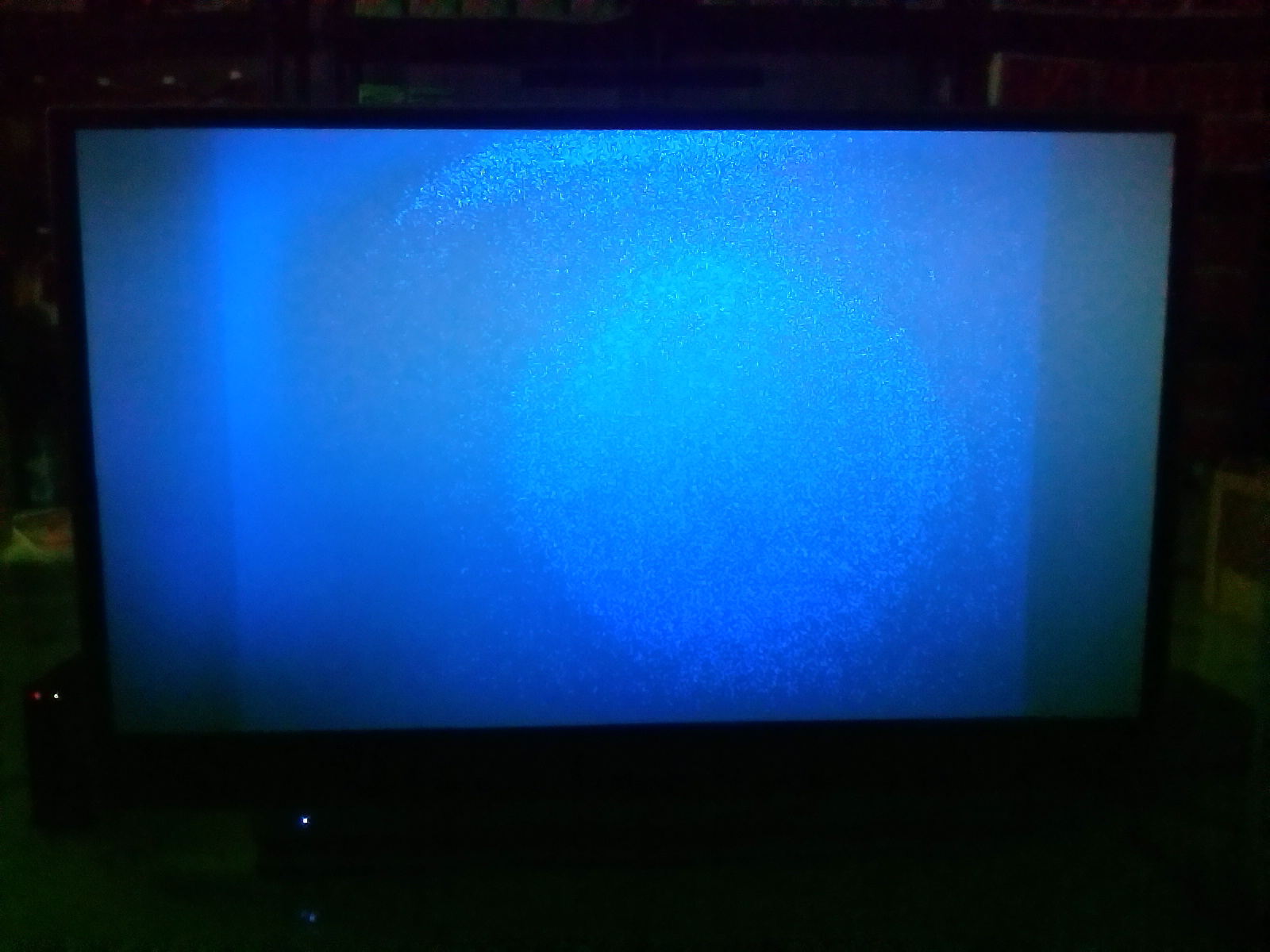

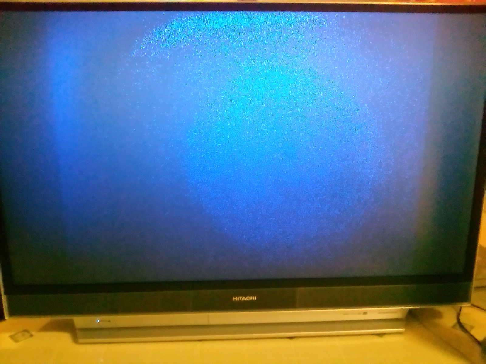

The issue is there is a lot of blue fog and a constellation of blue dots on the screen that is distracting to look at. The unit is out of warranty--about 12 years old. I am looking to repair it myself (DIY).
My research says that the blue dots might be a light engine issue/optical block problem, but there is a way to change out one (or more) of the colored polarizing filters inside the unit inexpensively. Do you know which color polarizing filter I need that would correct the blue dots/blue fog issue? I can't afford a new light engine given what I hear they cost ($500+), but the filter (~$30?) could be a good workaround.
I would be most appreciative of any help you can offer regarding this blue fog issue. Again, what color filter is causing the blue fog (I haven't opened the TV yet), who sells the replacement filters directly to the public, and do you have instructions on a first time repair attempt?
Here are two pictures of the TV and the blue dots/fog:

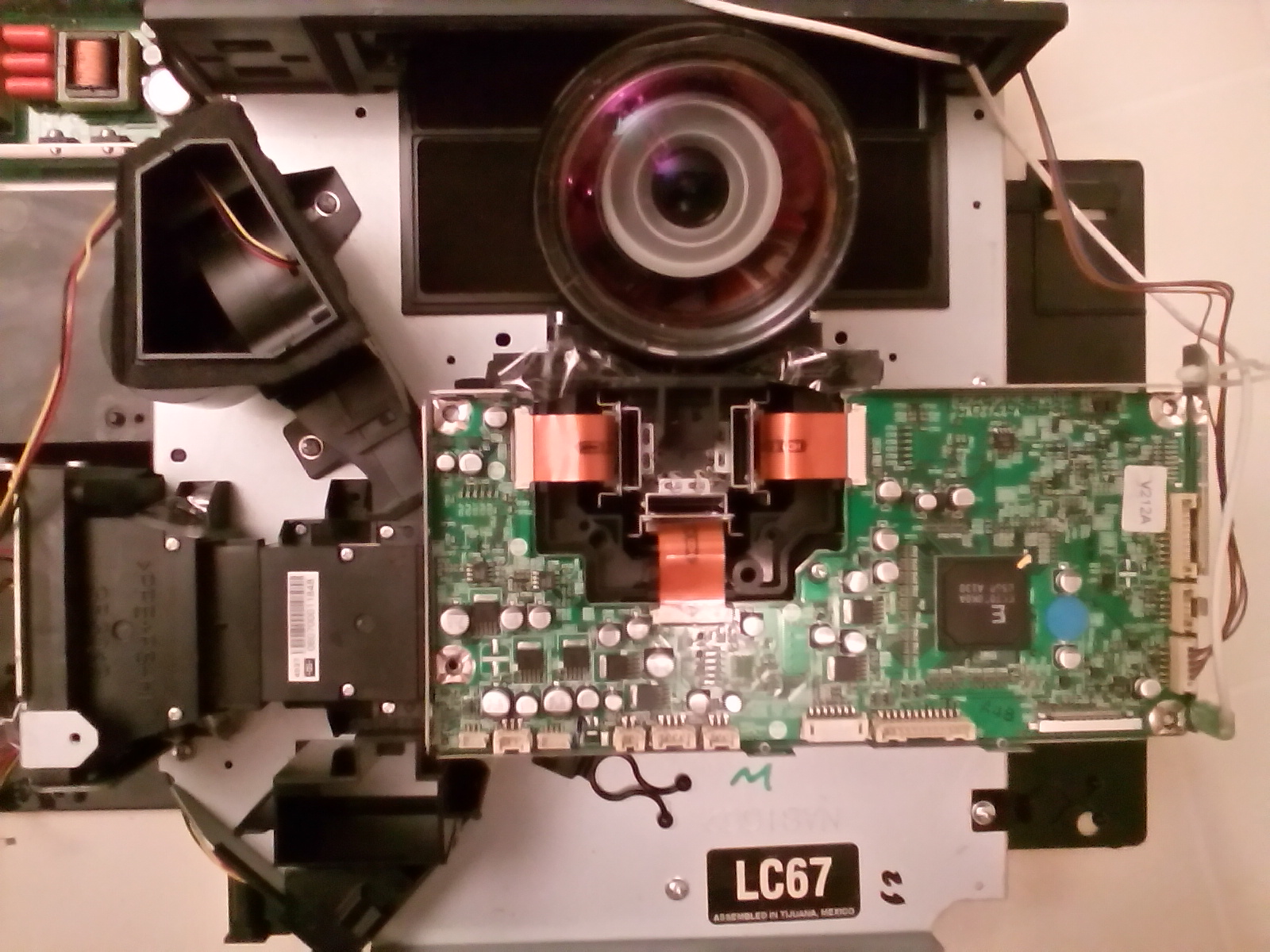

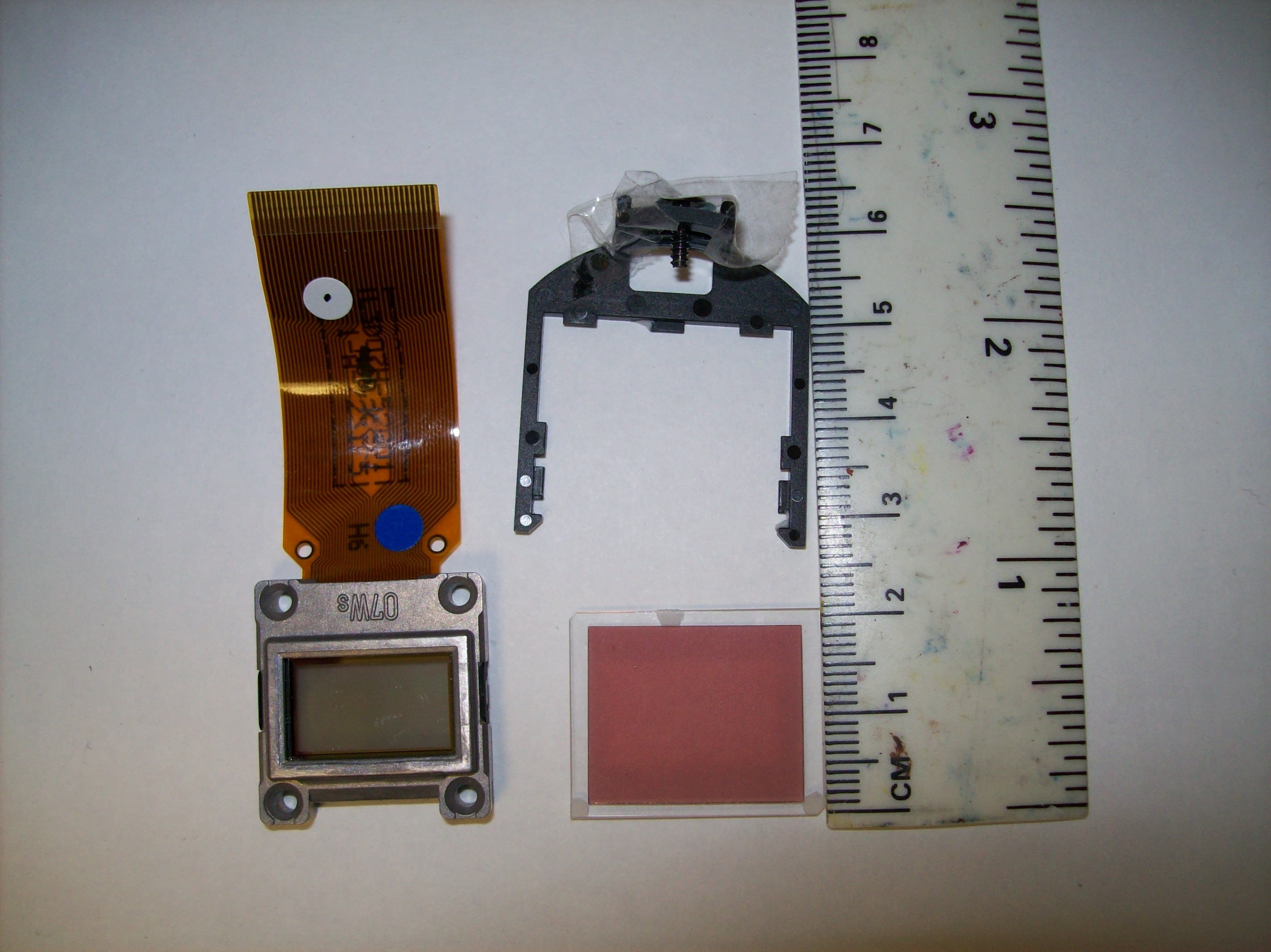

I currently have my Hitachi light engine disassembled (actual picture below), but I have to figure out how to get the printed circuit board off and get underneath it to take the LCD panels out (called the optical block?) and the polarizing filters. I will post pictures when I get to that part.
It seems like this issue is something that could almost be repaired inexpensively with 3-D filter glasses cut to size from the movie theater (but with high heat resistant glass, not plastic lenses) rather than replace the whole (now obsolete) light engine.
Does anyone know of any suppliers, companies, or individuals who could supply or fix the LCD panel glass and cut me some blue polarizer glass to fit the frame of the old, burnt blue polarizing filter? I can take it out and measure it. I have tried writing Lampdeng, a company in China that someone else had success with, but I haven't heard back from them. Thanks in advance!

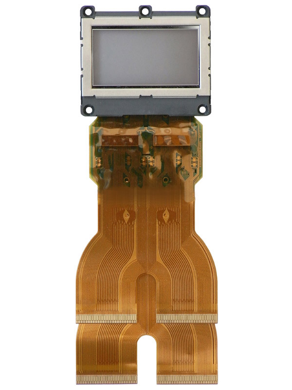

DLP and LCD are two very different technologies.
DLP uses an array of microscopic mirrors, each with its own actuator; the optics are in effect mechanical.
https://www.listeningpost.co.nz/assets/dmd_chip_125623_1.jpg
Colour typically uses either a rotating colour wheel, with an image illuminated sequentially as each filter is in line with the optics, or three DLP modules with individual R, G, B light sources & the images combined via prisms / mirrors.
If it's purely a colour filter that's damaged, can you use one from a different make?

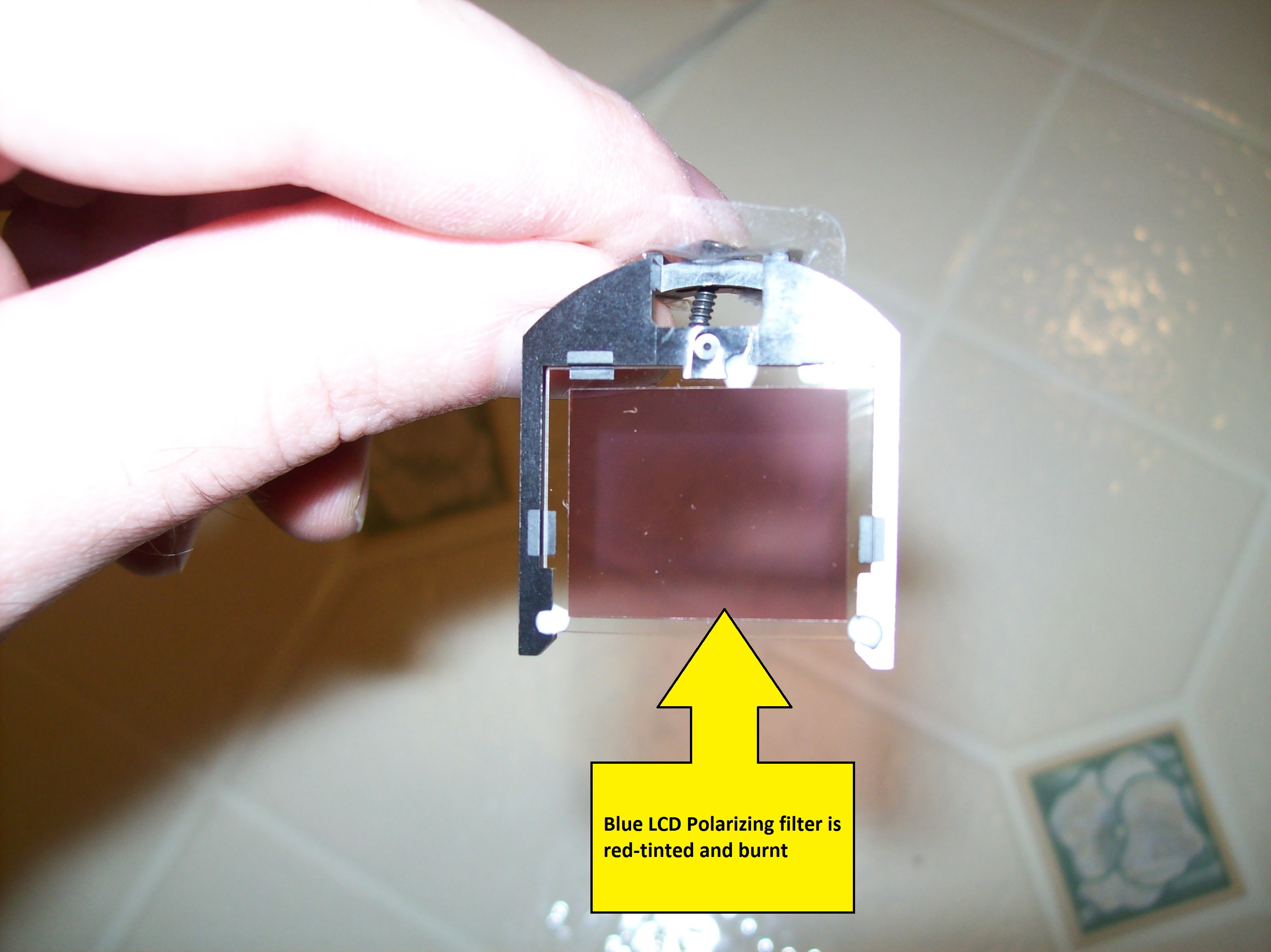

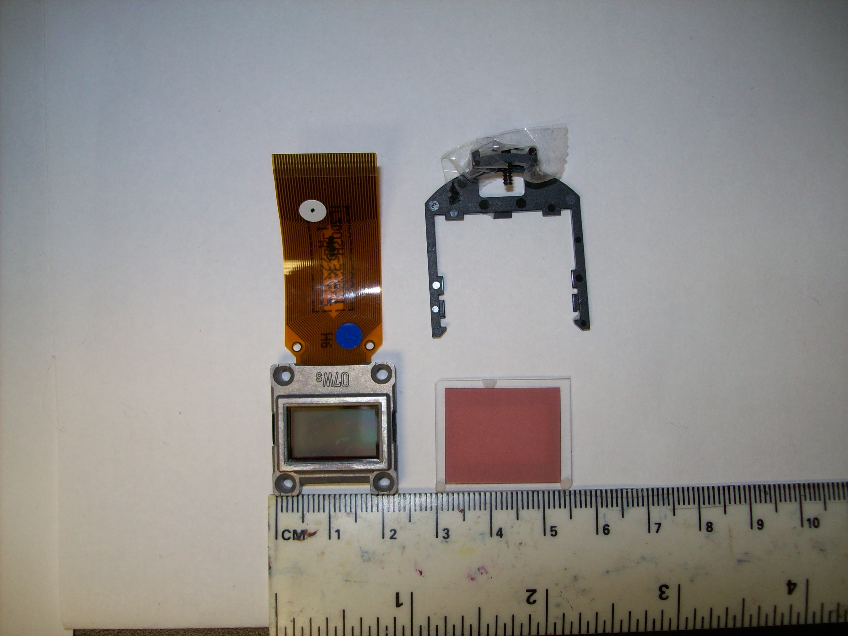

Each LCD panel has a different colored polarizing glass filter contained in a metal frame in front. I disassembled the unit further and found a blob on the blue LCD panel when held up to the light and major burn in on a "red" colored polarizing filter in front of the blue panel. The other two filters (for the red and green LCD panels) look fine. I disassembled most of the light engine and I did not find a color wheel inside, if that helps.

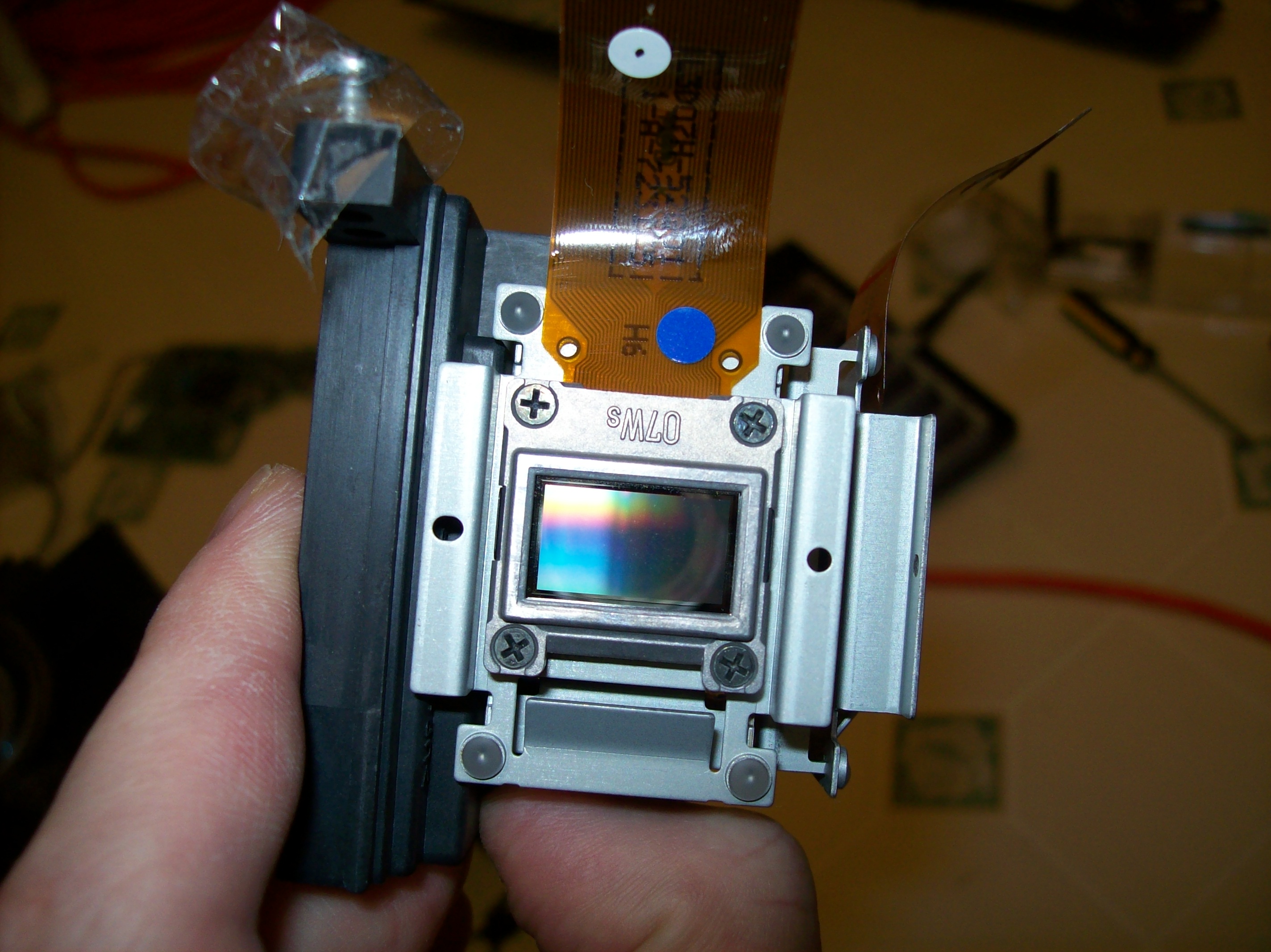

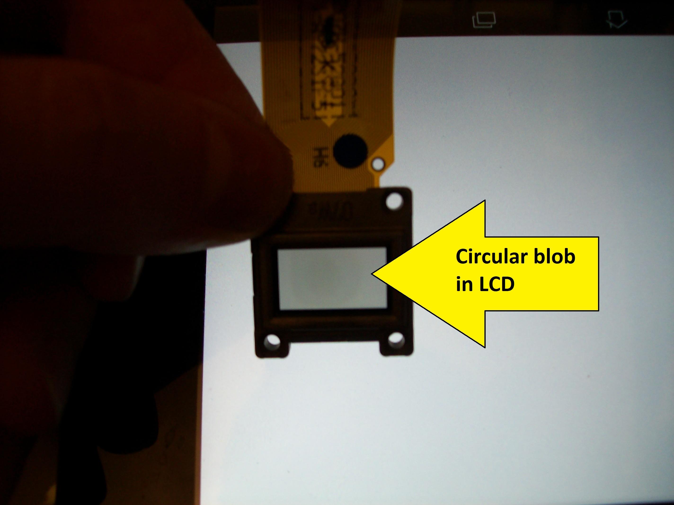

As mentioned, the blue LCD panel has a circular blob in it (hard to see), contributing to the bad picture:

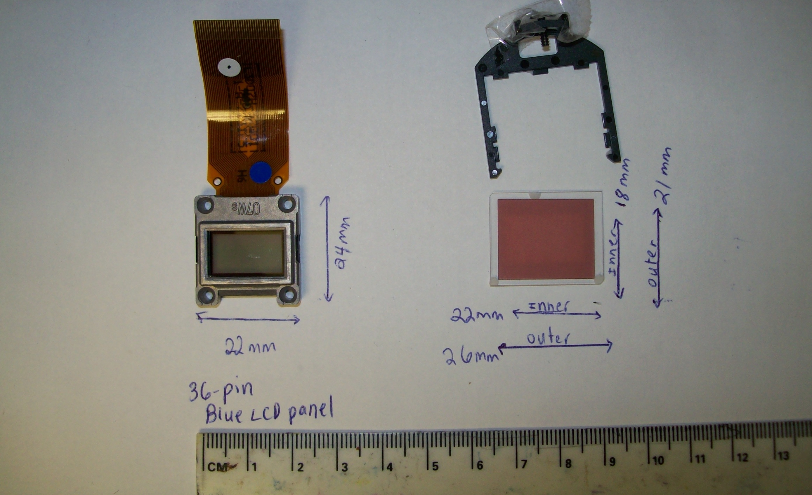

For the polarizing filter, I measured the plastic/glass in millimeters. It measures for the outer glass 26mm x 21mm, and the inner glass (the red tinted part) 22mm x 18mm. See pics below. A company in China called Lampdeng offers new polarizing filters, and helped someone else with this problem on the web, but I haven't been able to get in touch with Lampdeng. Is there anywhere else I can find a replacement or a scrap red colored filter for the blue LCD panel? I am assuming it has to be red in color. Here are pics:
burnt polarizer in front of LCD panel.JPG blue LCD and polarizer measurements 1.JPG blue LCD and polarizer measurements 2.JPG blue LCD and polarizer measurements 3.JPG

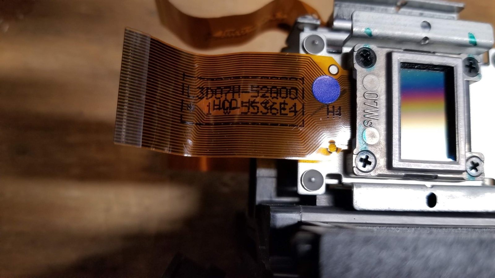

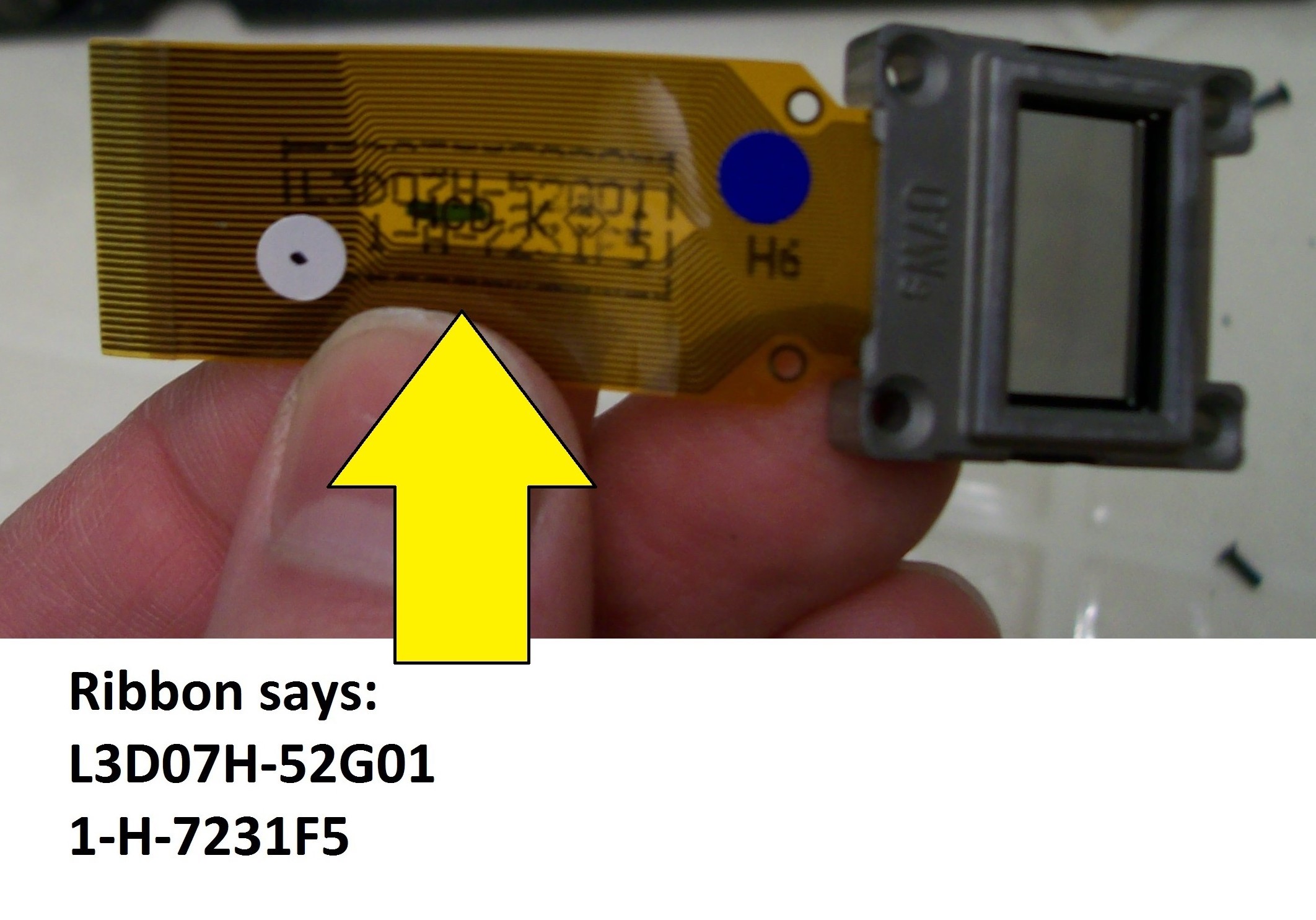

Lastly, I did find someone on eBay is selling this optical block from a Hitachi 50V715 he disassembled:
He sent me a close up picture of his blue LCD panel. Here it is, as compared to my blue LCD panel:
My panel: my bad blue panel and numbers.JPG His panel: replacement blue panel and numbers.jpg
Does anyone know if this Hitachi 50V715 blue LCD panel would be compatible with the main electronics board on my Hitachi 50VS69A projector (I noticed there are the same 36 pins on the ribbon cable, and most of the numbers on the cable are the same)? It's the closest match I have found. It would be great if it worked. I asked the seller, who said that, honestly, he does not know if it is compatible or not, as it has been some time since he has had to service Hitachi TVs and he does not know if they are compatible from one model to another.

OK, that's LCD not DLP.
It uses separate LCD modules for each colour with fixed filters, so no colour wheel.
The spare LCD in the photo is probably compatible; the main number is the same, at a guess the second section is a revision number - yours is G00 and the spare looks like its G01 ?
Re. the colour wheels on ebay, I was thinking that if it did use fixed filters for colour separation, the segments of one of those may be suitable material for repairing the old burnt ones.

rjenkinsgb - Thanks for the clarification that it's LCD and not DLP. Based on your assessment that the part would be compatible, I am going to take a gamble and buy the part. The optical block also has an internal filter behind each colored panel that I am hoping is the same size as my external "framed" filter. I am planning to disassemble the optical block to get at this internal filter.
