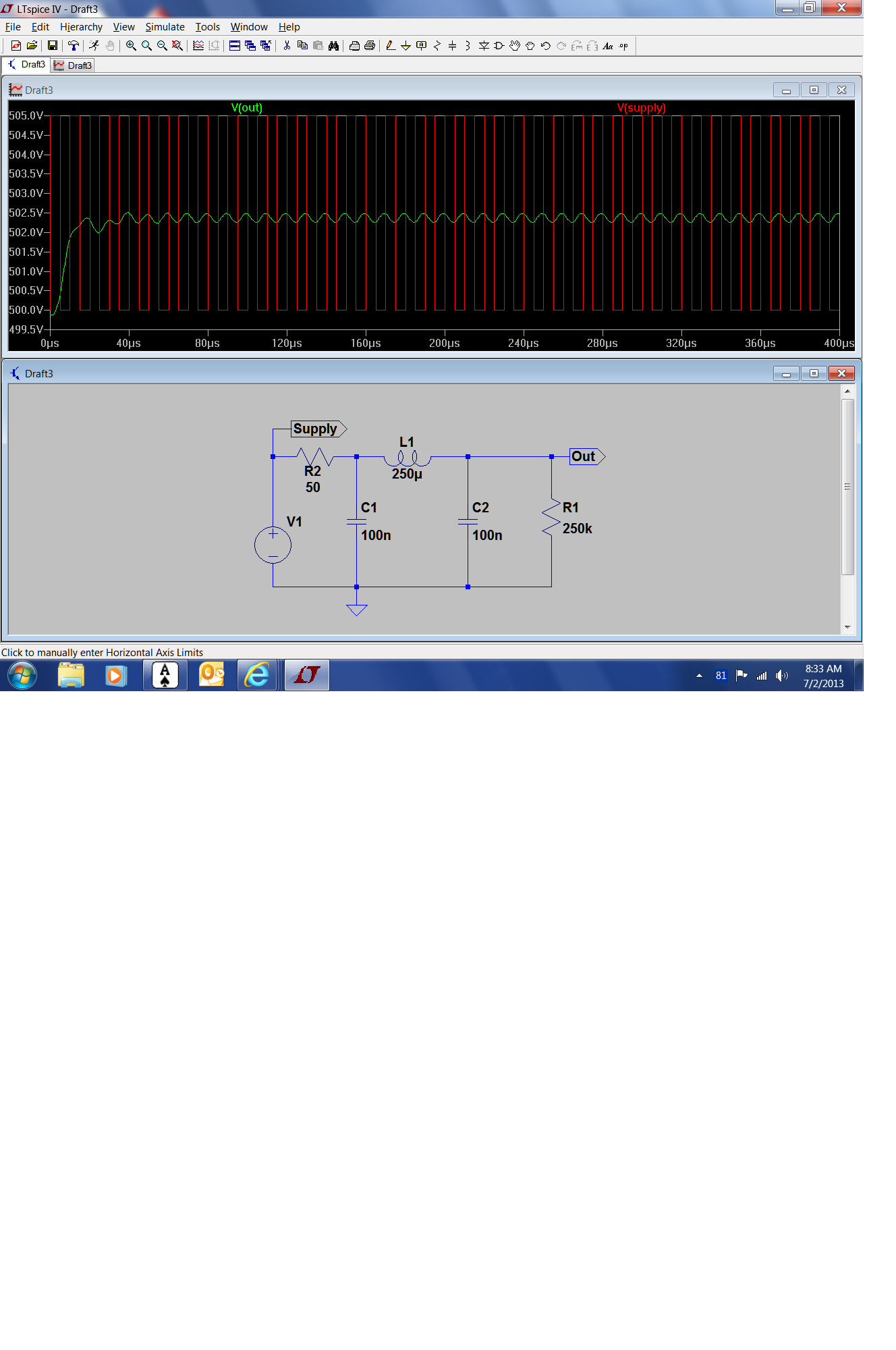

Here is a filter that should knock down the ripple. It's a little hard to say because the supply already has a filter, but it might be worth a try. Just a little resistor sized inductor should work.
The 12 volt supply looks pretty good with the 120Ufd at the input to the HV supply, but if you like you could use 2 in parallel.
Thanks for the schematic, currently my HV output looks like below. Should I add your components in addition to those or just add only the inductor?
You should take out your resistor and cap and replace it with the circuit above.

You need to remove the 50 ohm resistor R4 as it would load down your supply.
You don't show what your input power supply is (12 volt), but if all it runs are these 2 supplies you would probably be better off without the diode or input resistors. In any case 100 ohms is way to big. (.1 amps X 100 ohms = 10V) If you want to use the diode because of high ripple from your bulk supply the cap needs to be much larger - say 6800 Ufd. so it can supply the current between ripple peaks. But unless there are other loads causing ripple on the input you would be better off just adding the extra cap to the supply and leaving out the diode.
R4 is supposed to be 250K as you had in your circuit above, just forgot to change its value. The input is 12V DC regulated supply and the outputs are HV (0-500VDC Regulated) and +/-5V 1W isolated Murata power supply. I will make the changes to the circuit as you suggested and test it. I had the diode just for reverse polarity protection.

Sorry, my bad.:eek: I put the 250k in to simulate the load. You should leave it out as it takes all the supply current.
Sure, ok the diode & caps are fine. I think it will be as quiet as a mouse. :rolleyes:
