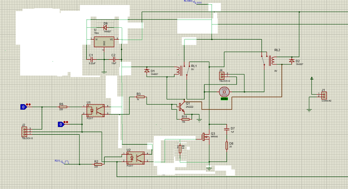

Hello.
I have created a schematic for a high power dual h bridge utilizing relays and IRF540 Mosfet but i cant seem to calculate the values for the gate resistor to the mosfet plus i would appreciate if anyone could point out any mistakes i made in the design. The schematic is attached below in the zip. The design is for two motors which needs to be PWM'ed , with operating current of about 1.5A No load and Stall current of 14.5 A. This is one side of the h bridge for the full schematic open the zip.

Welcome to ETO.
Your schematic, as drawn, is a very bad example and very difficult to read.
Many tangled wires, unnecessary bends, and just plain difficult to read.
A good schematic should be easy to read and show what the circuit is doing without having to untangle a spider web of lines.
I suggest that you redraw the schematic and re-post it if you want anyone to analyse it for errors.
To help you re draw it, I have done some basic editing to make parts of it easier to read.
I suggest you redraw the whole schematic in a similar style.
My edits:
Just a comment, with a 5V supply, and triggering through an optoisolator, you will not have enough voltage to turn on the IRF540. It needs almost 10V on the gate to be fully on.
The logic level 540 might work (IRL540 series). At a 4V gate, its RDSon it 0.11 ohms.
Since the MOSFET is a voltage triggered device, you probably don't need a gate resistor, it does not draw any significant current.

Thanks for telling me that. I have changed it like JimB said. The problem I used to have was that when i had not grounded the 2n2222 BJT with the 10k resistor and trial tested the circuit it went up in flames. i then read some where that i have the saturate the BJT to that it has the least resistance and doesnt heat up, How can i do that.
Thanks for telling me that it seems to have gotten past me when i looked up the datasheet for it. I also wanted to ask you said that mosfet gate does'nt draw current but the gate of the mosfet when uncharged acts as a capacitor which will draw a large amount of current so in order to limit that i need a resistor in that place. I wanted to know if you had any idea how should i choose the resistance
The gate resistor should just limit the charge or discharge peak current to whatever the drive circuit can safely provide.
If it's only occasional on/off switching, it's generally not critical as components have time to cool between switching events.
That becomes a very different situation if you will be using PWM, you then need a proper high-current gate driver or buffer circuit of some sort.

I would be using this mosfet for PWM as it will be used to sink the current to ground after passing through the motors. So could you refer to me about i should go about making a high current gate driver or a buffer circuit
What are you trying to do? Your optos are wired as emitter followers which will reduce the base voltage on the 2N2222. The opto LEDs are also rated at 50mA continuous, assuming 5V in (you don't say) your LEDs are only getting ~20mA.

Or, the simplest buffer is just a PNP and an NPN transistor, both arranged as emitter followers with bases and emitters connected, something like a crude Class B audio amp. With suitable devices the gate drive can be increased by 50, 100 times or more from a simple logic-level signal, but you lose out on the voltage "swing" at the gate as each transistor drops about 0.6V before conducting, so 1.2V less out than in.
Also note that you need to be careful in selection of the opto isolator for PWM, as many common types are rather slow turning off and may not work well or not at all at high frequencies.

,The optos will be used to switch on the relays and mosfet when the input is high, they would be powered by 5v

I much appreciate your help. As for the PWM i would be giving it a signal from a Arduino Mega which works on a operating frequency of 490Hz if i remember correctly so would it be slow enough that the opto PC817 won't have trouble matching its speed
OK, that is quite a fast opto, so it should be OK as long as the load resistance is not too high; 1K would be idea, it gives a reasonably fast recovery & makes it usable with full output up to around 5KHz, according to the data.
Note that you also need "flywheel diodes" to prevent back EMF spikes from the motor causing damage.
The simplest setup with an H bridge config is to use four diodes in a bridge rectifier style configuration, with the AC connections to the load (motor) and DC to the incoming supply positive and negative/ground.
Use fast recovery or schottky diodes, and make sure you have a decent size capacitor across the incoming supply, for energy recovery. Power will be regenerated from the motor if you reduce the drive duty cycle faster than the more decelerates - active braking.
(You could use a single diode between FET drain and positive power, but that would not provide protection to the relay contacts or from spikes going more negative than ground; the four diode bridge covers everything).
