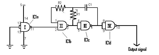

Hey, I'm attempting to build a high frequency variable oscillator on a range of 18 MHz to 48 MHz(preferably 48, but 42 would work if 48 is too high) using the 4011 quad NAND. I want it to work on the circuit that I'm posting, and I just need the values for C1, R1(pot), and R2(pot). Id like it if only one of the resistors was a Potentiometer, but if it cant cover the entire range, I would use 2. Can anybody help me out?
I mean, this cct can work up to 10..15MHz only. For higher frequencies build one with BJT or FET.

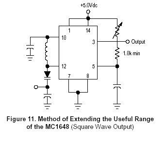

This cct can work safely on 10MHz, but need 15V supply. Some good pieces work up to 15MHz. I strongly recommend the MC1648 for wideband tuning.

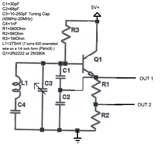

With C3=250Pf, the frequency is 20 mHz. With C3=10pF, the frequency is 45 mHz. A tuning capacitor from an AM radio would probably have that range.
V1 is the 5 volt power supply but supply voltage is not critical. L1 is 7 turns #20 enameled wire on a 1/4 inch form (a standard pencil will do). The turns should be close and don't forget that the leads are part of the inductor, so keep them short.

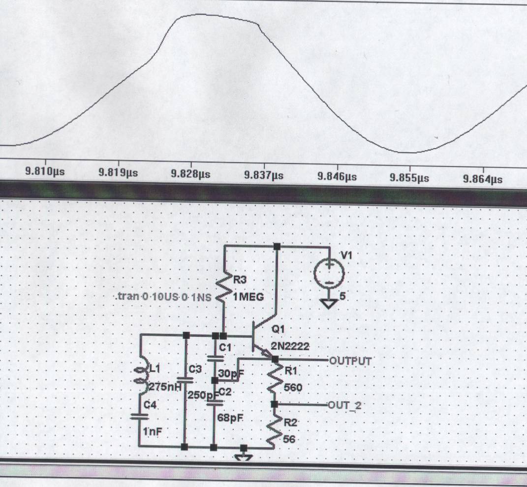

Thanks. I have changed the pic a bit. Would this still work? Also, what is the difference between the 2 outputs? Could Q1 be substituted for any other transistor? Why does L1 say 275nH (what does it mean)? Did I mention, "Thank You"?
I had used this circuit as a crystal checker (substitute the crystal for L1, C3 & C4). Out_2 was a 50 ohm drive to my frequency counter. 275 nano-henries is 275*10^-9 henries. Any transistor with Ft greater than 100 mHz should work, eg: 2N3904.

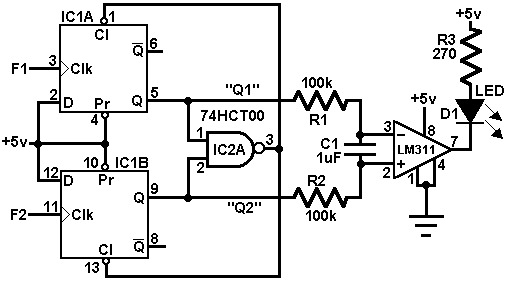

Does anybody know a cheap circuit that I can add on to one of the outputs to compare that clock to an existing one and light an LED when they are the same?
