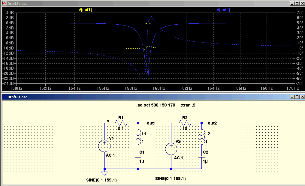

What about a different configuration? When I look at the schematic of a series resonant tank circuit, I do not see the load current passing through the filter. IOW it only needs to be rated for the relatively small quantity of HF current, not the 50/60Hz. An array of such, providing overlapping low Q's, might serve my intended purpose.

This shows the important effect of different series resistance (impedance) values in the path from the supply to the 'filter'. I made no attempt to tune the LC circuit to any specific frequency; the principle is the same for any frequecncy.
For 0.1Ω assumed source impedance there is virtually no attenuation at the resonant frequency, whereas for 10Ω (much higher than a house wiring system should have) there is ~22dB attenuation. Clearly, as has been said above, you need to pass current through a high-AC-impedance series component (i.e. huge choke) at the house mains input to get any significant filtering.
