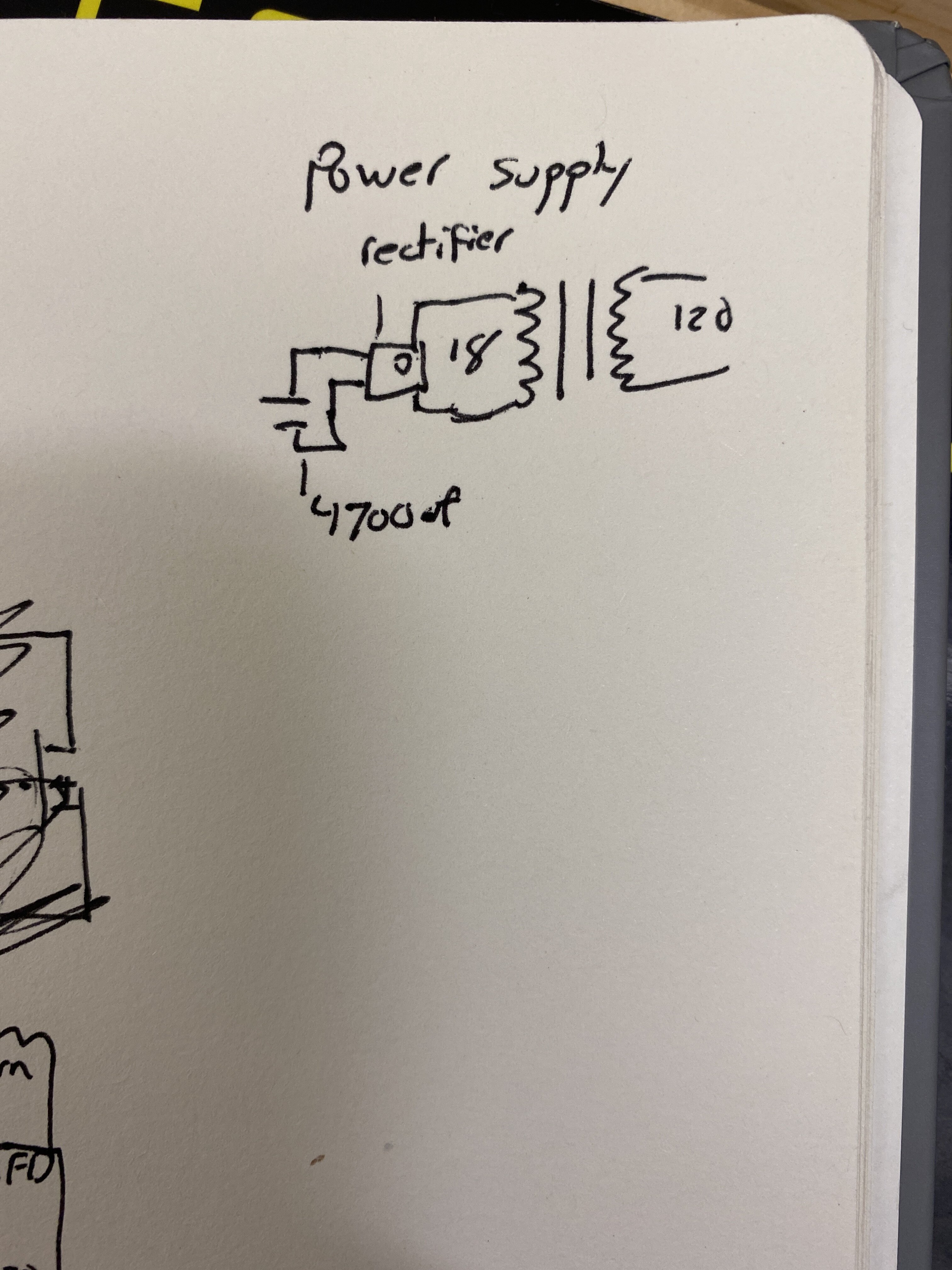

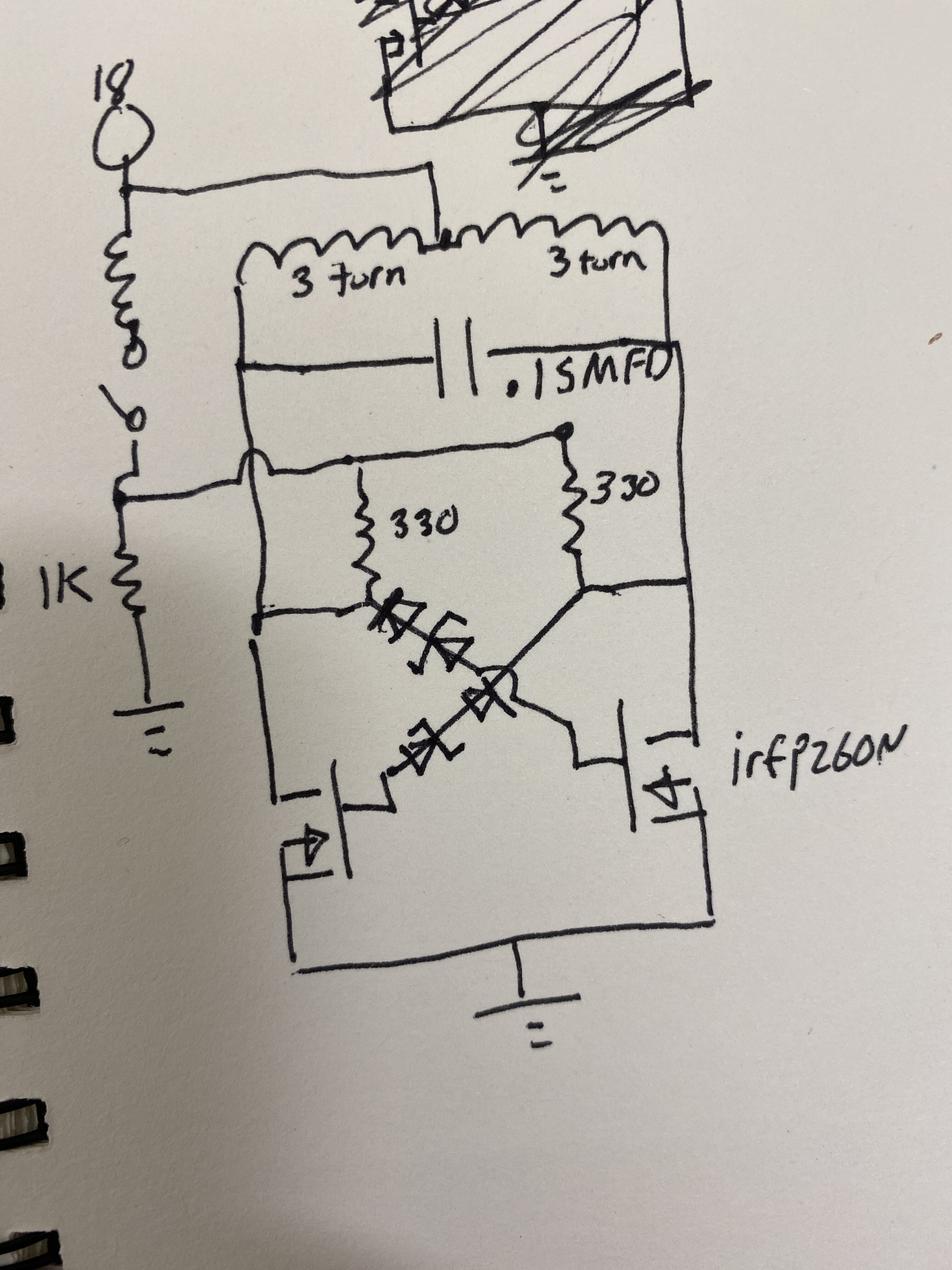

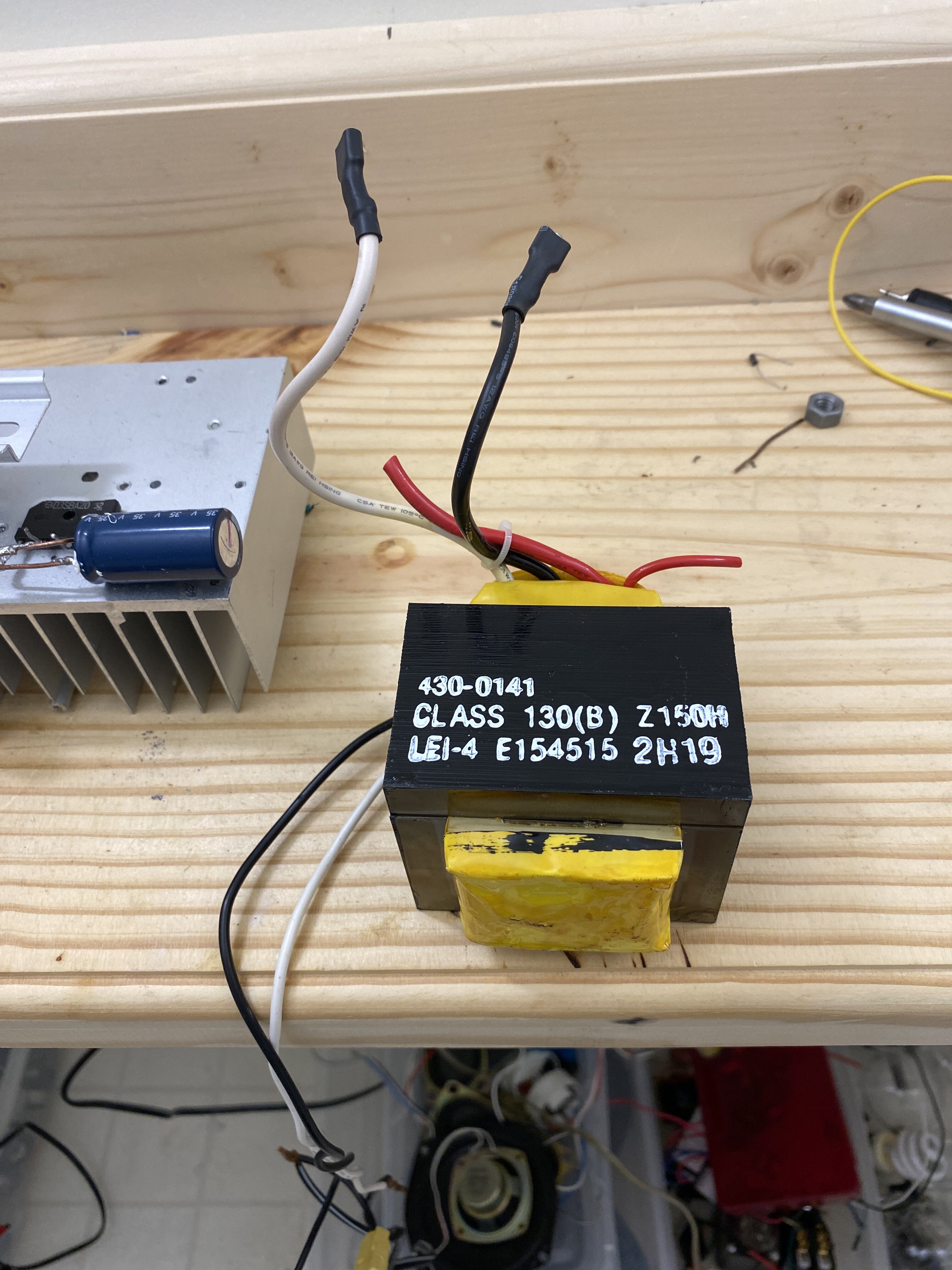

Hi everyone, recently I thought I’d pick back up my ZVS circuit. I’m using two irfp260 mosfets as the current switchers and here’s a quickly drawn schematic below.
It works pretty well so I decided to make a decent power supply to go with it. The only problem is it has eaten through two rectifiers already.
Any suggestions on how to fix this?
