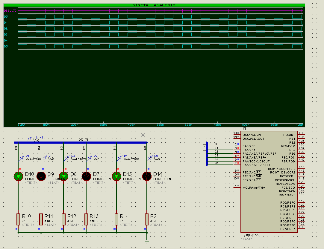

now, going to back to the comments about incorrectly configuring the port. here is a quick run that blinks the LEDs on Port A configured as analog input.

as you can see, because analog pins are read as zero, LED=~LED; does not work anymore. But that's not the fault of the code, it is the fault of the programmer not reading the datasheet, not understanding the datasheet and failing to set up the port correct (analog vs digital).
this has nothing to do with multiplexing but has everything to do with incompetent programmer.
