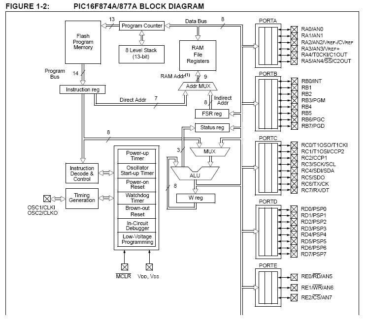

this whole thing really gets me intrigued about this chip.
here is the block diagram and it shows adc on PORTA, and pwm/spi/i2c/uart on PORTC.
if ever we ever had the problem with incorrectly configuring an "analog" port and not being able to set it low, shouldn't that problem show up on PORTA instead?
what am I missing?
now, I would really love to see how be80be did it on PORTC but managed to get PORTA to defy the datasheet.

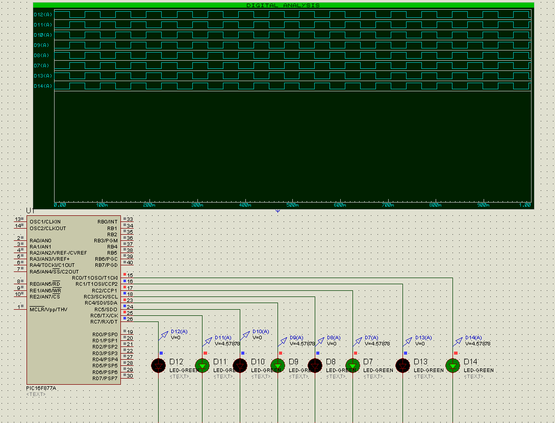

you are mad because you didn't understand what was going wrong with the program.
the reason PORTC isn't working is that upon power-on, TRISC is set to 0xff. That means all PORTC pins are in DIGITAL INPUT.
it has nothing to do with being "analog mode" - that could have been the right argument for PORTA which does have the adc on.
all of that are in the datasheet, which you clearly haven't read, or couldn't comprehend.

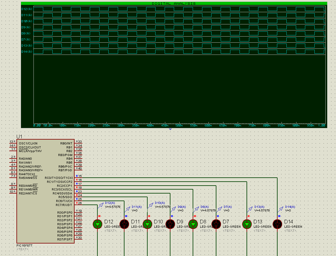

I was so curious that I tried this on my own computer.
16f877, picc-lite, hi-tide ide.
#include <htc.h>
//hardware configuration
#define LEDC	PORTC
//end hardware configuration
//configuration bits
__CONFIG( XT & WDTDIS & PWRTDIS & BORDIS & LVPDIS & WRTEN & DEBUGDIS & UNPROTECT );
void init_mcu(void);
void delay(int dly);
void init_mcu(void) {
//up on power-on, porta set to analog input.
	TRISC=0b00000000;	//set all pins on port C as output.
void delay(int dly) {
	for(;dly>0; dly--)
void
main(void)
	init_mcu();
	LEDC=0b10101010;
	while (1){
		delay(500);
		LEDC=~LEDC;
		//TODO Auto-generated main function
here is what it shows in simulation. as you can see, the LEDs did blink, and the logic analyzer agrees too, :).

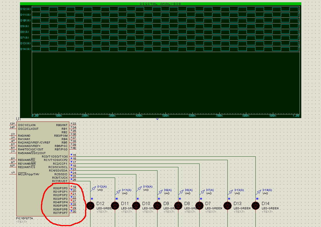

Let's get this strait the poster has a 16f877a I did read the data sheet.
bingo!
the big give-away is how he set the adcon/cmcon registers for port a.
But either way, that has no impact on port C, which is where you guys thought his problem was.
here is the same code running on port C of 16f877A.

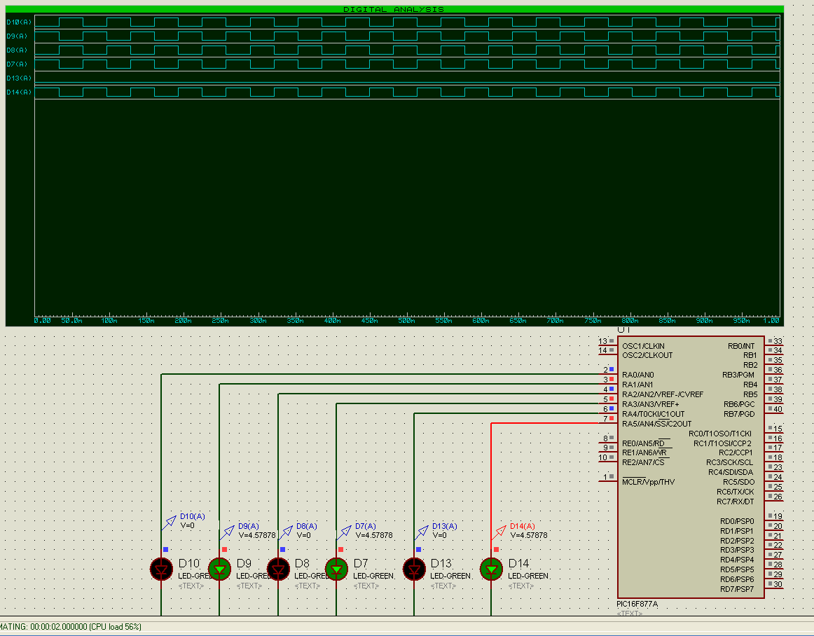

how about blinky some port A? :)
#include <htc.h>
#define LED		PORTA
	ADCON1=0x06;
	TRISA=0b00000000;	//set all pins on port C as output.
	for(;dly>0; dly--)
void
main(void)
	init_mcu();
	LED=0b10101010;
	while (1){
		delay(500);
		LED=~LED;
and simulation with updated traces on the logic analyzer.
