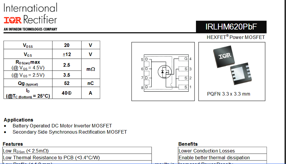

ronsimpson. Thanks buddy, one of those peaked my interest.. but im lacking enough knowledge to know if the gate voltage suits my needs.

I think you only have about 3 volts to drive the gate of the MOSFET. That is not good. Looking at the SUM110P04-04L, you need 4.5 volts min. 5 volts is better.
Look for a "logic level" part.
Just picking a part at random.
N-MOSFET, turns on with lower gate to source voltage and 0.0025ohms.

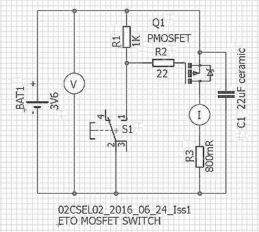

GWI, do you agree that this is the topology that you want (don't worry about the circuit details for the moment)
spec
THIS SCHEMATIC OBSOLETE- REPLACED BY SCHEMATIC OF POST#35
NOTES
(1) R2 is a gate stopper to prevent the PMOSFET from oscillating.
(2) C1 is a ceramic capacitor with an X7R dialectic.
(3) R1 is 1K, rather than 15K, to present the gate of the PMOSFET with a low impedance and also to put more current through the switch to keep the contacts clean.
(4) The nominal terminal voltage of a LiIon battery is 3.6V rather than 3.7V
(5) The star after each component name has no significance

After looking at the math involved I have to say, rather you than me! haha. That would be very kind of you, thanks.
*Just saw your next post.. err.. umm.. err..
I could tell you all about fabricating car components and maybe wiring the headlamps, but I couldn't tell you I know how that circuit works :( if it puts the most power reliably to my heating element and my readout works then yes, that's perfect..
I followed it far enough to assume r3 is my kanthal resistor, s1 my switch. The way the mosfet looks alien to me but that's no surprise, I'm used to seeing the actual wires etc.
If that's, in your professional opinion, an efficient circuit I'd be more than happy to use it. You wouldn't happen to have the part numbers of the components would you?

The Infinion IPB80P03P4L-04 (TO263 pak or any other pak) will be fine for your circuit and will not require a heatsink provided it has a free flow of air around it.
Take the maximum current as 6A for round figires. With -3V gate voltage the RDss will be 10 miliOhms max so the the forward voltage drop across the PMOSFET will be 6A * 10mR = 60 mili Volts. The power dissipation will thus be 6A * 60 mili volts = 360 mili watts. The thermal resistance junction to case to free air is 62 deg C per watt which means that the thermal gradient will be 360 mili Watts * 62WDC= 22.32 deg C. The maximum junction temperature is 175 deg C so the maximum ambient air temperature is 175 deg C- 22.32 deg C = 152.68 deg C.
In practical terms, assume an ambient temperature of 50 deg C, a good assumption for many equipments, then the junction temperature will be 50 deg C + 22.32 deg C = 72.32 deg C, well within the IPB80P03P4L-04 specification maximum junction temperature of 175 deg C.
The safe operating area graph from the data sheet shows that at 4.1 V (LiIon battery advisable maximum charge voltage) there is absolutely no problem with a drain current of 6A.
Unless I have made some gross error somewhere, the IPB80P03P4L-04 will do your job with ease without any heatsink at all.

Yes, that is correct. R3 is your kanthal resistor and S1 is your switch. When S1 is open the PMOSFET drain source will be open circuit. When S1 is closed the PMOSFET will be short circuit.
Yes, the circuit in post #12 will put the maximum current into your kanthal resistor.
Yes, that is the circuit that I would recommend.
I will sort out a parts list for you. Do you have a preferred supplier: Mouser, Digikey, RS, Farnell for example?
