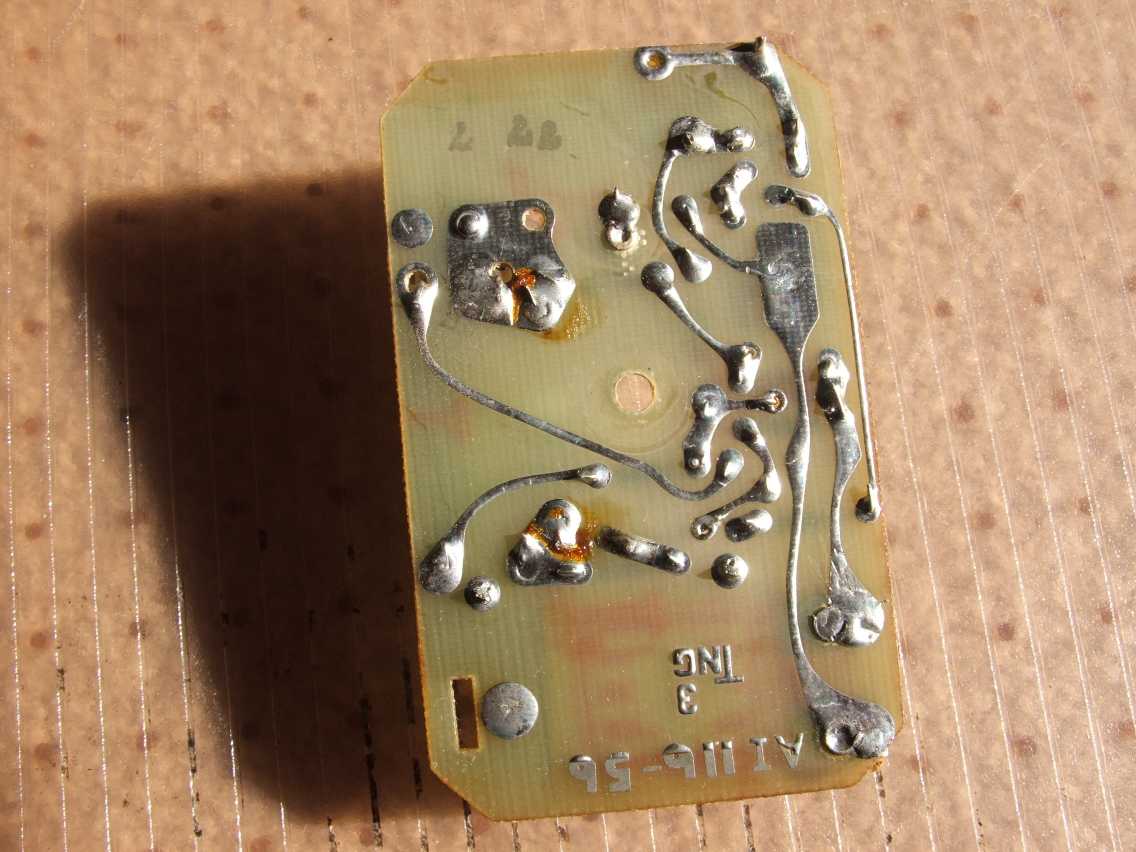

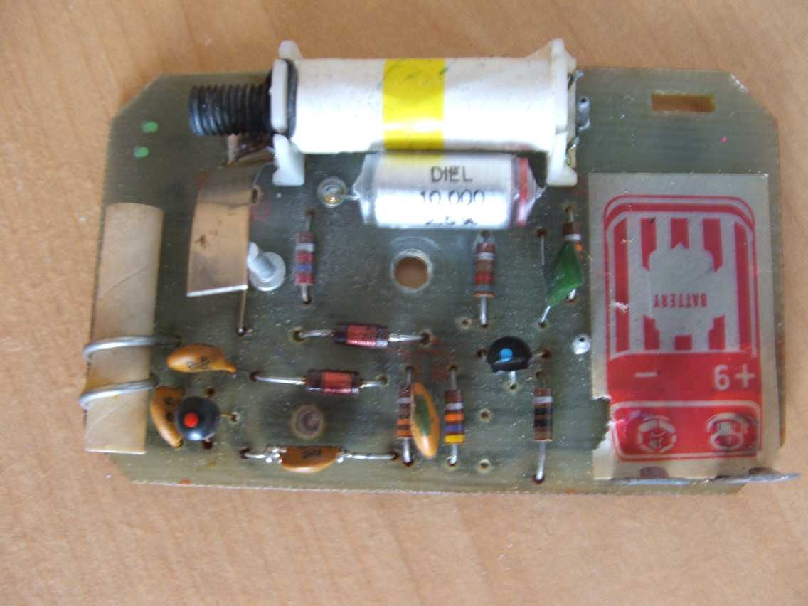

I have a very old garage door opener remote. I would like another one, haven't looked for a genaric replacment yet, but the "build one" idea came to mind when I saw how basic it looks inside.
I have limited RF experiance. I love radio, but haven't got to building any radio circuits yet.
Questions - Is this flat out dumb idea thats just going to be frusterating? Or is it doable?
What freq. do these things generaly operate at? The PCB is kinda sloppy compared to current standards. Can I assume its somwhat low freq. from that? Khz? low MHz?

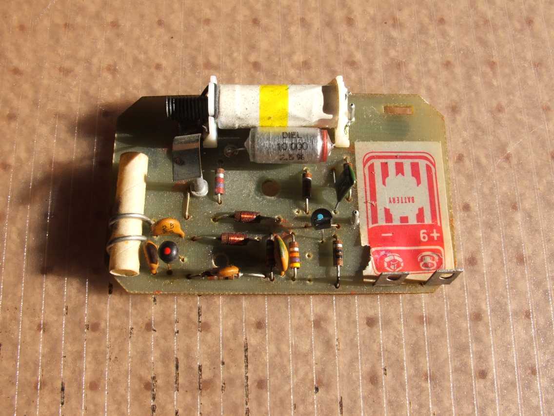

What are the things that look like diodes wrapped in fine wire? (in picture 3 they are below the big silver coil)
Lastly - how does this thing work? Don't most modern remotes use a code of some sort? This looks like a crude transmitter that is tuned with an adjustible inductor?

Actually this is a very do-able project. The remote usually includes only two basic stages, a code generator (or tone generator), and a simple RF oscillator. The RF oscillator usually operates at about 315 Mhz but I have seen a few in other bands. Yours looks like the 315 Mhz type, based on that little coil in the corner. These oscillators are easily tuned to frequency by bending the oscillator coil (squeezing turns together or spreading them apart. In the ones that I use, the oscillator is turned on and off in sequence by a simple digital serial code generator (in other words, they use Pulse Modulation). This code generator, usually an IC, uses the code setting on a multiple DIP switch to generate the serial code. Looking at the photos of your unit, I don't see the usual digital code chip and dip switches. The one in the photo may be modulated with a simple audio tone or something like that. I'm puzzled about the purpose of the large tunable inductor, but it appears to be coupled with a polystyrene capacitor so I'm guessing this is the tone generator and it is tuned by adjusting that inductor (or is it some sort of variable resistor?). Perhaps the tone is in the ultrasonic range, which keeps the L or C values smaller.
Although the circuit is simple, the problem you might have is that you need some way of testing that it is operating, some other way than the garage door receiver itself. RF guys usually use instruments like spectrum analyzers or test receivers for this kind of thing. The best second choice is to have an FM or AM receiver that can tune to 315MHz. Can you borrow something like that? It is frustrating trying to make RF circuits without some sort of way to look into the circuit, and often an oscilloscope just won't do. The spectrum analyzer is the tool of choice.
Those little things with the fine wire are RF chokes, basically just inductors with fairly high values of inductance, sometimes built around a resistor to de-Q the choke.
I agree, this is the crudest one I've seen. Check out that on/off pushbutton switch!

I did a little poking at it with my scope the other night. On one of the leads coming off the big tunable indutor, I got a nice clean 15 kHz sinewave. I'm guessing that would be the tone? 15khz?
My scope only handles 60mhz, and I don't have access to a spectrum analyzer or any reciver that will recive 315mhz.
I get an odd looking trace in other parts of the circuit with my scope. Maybe due to the lack of bandwidth?

It just occurred to me that your transmitter doesn't have any code setting switches. It is probably just CW with maybe a continuous modulation (15 KHz???) to keep your door from going up and down everytime someone else operates theirs.
