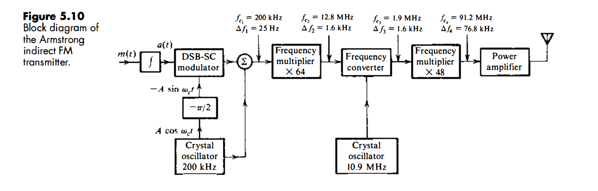

Perhaps the thing you mention is this. Yeah I have no idea to construct a circuit like this. PLLs like CD4046 generate square waves. I can think of an way to use digital ICs to do these functions but I don't know how it can be done for a sine wave. Multiple analog multipliers like AD633 would be expensive. I assume cheap stuff just uses microprocessors to approximate this stuff. I guess an Arduino can do it with the fraction of the cost if it can operate at high frequencies.
This is a full package for FM transmitter.

You're not understanding what the textbooks are saying - a frequency mixer can be as simple as one diode, or one transistor (as used in almost all domestic radios), 4 diodes is a common double balanced one.

Yes I can not comprehend how that could work to multiply the frequency of a sine wave. Ok I now remember the circuit you probably mention. But no textbook of mine explains the circuit diagrams behind those operations in detail. Do you know one that specially explains the operation of these types of circuits instead of the theory.
