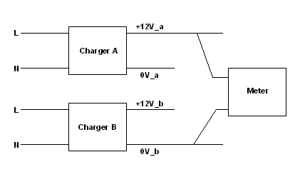

If you are sure that the outputs are completely isolated from the mains input, (they probably are) then your circuit is correct. Go for it.
Plug in two of the chargers and measure the voltage from the positive of one charger to the negative of the other, if it is zero then you're good to go. Any reading above mVs is a problem.

When I said about testing between two chargers I meant without any batteries connected.

Much appreciated Mike, but I'm a little confused as to checking to see if the chargers are bridging if there are no batteries in the circuit. Could you clarify please mate.
If the chargers aren't isolated then the neutrals are probably connected, if this is the case then measuring from the positive of one charger to the negative of another should read 12V.
A pic to show what Pommie is suggesting:
