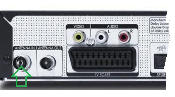

I don't watch much television, but wife was getting a bit annoyed with TV freezing momentarily , so I sprung into Mr Fix-it action. TV is hooked up to a Humax 2000 DVR box , and one of the connections seemed to be a problem,,, 3 screws later I expected to see a dry joint... or similar ... Not a lot inside to eyeball ... Turns out the loss of signal was just an opened up sleeve in the coax female socket...
so 10 second fix... all :)
