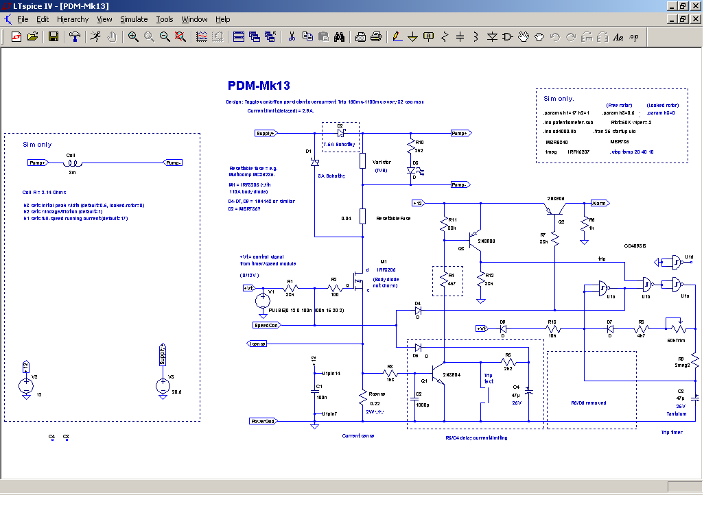

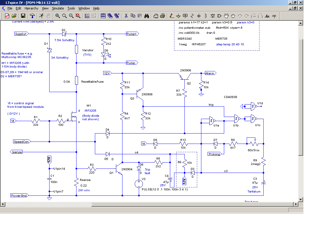

My copy of PDM14 drives all pumps reliably. I have PDM13 saved in my documents and I'm going to read through and find what changes were made to PDM13 to make PDM14. The only changes that I remember is swapping a cap for a resistor and seperating signal ground from power ground. Anyway, it'll probably take a few days for me to sort this out and get clean copy of PDM14.
Mk14
This is what I have for MK14.
Also added what I have for 13.
Thanks for posting those ron; I'm still having problems uploading images. EM is looking into it I hope.
