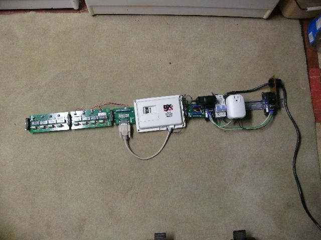

Attached is an example of a DIN rail system that I started to put together for a home project. This is basically a long piece of DIN Rail, 2 PC boards with relays. A PC board with a wire to a connector, an RF receiver module. An alarm/alarm silence PCB, 3 DIN Rail mounted breakers and some DIN rail mounted outlets. An X-10 interface, an Insteon and UPB interface.
The plan is to separate it into smaller sections, rather than one long section. It does have one bad design flaw. The relays will effectively be connected directly to the house infrastructure and to the outputs of the RF module.
If the relays have to be replaced, then the wires would have to be removed from the terminal blocks and from the RF module. A total of 13 wires. I didn't design the relay modules. I would use screw terminals that plug into a header.
Do you get the idea now?

So, after a good night's sleep, tell me what you think of Snaptrak. But if your talking about my picture of the long gismo, that is things mounted on DIN rail and no Snaptrak devices are used. You really don;t need the Snaptrak itself, if you can use the clips from WINFORD, but you still have to keep the width reasonable.
In a typical control panel (I wish I could find a pic of one of mine) you place ROWS of DIN RAIL and between the DIN RAIL you place Wiring Duct such as this: https://www.asi-ez.com/member/x1654-Wire-Duct.asp so now you have this big Electronics erector set
This pic https://www.alarmsaf.com/ps12408.html , although it doesn't look like DIN rail to me, it very much could be. Those last two rows of stuff could be mounted on DIN RAIL. I just don't think it is.
In general, though the cabinets are purchased with an Aluminum back plate, typically 1/8" thick. Anything mounted to the plate gets mounted via drilled and tapped holes.
The rails and the ducts add lots of flexibility within the cabinet.
In some cases, the enclosure contains a few relays and fuseholders and a barrier strip. If the case is big enough, the use of just the DIN terminals (labeled) would really make it look much neater. Suppose that as an example, there were two fuses for 240 V and a main power relay and a few interlocks, such as pressure, access panels and a few spares. There might be a N, L1, L2 and G terminals coming in and fused L1 and L2 terminals leaving. Then there would be a nice row of say dual terminals for each interlock. There would also be bussed L1, L2 and N bars available. It would look nice an be easy to troubleshoot.
