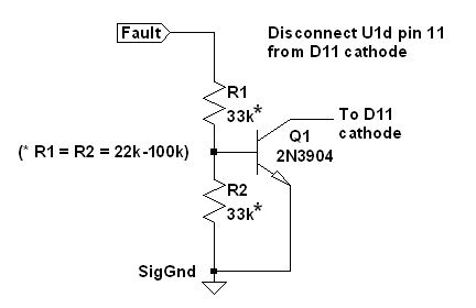

Replacing the whole IC in PDM 13 avoids any uncertainty about the operation of the three assumed 'non-faulty' gates (U1 a,b,c). But if you wanted to bypass the one suspected faulty gate (U1d) with a band-aid approach here's the band-aid. Only one connection (at D11 cathode) needs to be broken and three new connections made.
Thanks , I think I'll replace the whole IC. The difference in time spent would be minimal versus the bandaid. Other than PDM 13 not responding to lost power, the entire system is fabulous.
