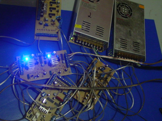

I hooked up the battery backup system and it worked from the getgo, including the filter pump delay timer. :D The LED, (D10) is on solid, and only when in battery backup mode. :D
The trip test works in both PDMs, but the LED in the alarm module did not light up. I assume this is because there was no 12V hooked up.
My DMM showed 11.25V at the '12.6V' terminal point with the power supplies plugged in and 10.92V on battery backup (PSs unplugged)
Not the best pic, I wanted to show off the pump leds . Just seemed like a pic was in order.
The next pic will be the entire system and I'll try to make it neat and tidy. This is truly an amazing system, I can't thank you guys enough.
