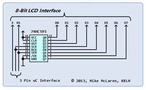

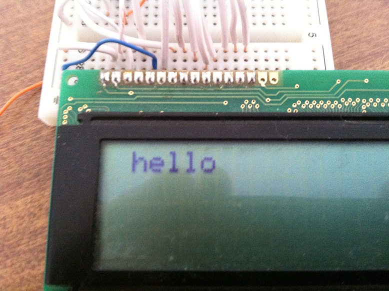

Good luck on the '595 interface, Aaron. If you're interested... here's something I just came up with that borrows from Raj Bhatt's adapter where he uses the SCK and RCK pins tied together on the '595 to form a 3-pin microcontroller interface.
This LCD interface concept uses the HD44780 LCD "8 bit interface mode" which means you only need to fill the 74HC595 shift register one time to send a single byte to the LCD. Of course since SCK and RCK are tied together on the '595 you actually have to clock out nine bits of data in order to get eight bits of data onto the '595 outputs. However, if our driver sends the RS bit as the ninth bit and leaves RS on the SER pin when it strobes the LCD E line, we should be in business.
Let me know if you'd like to see an assembly language driver?
Cheerful regards, Mike
k8lh-3-pin-74hc595-lcd-8-bit-mode-backpack-jpg.69752

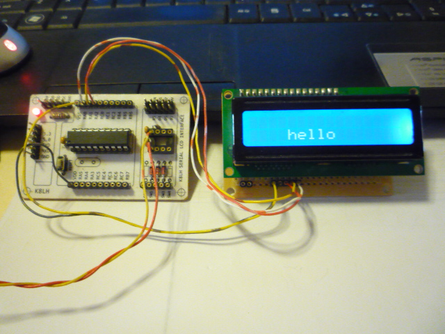

Please. I've been writing but not succeeding. Comparing mine to one that's working, should show me where I'm wrong.
Thanks Mike
Does that design require filling the shift register six times to send a single byte to the LCD? How long would that take, 4-5 milliseconds?
No, you only have to send the 7 data bits followed by the final "latch" bit, to send 1 byte.
But you made a good point it is not that fast, for worst case with the RC values I used in the kit it takes 45uS*7 for 7 zero bits, followed by 500uS for the latch bit. Total time 815uS to send the byte. Fast enough to update the LCD multiple times a second.
You misunderstood but I looked at your shift-1 software and it clearly shows that you send four bytes to the 74HC595 in order to get one byte to the LCD... (1) send upper nibble with E high, (2) send upper nibble with E low, (3) send lower nibble with E high, and (4) send lower nibble with E low.
Ok, so multiply that 815uS by four to get a complete command or data byte to the LCD and it can take several thousand microseconds worst case. As long as you know about that ahead of time, you should be able to work around it for all but the most demanding applications.
Well, I don't have a way to test the driver at the moment so I can't claim it as "working" but maybe I can breadboard it sometime soon. The driver (below) uses 16-bit core (18F') instructions so it would need to be modified for use on 14-bit core (16F') devices.
I'd love to see someone get this interface running...

Thanks, Burt. That's very kind of you. Hope you're feeling better soon.
If it helps, here's an untested program for an 18F14K22 (that's what I have here). It simulates ok but it will be awhile before I can breadboard the interface to test it. I wonder if I need to preload the 74HC595 with '0' bits when the program starts up?

BTW, the 74HC595 based design is really just a derivation of an old design that used a 74HC164 shift register (see drawing below). If you're not locked into using a 74HC595, there may be a couple advantages using the 74HC164 version of the interface. Software for the 74HC164 version is exactly the same as software for the 74HC595 version except that the 74HC164 version doesn't require the ninth clock pulse. Also, the 74HC164 comes in a smaller 14 pin package.
74hc595-8-bit-interface-png.58547

Mike the RCLK SRCLK pins are what you have as LAT CLK right ? In post 25 I'm using that SCH
Hi Burt. Sorry so late.
The program and logic diagram in post #25 go together. I updated the drawing with pin numbers.
Yes, LAT = RCLK = ST_CP and CLK = SRCLK = SCK = SH_CP, etc. Modified drawing below...
I'll take a look at your program listing momentarily...
74hc595-8-bit-backpack-png.69715

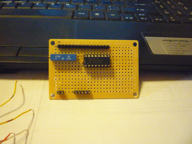

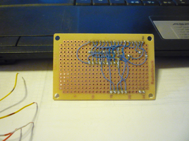

It's not working the code looks right in mpsim but on hardware it's showing boxes
I wish I had a logic tool that could read all 8 pins on the lcd but I don't but give me a week or two and I will.
I can't see any thing missing the 595 is working I can watch 4 pins. My sugar messed up make's it hard to sit and read code.
Well Im sure i found the problem I have a bad pin on my 18f1220 I guess i wore it out lol.

Aaron,
I built a prototype this morning and it came up first try (I love it when that happens). Anyway, here is picture proof that the K8LH 3-Pin 74HC595 LCD 8-Bit Interface Mode Backpack is a "working" design. I'm using the 18F14K22 program and schematic from my earlier post. The circuit includes an LCD contrast pot and a 100nf bypass cap which are not shown on the schematic.
To recap... The backpack uses three I/O pins from the uC and drives the LCD in 8-bit interface mode. It's pretty darned fast, too, since you only have to write one byte to the 74HC595 to get one byte into the LCD.
Please let us know how it's going.
k8lh-595-8-bit-working-jpg.69722
k8lh-595-8-bit-proto-front-jpg.69721
k8lh-595-8-bit-proto-back-jpg.69720
74hc595-8-bit-backpack-png.69723

It worked for me to in sim I check the pic I was using and I'm not getting any output on AN2 it's blown. I should of used a new chip this one had tested God only knows how much code I've programmed in it.
That was driving me crazy I couldn't see any thing wrong with the code it looked great it sim great.
I had it wire as you showed the dang AN2 pin is dead on my test PIC 5 years of changing code killed it LOL

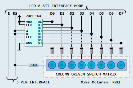

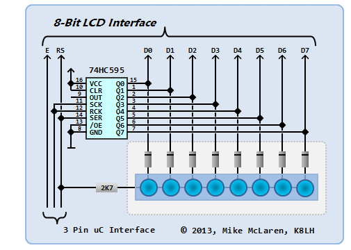

Now I have to be dumb. In your '8 bit LCD Interface' schematic, I thought I figured out what the section in the lower right corner was(that shows up in blue). But I don't see anything like that on your board. So, 1st of all what is it? and
2nd is it in your board or is it not needed?
Aaron
Burt
I'm going to try your code modified for 1220 on one of mine. Thanks
Hi Aaron,
Sorry for the confusion. The schematic you're referring to shows how to add push button switches to the backpack. My prototype does not have any switches (they're not needed). Here's another version of the schematic without the switch option (bypass capacitor not shown);
Regards...

It's your Code, I just changed the code for a 18f2550 and set Hello on the first line.
It would of worked on the dang 18f1220 but it had A bad pin on porta.2 it cant putout power.
