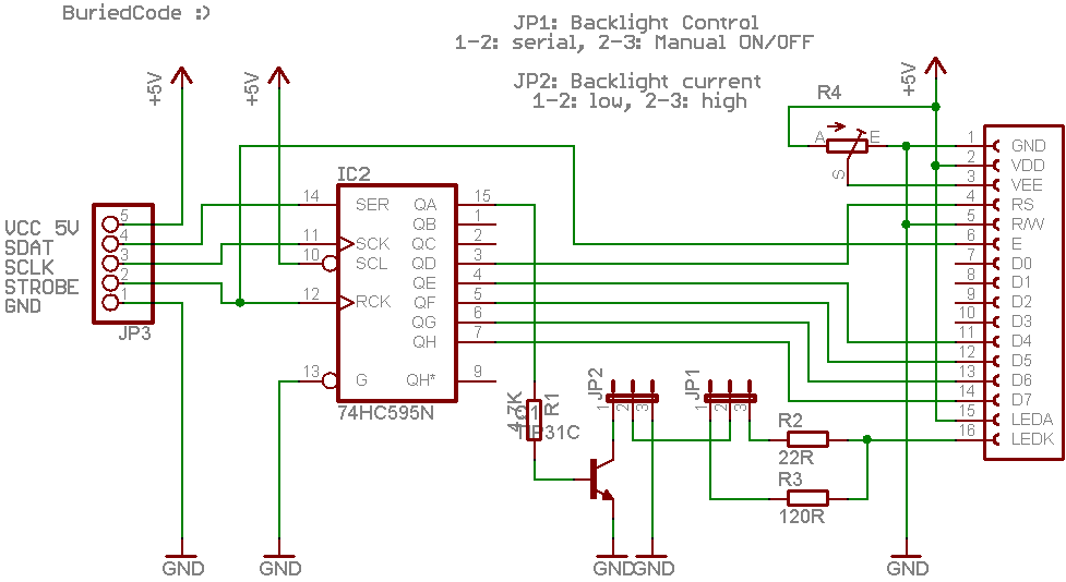

Hi Aaron,
Do you have a link to the 2008 thread, please? Do you know if anyone has a working interface based on that schematic?
Hi Aaron,
Thanks for the link. Unfortunately I just don't see how that circuit could work since an RS signal level change through the '595 would not meet the tAS timing spec in the Hitachi HD44780 datasheet. Basically, unlike the LCD data lines which must be setup before the falling edge of the E strobe, the RS and R/W lines need to be setup before the rising edge of the E strobe. However, in that circuit an RS signal level change wouldn't show up at the LCD until after the E strobe rising edge.
If Blueteeth is around, maybe someone could ask him if that was a working circuit or just a concept?
Regards, Mike
There noway that could work and the code for it would be a nightmare If it did. Mike post the one you did with the new little pic
It's a way better setup.

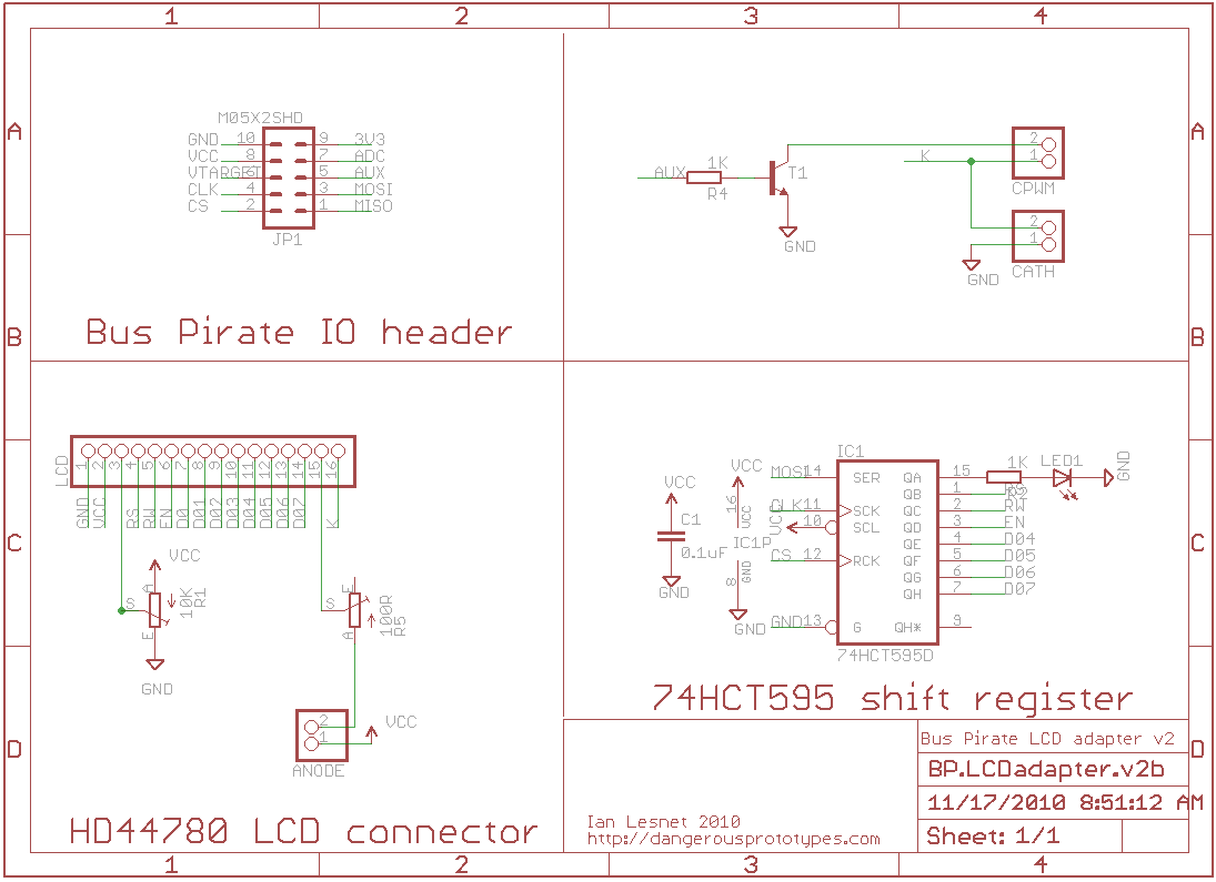

The one from DangerousPrototypes would be the best. The pins are in logical order
I agree but it also requires the most work from the software (you have to fill the shift register six times to write a single byte to the LCD)...

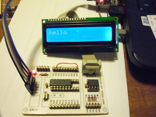

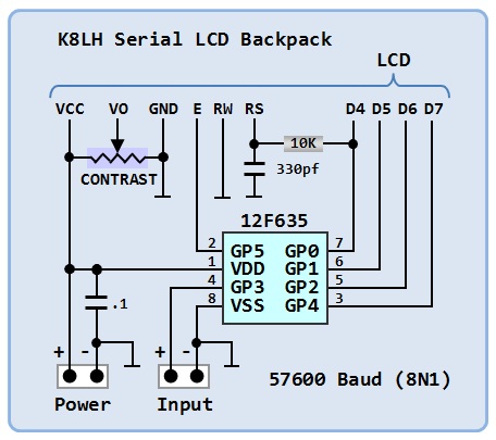

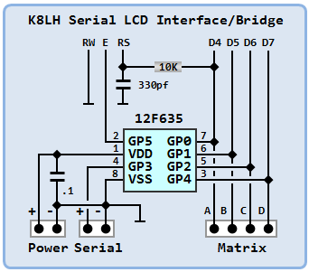

Please don't dismiss languer's suggestion for an "intelligent" serial LCD interface/backpack too quickly. While only requiring 1-pin for a serial interface is an obvious advantage, the cost savings in terms of code overhead on your host project shouldn't be overlooked. For example, a well designed intelligent serial LCD backpack should initialize the LCD to Hitachi HD44780 specs', which can save quite a bit of code space on your host.
In addition to the very nice serial LCD interface example provided by languer, here's another simple and relatively inexpensive serial interface example (below) which could be made into a tiny backpack or included on a project or development board;
Cheerful regards, Mike
10k-counter-concept-jpg.69676
