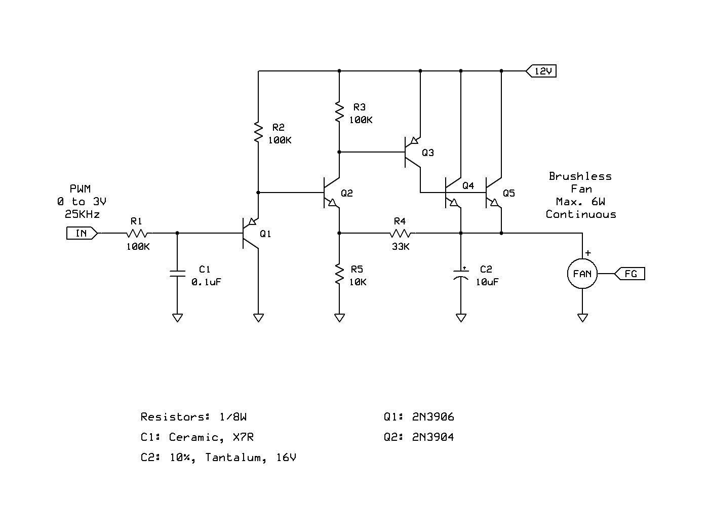

Please help with design of final output configuration and selection of transistors. Want to minimize Vce(sat) and use TO-92 devices. Maximum continuous power will be 6 watts. I am thinking two TO-92 transistors in parallel can handle 6 Watts without heat sinking. Is the Sziklai configuration overkill?

The entire thing looks like overkill
But use a PNP output transistor to feed the motor, feeding the motor from the collector, the losses are far less than way.
You also can't just parallel output transistors, you MUST use current sharing resistors in the emitters, which would be another source of loss.
This circuit does not intentionally saturate the output transistors, as the filtering of C2 prevents the output from following the PWM input waveform. This is probably appropriate, since most brushless DC motors get confused by interrupted (PWM) DC.
Your output stage is a power operational amplifier that attempts to match the voltage across the motor to the ((10k+33k)/(10k)) filtered PWM input, which is 0-3V. That means that the motor voltage in this circuit can try to be 0-(4.3*3)V, or 0-12.9V (bounded by the 12V supply). The remainder is dissipated in the two output transistors which are in the linear mode. If the motor is 6W at 12V, this is 500mA. This is greater than twice the collector rating of the 2N3904, so even if they were OK in parallel, two is not enough. And at half output, if the motor needs say 300mA (it's not likely to be linear) this is 1.8W in the transistors. This is much more than double the rating of the transistor. Again, two is not enough.
You need a larger transistor, preferably a single one so you don't have to equalize emitter currents. I suggest any NPN of the TIP series transistors which you can get easily such as TIP31, with a small clip-on heat sink. The TO-220 package can theoretically handle 2W without a heat sink, but it can burn you or your board.
You may need other components on the collector of Q3 to prevent oscillation in the final stage, and unless you trust your PWM to be a stable 0-3V you might want to amplify and square it.
Apologies, I did not state my objective well. When the PWM duty cycle is 100%, I want the output to be 11.5 volts or more. Duty cycles of less than 30% are not anticipated as most 12 volt fans will stall below 4 volts. A P-channel MOSFET would be preferable as the output transistor. Devices with suitable specifications abound in SMT packages, however a leaded device is required for this build and I've had no success finding one. So I moved on to a BJT output. Between a PNP Darlington and Sziklai pair, which would allow the the output to swing closer to the 12 volt rail?

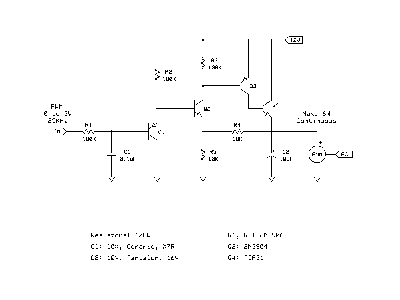

The Sziklai pair can saturate at 0.6V so it beats the PNP Darlington hands down. You just need a beefier output transistor (TIP31 etc) instead of trying to parallel those tiny things.
I bread boarded the circuit with parts on-hand subbing a KSD880-Y for the TIP31. With R4: 29.93K, R5: 9.95K, Vcc: 12.03V and 2.99v at base of Q1 the final output is 11.28V @ 109mA. Thanks for the help mneary and Nigel.

If you want to decrease the top end loss, (like maybe 11.7V instead of 11.28V), you can divide R3, R4, and R5 by a factor of, say, 5. (e.g. 22k, 6.8k, and 2.2k).
Thanks for the follow up. If I am understanding correctly, reducing the values of R3, R4, and R5 will increase the drive current of Q4 and Q5, pushing them further into saturation. will that make Q4 and Q5 run hotter? If so think I'll stick with the original values. For a 1500RPM fan, the difference between 11.3V and 11.7V translates to approximately 100RPM which is negligible for my application.

It wouldn't make much difference (if any) to the voltage loss, because you're still feeding the motor from the emitter of a transistor instead of the collector, so you've got 0.7V more drop than you need have (as you've got the EC drop on the driver, plus the BE drop on the output).
I stand corrected: I thought the Sziklai pair was better than the Darlington. Re-reading the Wikipedia article on the subject, I understand that they are roughly equivalent in saturation characteristics (except for polarity).

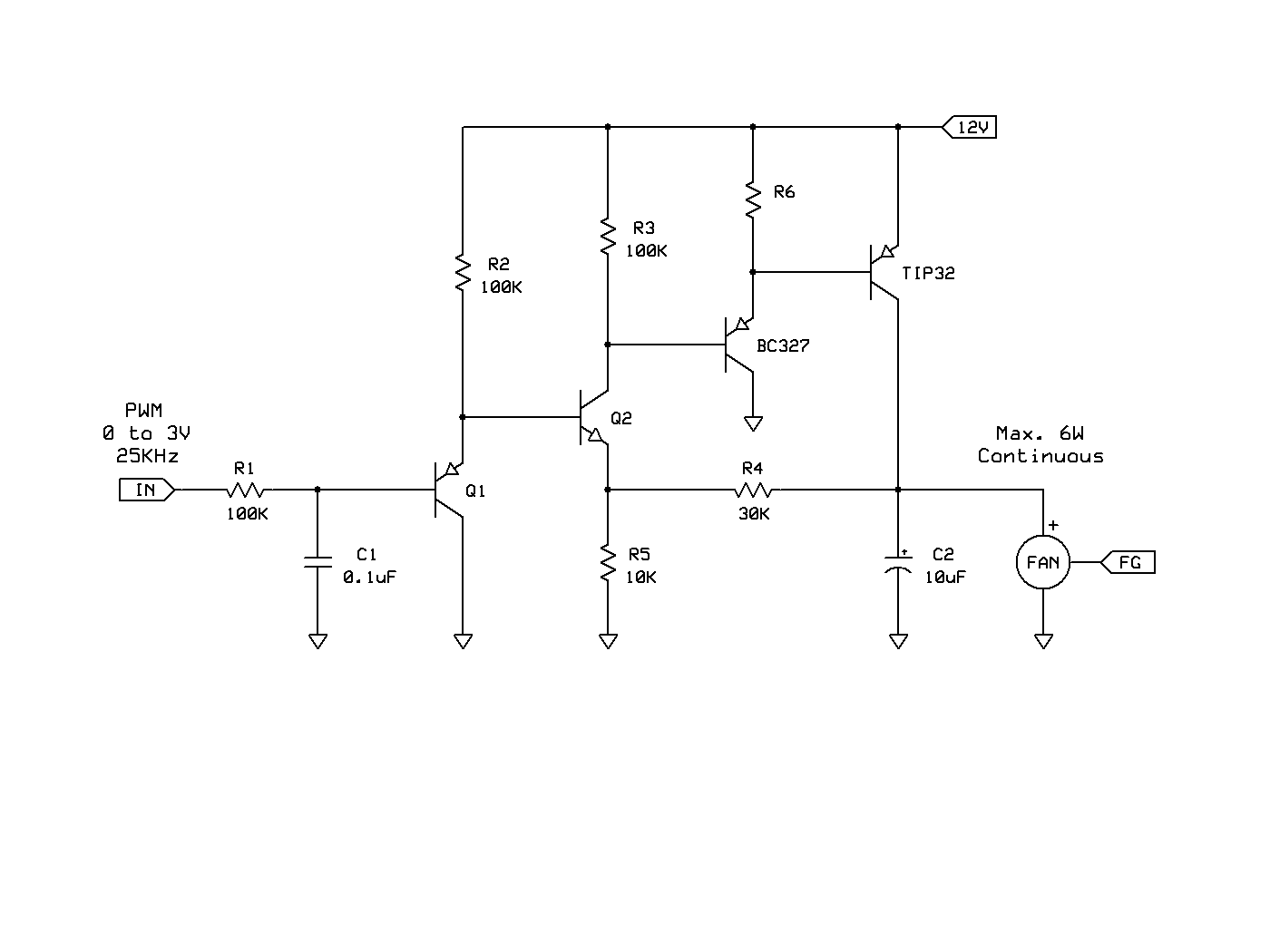

To get the advantage of a single Vce drop using a PNP for the final output, I'll need to drive it with a power gain stage. Can an emitter follower be used get the required current gain? Is there a better configuration to use?

Q3 will blow up as there is nothing to limit the collector current. Q4 will probably be damaged too.
You said that 11.28V from Sziklai pair was good enough. It won't blow up.
Ok, I plead no contest, but instead of fixing the blame can we return to fixing the problem? Would a base resistor on Q3 turn the tide?

No, I would place the current limit in the base of the TIP32 or in the emitter of the BC327.
I think at this low collector current I expect a typical saturated gain of 20 or better, so I would use about 5 mA base current. The base resistor would be about 1.5k (between 1.2k and 1.8k), 1/8 watt or larger. I would make R6 about 10k (really anything between 10k and 100k).
After testing many of the fans in my spares box, it appears the current rating on a brushless fan is the starting current. The actual running current is between 25% and 45% of the rated current depending on the impeller size and bearing construction. From this data, it would be possible to squeak by with two TO-92 transistors in a complementary [Sziklai] or Darlington pair for 3W continuous and 6W starting. Not wishing to test Murphy's Laws, I think the best course would be to use a heat sink.
