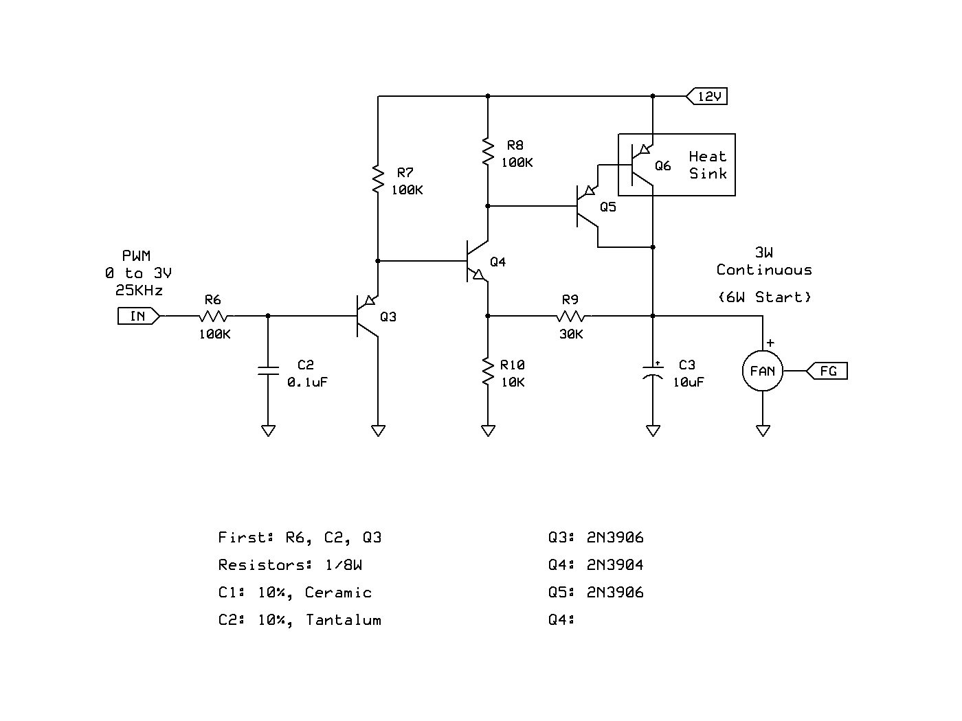

1] Will be using a PNP power transistor for the final output in a TO-247, TO-251, TO-262 or TO-220 package.
2] The low-pass filter at the input and the capacitor on the output will minimize transients and ripple to the fan motor.
3] varying the voltage to a standard 3-wire brushless fan will control the speed of the fan.
4] I have also disassembled a number of brushless fans and everyone of them had a hall sensor and a driver IC. An emerging trend is the use of internal PWM to to enable the output transistors to be integrated on die. If you would like more information Google 'fan motor driver' and explore some of the data sheets from Rohm, Sanyo and Zetex.
