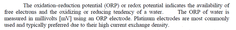

For those, like me, who are wondering, here is a description of what ORP is all about:
spec
