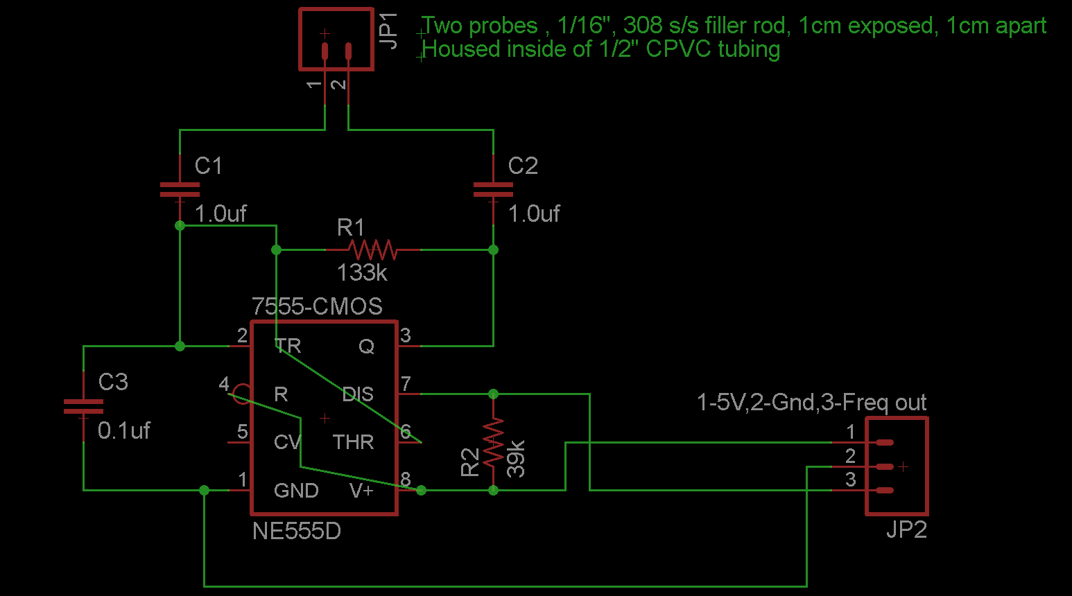

I built one using a PIC with a 7555 AC frequency feed, kinda like a VCO. The PIC counts the freq. via its T0CK input and I calibrate using known solutions. The PIC then interpolates the cal.
Sorry no sketches...all assembly.
Here is the EC VCO circuit.
Hum.. Pretty interesting. So, you don't measure the voltage (conductivity) directly: you analyze the different PWM frequencies. Very interesting! But what about the probes? Other circuits work with a simetrical wave signal (sine or square) driven at +9/-9 or +12/-12v. As some text I've read, it makes the salt ions to "remain at their places", since, they will move just a bit following the electrical current and there will not be any ions accumulation on the probes.
The pulses delivered by the probe happens to be AC due to the capacitive relaxation oscillator of the 555. The conductance determines the freq. of the oscillation. Thus there isn't any net galvanic voltage. The probes don't degrade or develop crud.

Well, the goal is to make it work fine. I intend to make it work using Arduino analog pins as input, so I need 0-5v of range. If it's too hard to do, I might use an I2C solution (or even Serial UART). I was really interested in your solution of frequency analysis, but I actually I don't know how to work with frequency analysis in Arduino (I began studying arduino and electronics just a few months ago, by myself! ;)). However, I'm a good programmer, so that's why I've asked if you had a piece of software: I would analyze the software and discover how to do it...
Mosaic, I think the solution explained in the PDF would be a bit tricky: It would have a lot of ions accumulating in the probe's terminals since it works with a fixed DC level (+5V).
