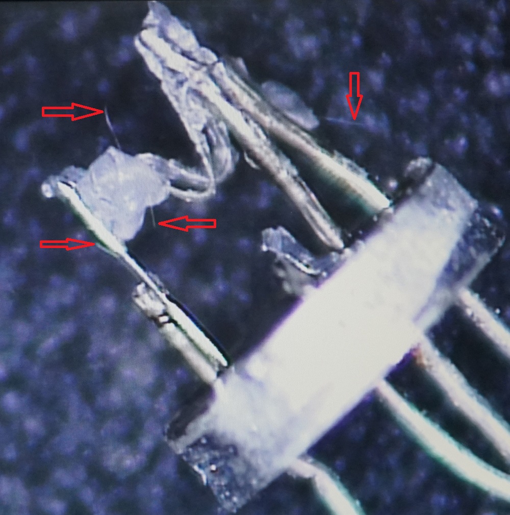

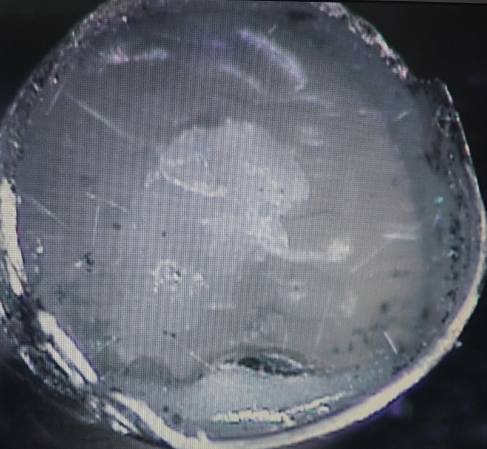

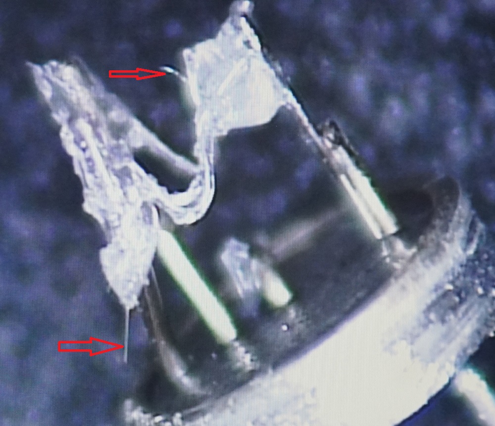

In the last year I repaired an old "Transistor Radio" for a friend, the problem was tin whiskers in one of the IF transistors.
Not only that, I cut open the can of the transistor and now I have the pictures to prove it:
For some reason they liked to fill the little can with some goop which looks like silicone grease, I cannot help but feel that the stuff helped to promote the growth of the tin whiskers.

Or maybe the case of the transistor is made from tin-plated steel. They are magnetic.

Yes, it was simply connected to the metal can - the internal short could appear to either of the other three wires, stopping it working as it grounded either base, collector, or emitter. In my experience simply cutting the wire cured the problem, although as a professional service department we replaced the faulty transistor, while we could still get them, or the later AF12x version.

actually, according to the NASA study on tin whiskers, the goop neither helps or hinders the crystal growth, and the crystals can grow through soft glues (like RTV compound), and can also poke holes in some conformal coating materials (much like certain weeds can poke through asphalt walkways). they found that as little as 2% lead in solder will inhibit crystal growth.
