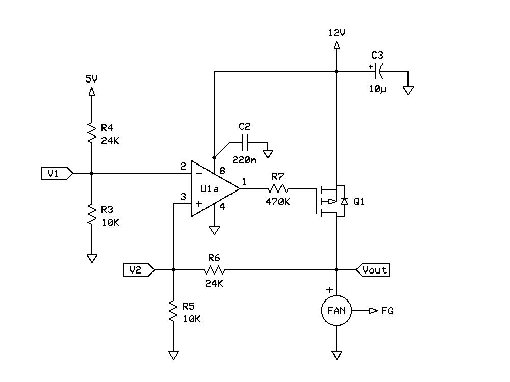

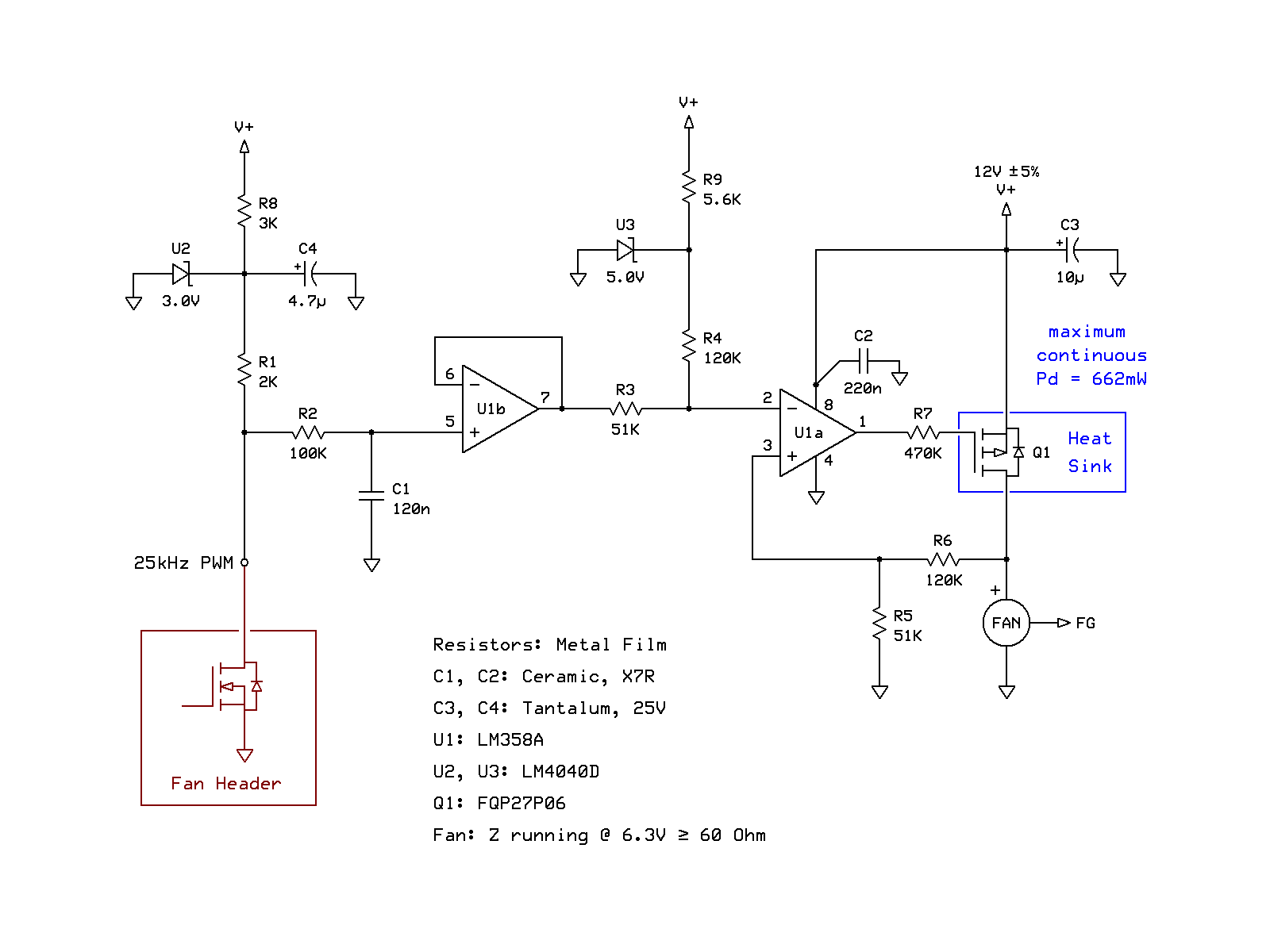

Would like help optimizing this circuit. I want the final output to swing from 5V to the positive rail. The gate resistor (R7) is purposely large to limit the output slew. My question involves the input dividers: R3, R4 and R5, R6. As the impedance of R3, R4 increases, the offset from current into the buffer amp decreases, but at some point the input bias current of the error amp will be an issue. Is 170K a reasonable compromise? Then again, without using a negative bias voltage, is this the best configuration to achieve the 5V to positive rail output swing?

You might need some frequency compensation because Q1 is a common source amplfier in the feedback loop of an op-amp and will give more gain and more phase shift, there again, R7 and the gate capacitance is probably already doing that.
The PMM originates from a 4-wire fan header on a personal computer motherboard, an open drain output with a maximum pull-up of 3.3 volts that can sink up to 5mA. I am using an after market heat sink on the CPU so the boxed INTEL fan is useless. Also because it is the CPU, I need to insure that the fan will not stall, hence the minimum 5V output requirement.
I want to be able to use the FG signal (tachometer) of the controlled 3-wire brushless fan which is 2 pulses per revolution, pull-down to ground. At low duty cycles the the PWM on time is less than the FG signal on time, so i would need to stretch or average the FG signal to make it usable.
It has also been suggested that I use a PIC. The circuit would be easy to build, but the last time I did any programing it was in FORTRAN, so I would need copious help to write the necessary code.
What I'm looking for is something that has a small physical footprint and can be knocked out on perf-board with out too much fuss. I would be just as happy with a discrete component circuit, but have been unable to find any design information to pursue that type of build.

I want to minimize the voltage drop across the voltage follower output without causing excessive error in the output amp input.

To ander the orginal question: the drop-out voltage equal to the MOSFET's channel resistance multiplied by the current taken by the fan. If you use a low resistance MOSFET should make the loss negligable. You could use a N-channel logic MOSFET, but you'll need to power the op-amp from a higher voltage than 12V which is a pain but could easily be done with a voltage doubler.

It varies, some 3-wire brushless fans will operate satisfactorily with as little as 2.5V, but 5v is appropriate for the fan I'll be using, it stalls at 4.25V.
The FQP27P06 has an Rds of 100m Ohm, maximum continuous fan current would be 12.6V / 60 ohm = 210mA.
Are we talking about the same thing? My question is about the values of R3, R4, R5 and R6.

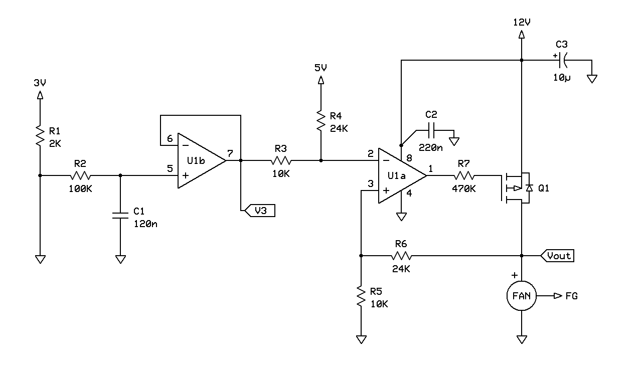

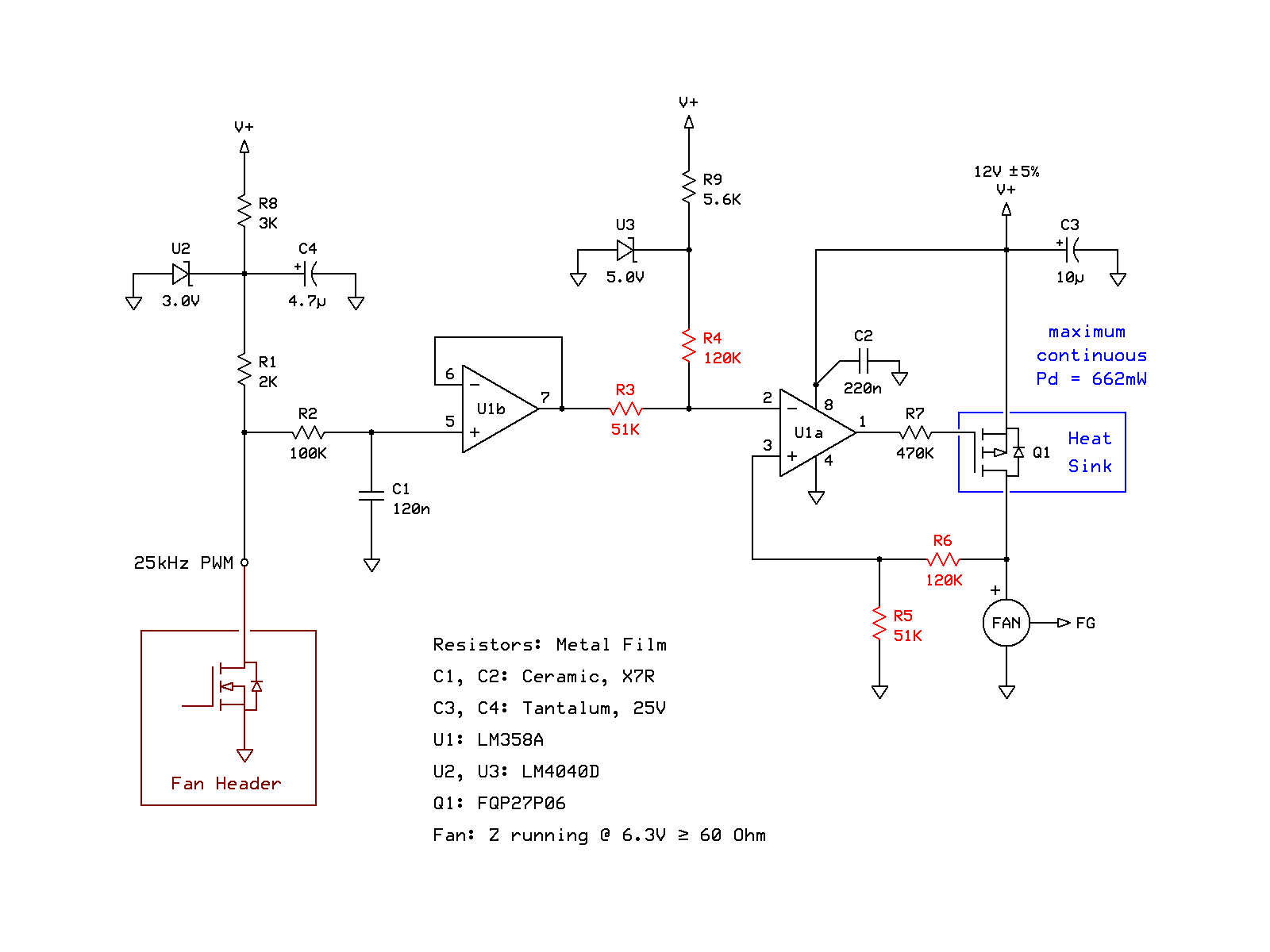

I bread-boarded the amp section first to check if the heat sink was large enough. Vout was 5.07V, V1 = 1.46V and V2 = 1.48V. Everything as expected. When I added the low-pass section and grounded the input, Vout changed to 6.58V, V1 = 1.91V, V2 = 1.92V so I measured V3 and found 640mV. Not what I expected. If I maintain the ratio and increase the total resistance of R3/R4 and R5/R6 the offset (V3) gets smaller and Vout gets closer to 5V. What is a reasonable upper limit for the total impedance of each divider pair (R3, R4 and R5, R6) in this particular circuit?

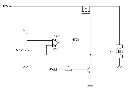

Here's an idea for a simpler circuit.
The output is 5V and will increase to 12V when the PWM input goes high.

Slick circuit Hero.

I've notice one potential pitfall.
The 470k resistor might prevent the PWM from working up to 25kHZ.
The problem is the the time required to recharge the gate voltage when the bjt turns off. This might be negated to some extent by the op-amp output suddenly going as high as it can when the bjt is turned off.
If it's a problem the 470k resistor should be reduced. If it then oscillates a frequency compensation capacitor could be added to the op-amp.
I think this is a test and see situation unless he had SPICE models for all the components he wants to use.
