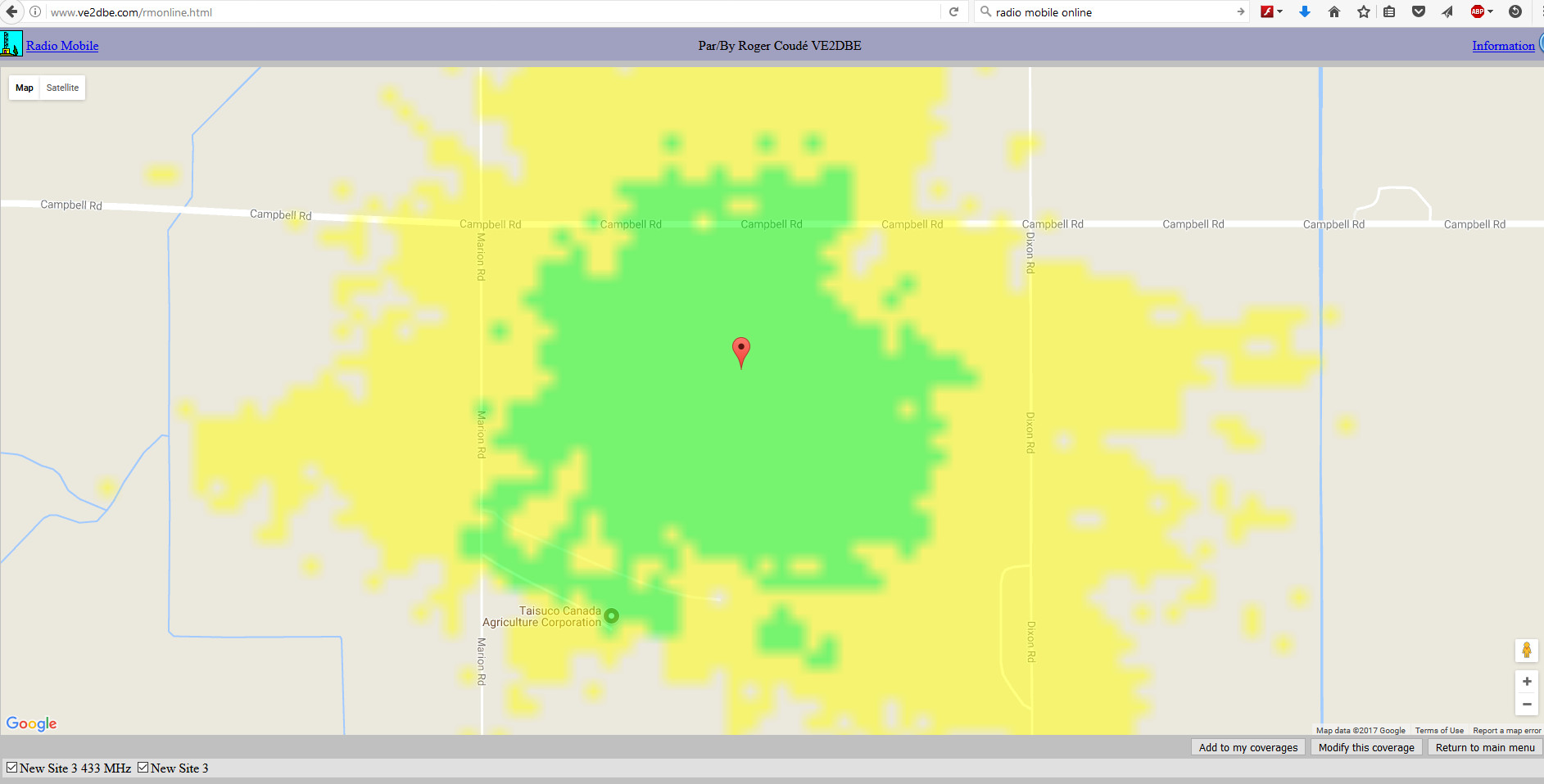

Let's use another tool to predict range. Here is a plot of coverage when both ends of the link are at 1m above ground. This map shows the unit in a flat farm field with nothing growing on it. The distance between the two vertical roads is 1 km and the distance from the transmitter to either vertical road is about 500m. The yellow area is the coverage at -110 dBm while the green area is coverage at -100 dBm. The antenna gains are -5 dBi and the height above ground is 1 m. It seems to show that 300m is certainly possible. This assumes the unit is placed perfectly vertical on a stand. This is still too idealized to reflect reality. Oftentimes the units are not oriented correctly for the best range, there are buildings and/or walls between them and there are numerous reflections creating a strong multipath environment. If the unit is being held by a person's hand, the range will be much worse because the hand and body will absorb some of the power. All of these practical realities will reduce the range at which we are always satisfied with reliable communications. So it is probably not reasonable to expect 300m range unless you take considerable care in locating and orienting both units.
The best way to increase range is to increase the height of the unit off the ground.
