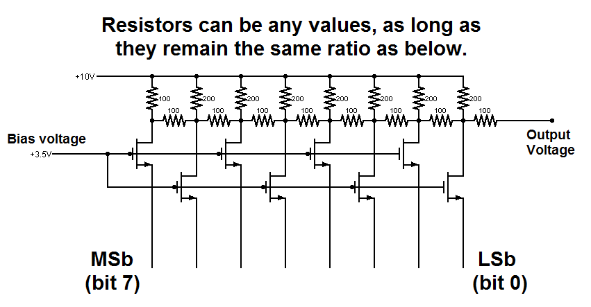

@DAC
An R2R ladder is an easy DAC to build on an individual parts basis. here is a schematic of that...
And here is a simulation... *CLICK-ME*
Notes:
(1)The MOSFET's in the falstad simulator have the symbol backwards from the accepted standard. The arrow is supposed to point toward the current it is blocking. This turns away a lot of pro circuit designers from the otherwise useful sim as it's totally wrong. Keep this in mind when you are using it, virtually every one else will use the right convention, with arrow pointing toward the most positive voltage.
(2)The MOSFET's are just used here as constant current sources, with a bias voltage applied across all their gates uniformly. In real life, the voltage will almost certainly be different than shown, and will probably be VERY sensitive.
(3)The square-wave sources at the bottom are just a cheater way to simulate an 8bit binary counter in the falstad sim, it is counting down LSb on the left, using inverted logic. It may look odd but under a microscope it works exactly as it should.
(4)The voltage can be adjusted at the top left. There is no particular reason that it is 10V in the sim. That's just what ended up happening. More importantly, the output voltage will never drop below ~2 volts. I have it adjusted this way because there is distortion below this point. This will scale with the input voltage, so be careful when adjusting it. Better current sources will help with this, but I designed this DAC to be "simple".

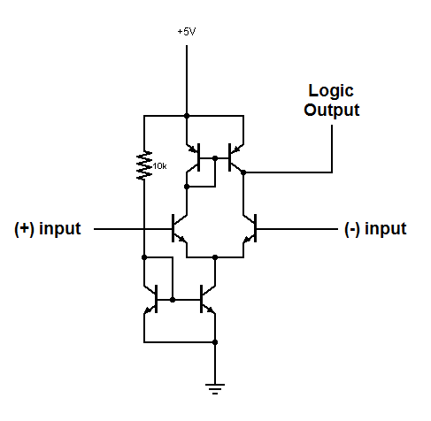

@Comparitor.
To do an SAR ADC, you will need a comparator. Here is a simple schematic for that using BJT's...
And here is a simulation... *CLICK ME*
Notes:
(1)The only resistor in that circuit can let you adjust the sensitivity verses the power the circuit consumes. Lower resistance means more power, higher means less sensitive.
(2)You can easily make the input voltage 10 volts if you want. the output will be 10 volts if you do this though. The two inputs don't care.
(3)You should have resistors on the two inputs in a real circuit. That is just the base simulation of the over all concept for the part.
(4) This circuit is the triangle thing in the Wikipedia articles block diagram. But do not confuse it with an Operational amplifier, which has the exact same symbol.

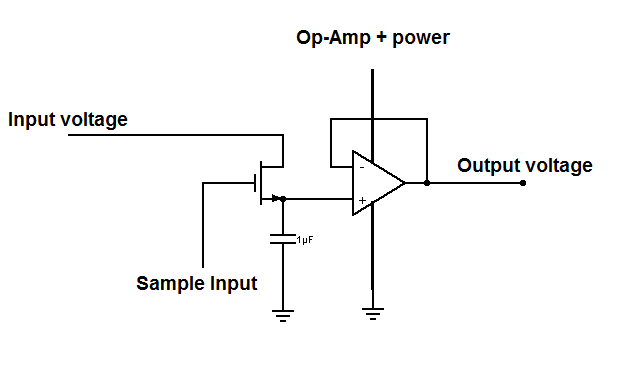

@Sample and hold.
A sample and hold circuit is simply a switch to a capacitor, fed into an operational amplifier. There are hundreds of schematics on the net for this, and I will provide one here. I will show the circuit with the Op-Amp in it's usual block form, it is up to you to understand what that means and obtain one yourself.
In any case, here is a sample and hold schematic...
and here is a simulation... *CLICK ME*
Notes:
(1)The triangle thing is an Operational Amp, NOT a comparator.
(2)The input voltage can be adjusted with the slider on the right of the sim, cleverly labeled "Voltage"
(3) The power wires are not shown in the simulation, and in most schematics of op-amps and comps. This is because it is globally understood that such things need power.
